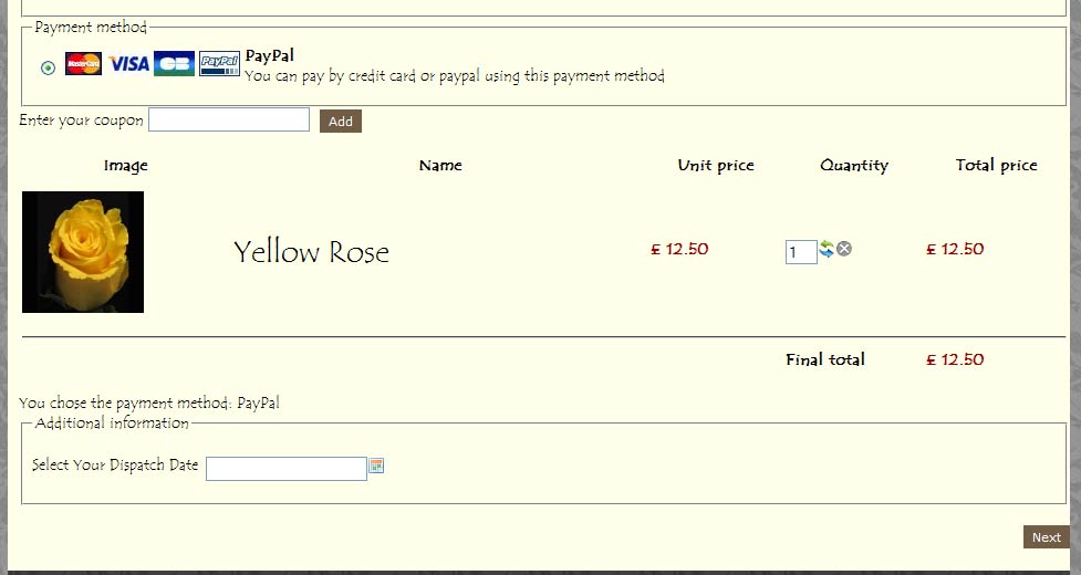

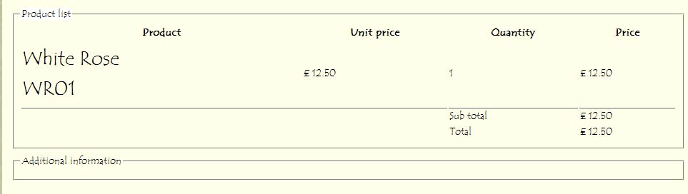

I have created a custom date field using JQuery in Table Order. It appears on the site within the order process under additional information and is selectable. However it does not appear in the confirmation email or within customers control panel. The label itself is in the email but not in the customer account panel. I have attached 2 screenshots.
Advice greatly appreciated as I may be missing something
Dave B)

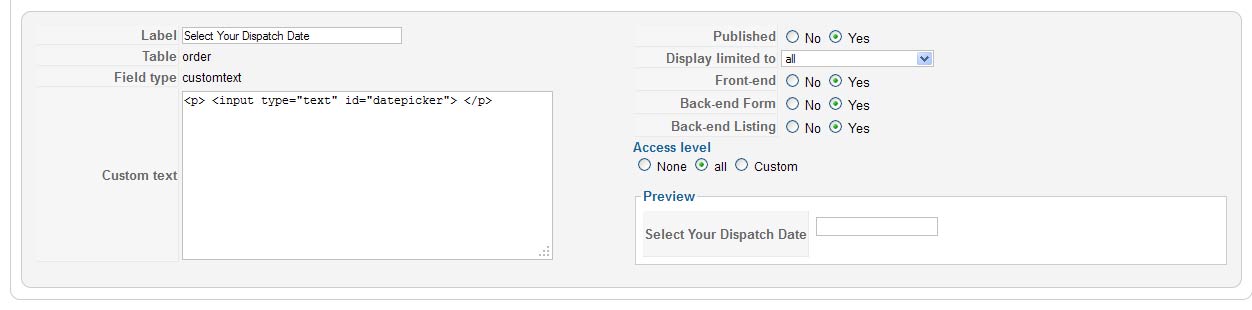

14 years 3 months ago #50988
Hi Nicolas
attached is the screenshot as requested.
Dave B)
  • Posts: 86177
  • Thank you received: 14212
14 years 3 months ago #51105
Please delete that custom field and create a similar one, but of the type "date". That way it will work.
What you did cannot possibly work since customtext custom fields are plain and simply ignored by HikaShop when saving the data.
