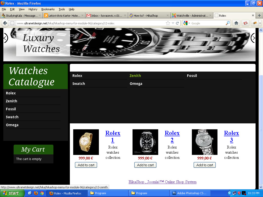

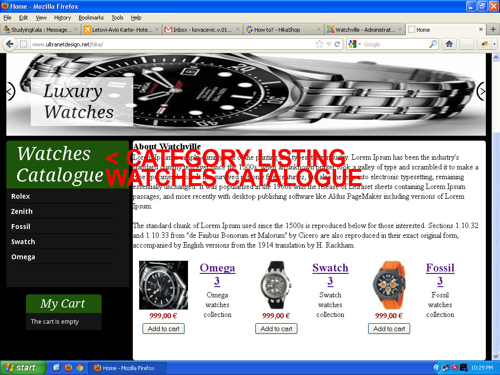

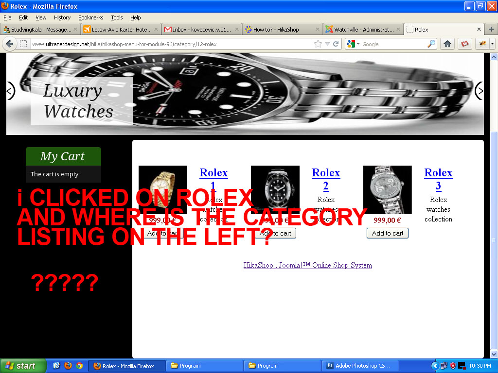

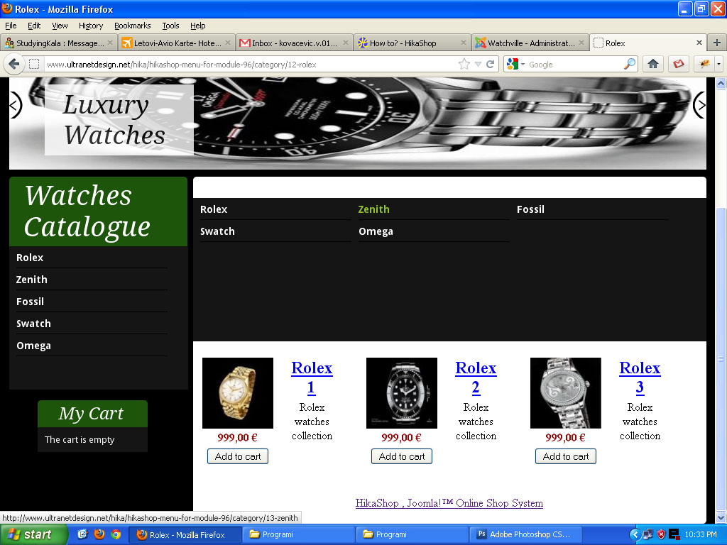

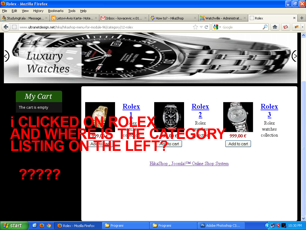

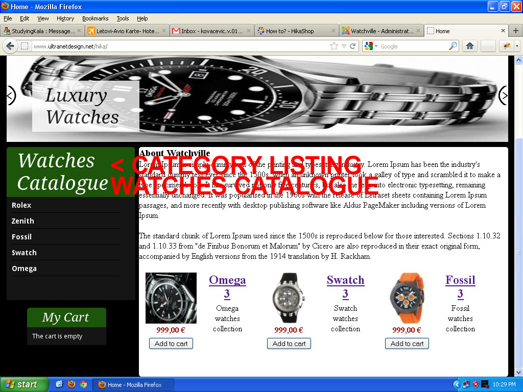

14 years 3 months ago #51384
If you simply clicked on a category on the site you'd see what happens. I guess it's easier that I upload 4 pictures than that you click once on a link.
SYNC ON:
SYNC OFF:
As you can see, with sync on (img1, img2), the category listing menu disappears when I click on a category, e.g. swatch, even though it's set to display on every page in the same position, as i already simply said.
If sync is set to OFF, the cat listing stays there when you click on a category, but I also get a different style listing of the categories in the main content area (img 3).
Last edit: 14 years 3 months ago by Dzumla.
  • Posts: 86100
  • Thank you received: 14202
14 years 3 months ago #51503
Thank you for the screenshots.
Now I understand what you're talking about. I wasn't able to see the pages with the synch off since you have it on and that the access you provided to your backend doesn't work anymore so I can't turn it off... So it was hard to see what it was.
Could you keept he synch off so that we can look at the HTML of the two instances of the module ?

  • Posts: 86100
14 years 3 months ago #51569
Ok, now I get it.
In your menu with the id 135, you have assignated two modules. The category listing module and the products listing module. Only the second one should be there
Go in the menu System->Content menus and edit the menu with the id 135. There, in the associated modules option, disable the module with the id 96, save the options and it should then not display the categories on the main area.

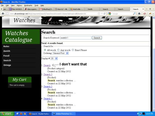

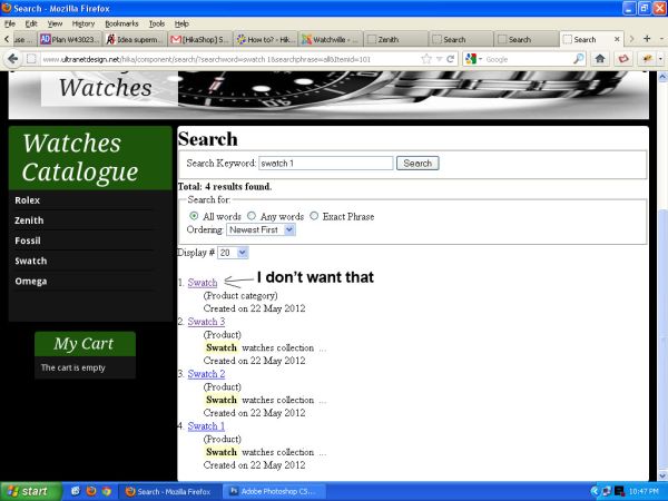

One more thing:
If I search for swatch in the search box, I get the products nicely, but I also get a 'product category' result, and if you click on it it links to a blank page.
Can I make the search so it only searches products?
Also, if I click on a search result it opens in a new page, how do I make it open in the same page?
  • Posts: 86100
14 years 3 months ago #51608
Disable the hikashop category search plugin and in the hikashop product search plugin, toggle the option for displaying products in a new window. You can do that via the plugins manager of Joomla.
