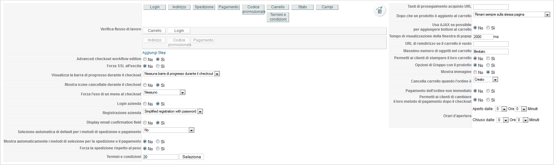

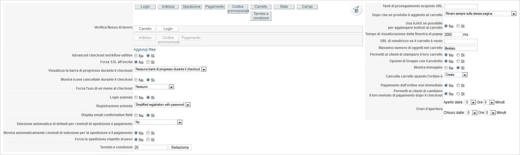

It's not a bug. It's just that you turned off the option "Auto submit shipping and payment methods selection" in the Checkout tab of the configuration, so you have to push next twice:
once to validate the shipping and payment selection and a second time to validate the order.

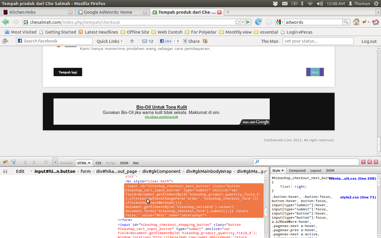

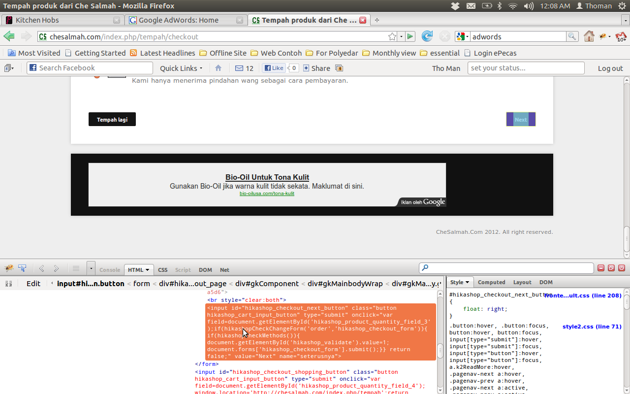

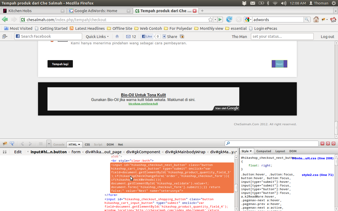

this is a firebug snapshot
I have edited the frontend for the right template. when i change the 'value' with firebug then its changing the 'name will not do anything
Every day is a good day.
  • Posts: 86177
  • Thank you received: 14212
14 years 3 months ago #52339
I don't see the link of that screenshot or firebug with what you want to do.
You can't edit the text with firebug. You need to edit it via the menu Display->Views in the backend.

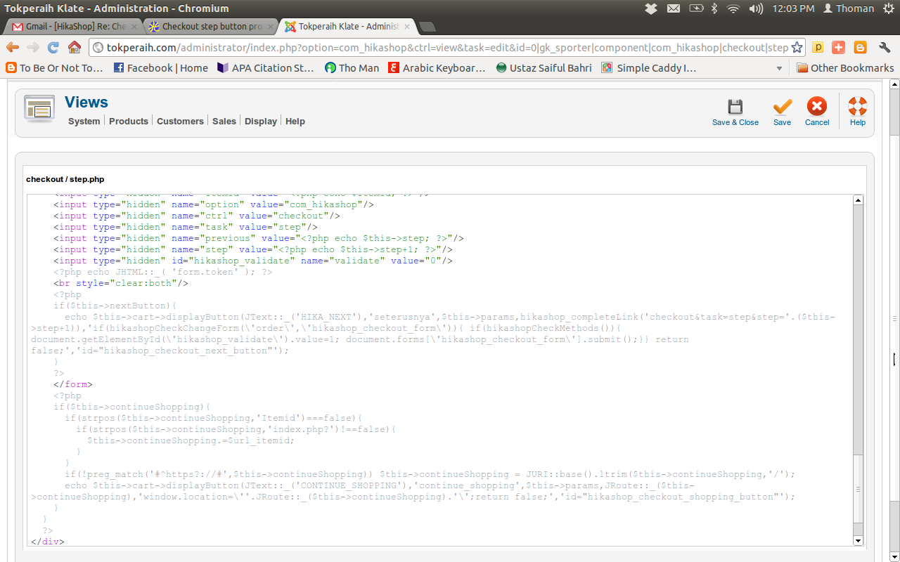

  • Posts: 86177
14 years 3 months ago #52708

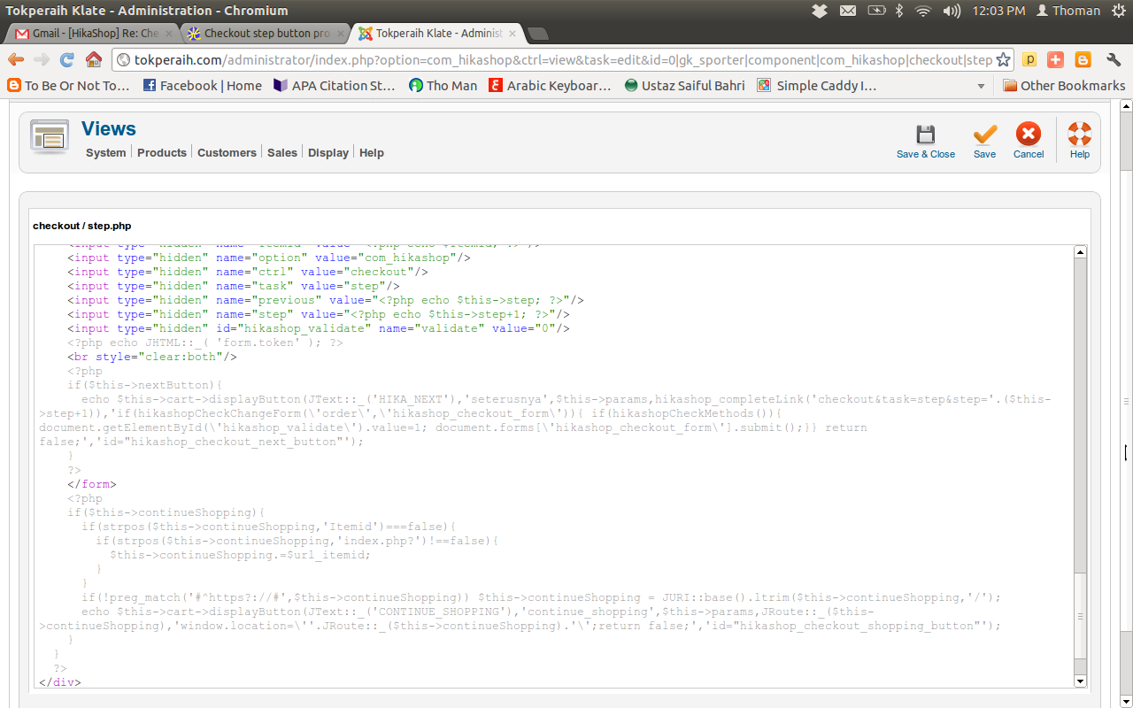

Please do a screenshot of the modification you made in the back end of HikaShop.
  • Posts: 26
14 years 3 months ago #52721
this the snapshot Display>views>step
