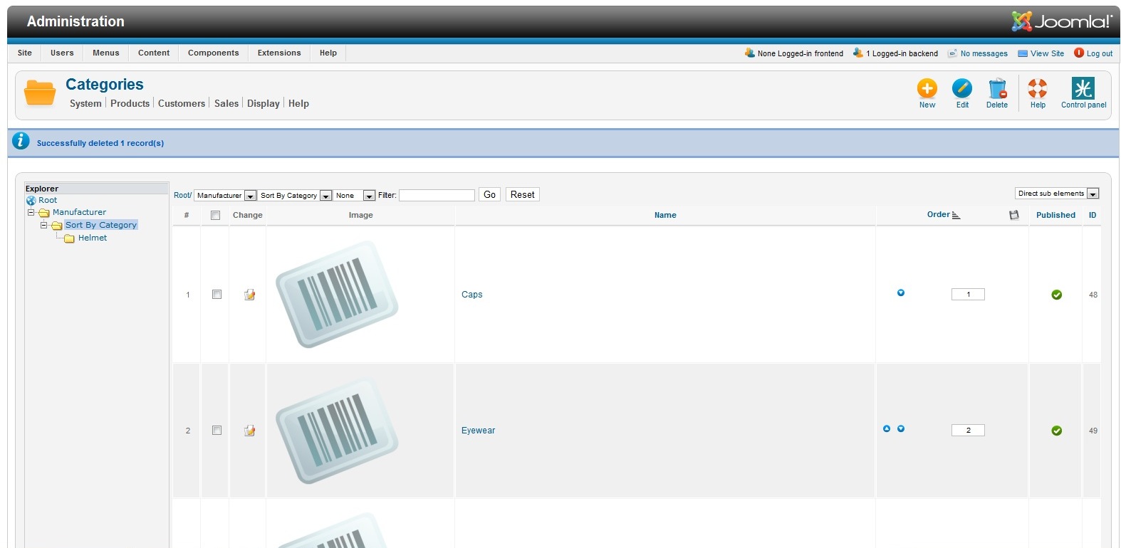

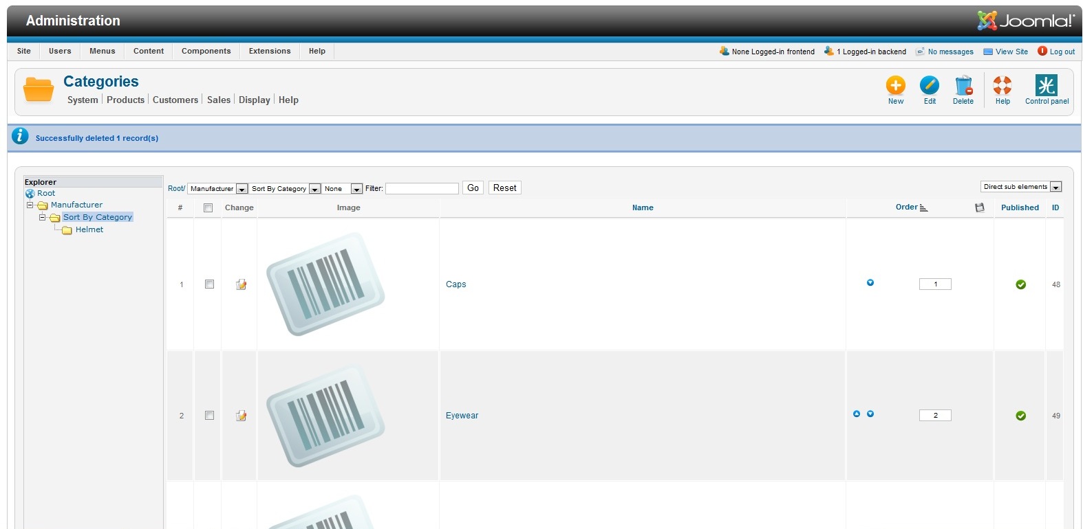

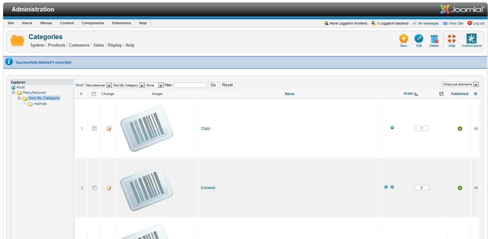

14 years 3 months ago #51774
nicolas, please take a look at this. i have 14 sub-categories under this category. but in the backend, the 14 items are not even showing in the left hand side under the explorer. is this right?

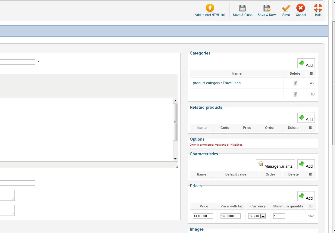

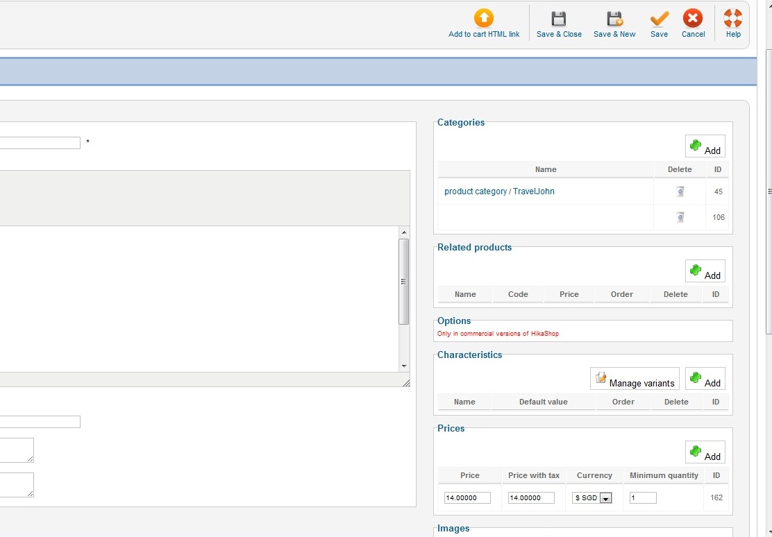

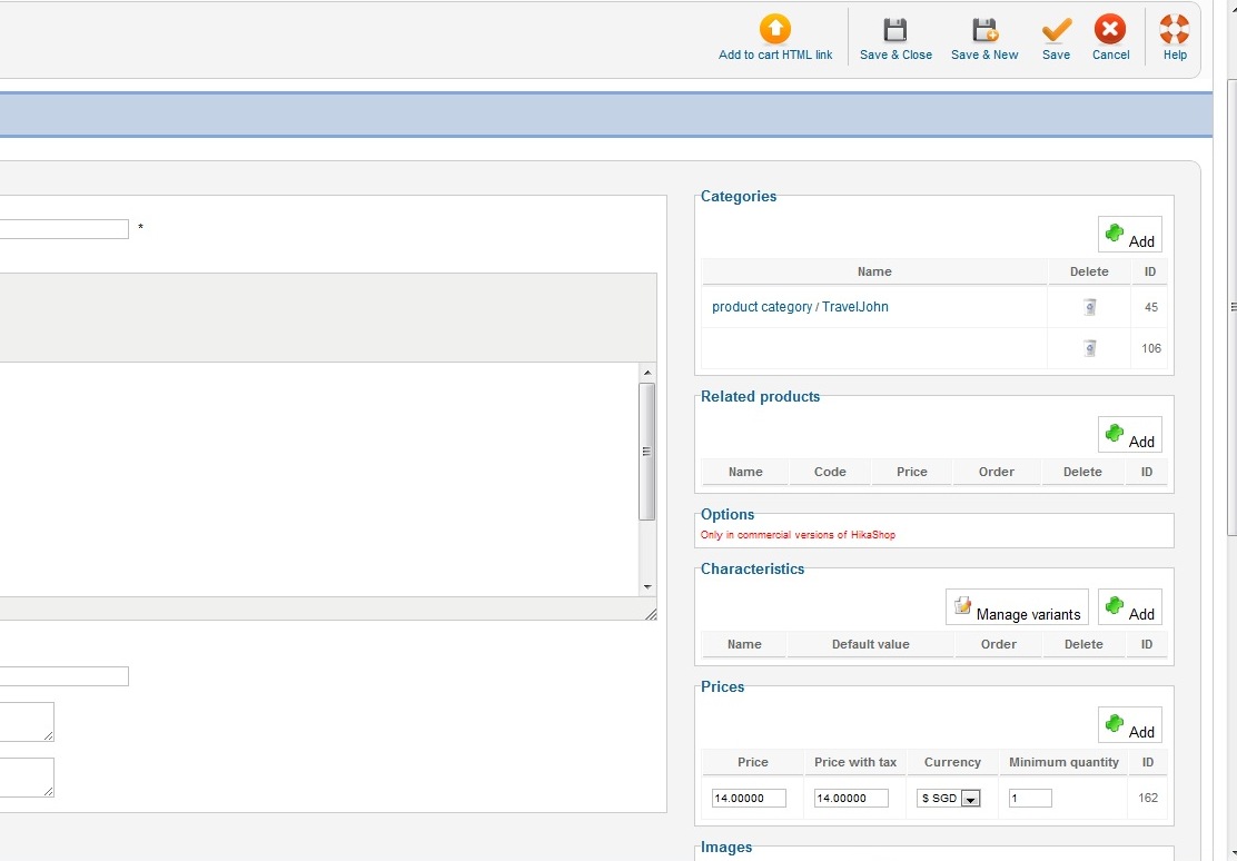

14 years 3 months ago #51856
nicolas, i have attached another screenshot here to show you the problem. please take a look at what happens when i try to assign a product to one of the problematic category. the name of the category with id 106 does not appear. after saving the product, the front end does not display the product. however in the properly working "TravelJohn" category, it is appearing fine. please help!

14 years 3 months ago #51861
If a link between a category and a product cannot be made, the product won't appear in the back end nor on the front end.
I can see in one of your screenshots that you add your categories under the manufacturer "main" category.
That's maybe why you don't get the links added.
Why don't you add your categories under the "product category" category as it is the case by default ?
Also, you can try to turn on the "debug mode" option of the joomla configuration. You might get an error when adding you products/categories if there is a problem with the MySQL database. We would give us information on what is happening.
