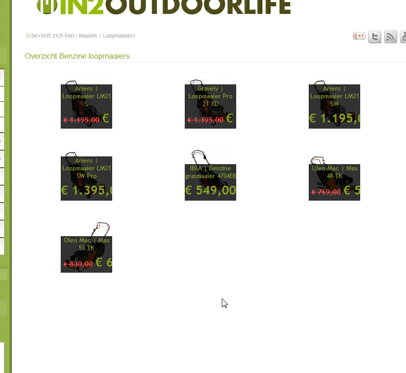

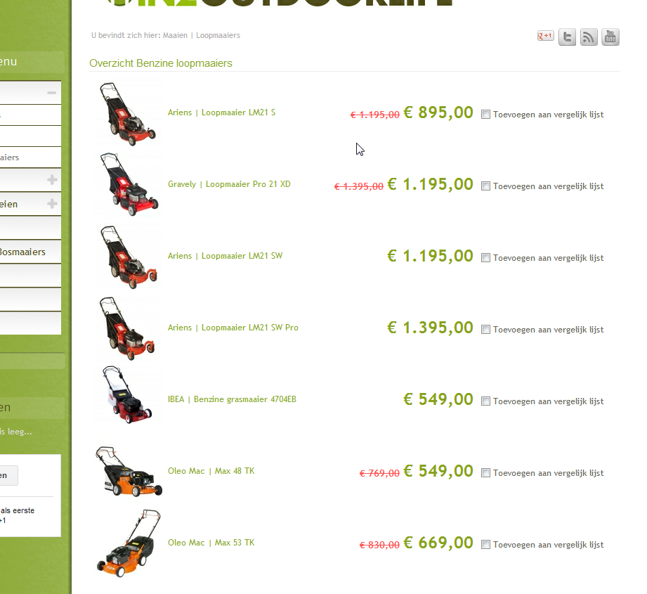

Hello all,
when I use my menu, I get a nice layout of my chosen products. However when I am using the breadcrump I get some default view (with faded products). I can't find out where to handle the menu's/presentations that are created when using the breadcrump.
Any idea?
Here you see the result from the menu (which is the good one)
And here you see the result with the breadcrump

  • Posts: 32
14 years 3 months ago #52307
Yes ofcourse...
Here is the normal one, as it should be through the menu (on the left)
www.in2outdoorlife.nl/maaien/loopmaaier/...aaiers-professioneel
And here is the one, created using the breadcrumb
www.in2outdoorlife.nl/maaien/categorie/2...aaiers-professioneel
