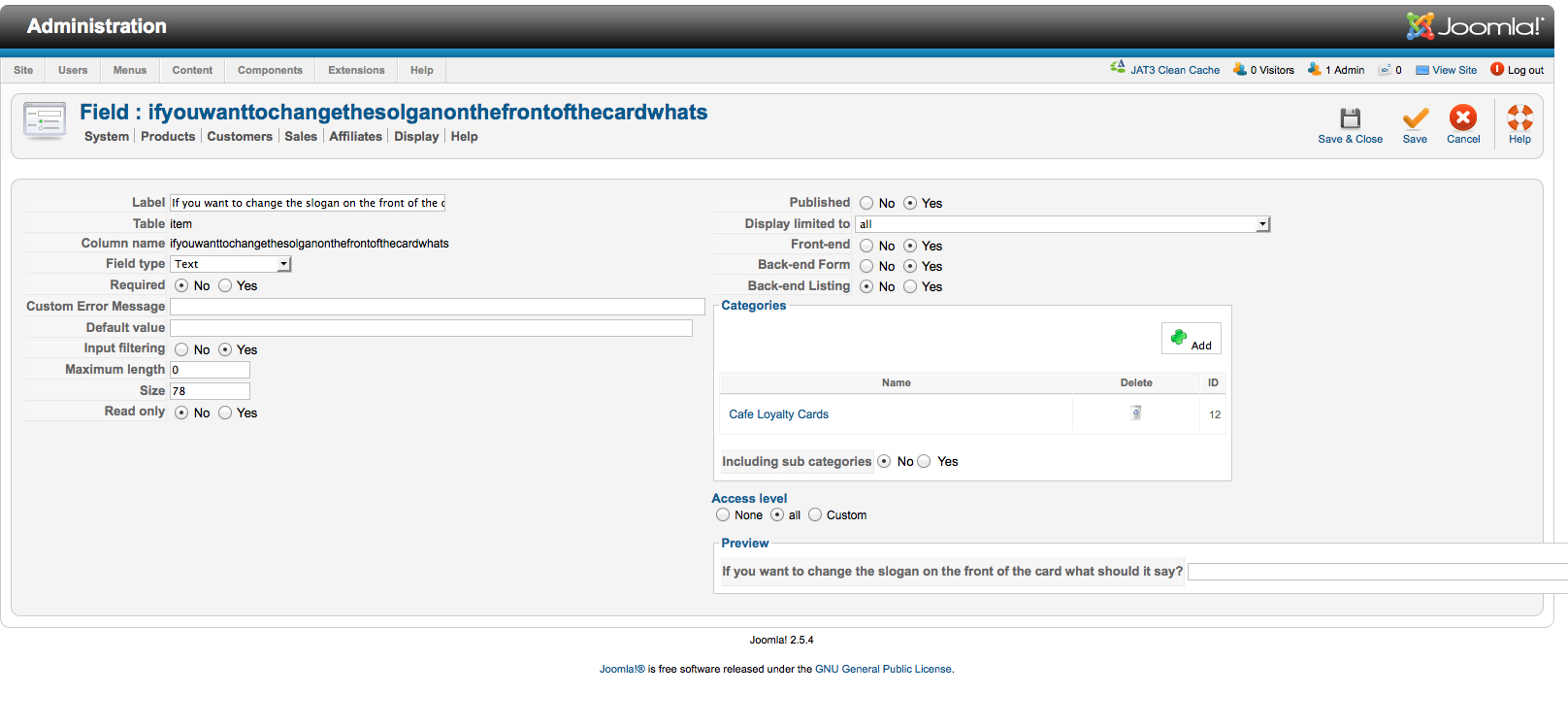

Okay its definitely the custom fields that are causing the problem. Unpublished them and it works fine.
I have checked the settings against the similar "address" custom fields and everything looks correct.... help!

JDatabaseMySQL::query: 1054 - Unknown column 'ifyouwanttochangethesolganonthefrontofthecardwhats' in 'field list' SQL=INSERT INTO l9ehd_hikashop_cart_product (cart_id,cart_product_modified,product_id,cart_product_parent_id,cart_product_quantity,cart_product_option_parent_id,`ifyouwanttochangethesolganonthefrontofthecardwhats`,`whatisyourbusinessname`,`whatisyourbusinessaddress`,`openinghours`,`whichdrinkshouldbefree`) VALUES (78,1338567573,1,0,250,0,'gfdfhdfh','gfhfgj','fjgghdfhg','dsggddfsds','8th')
