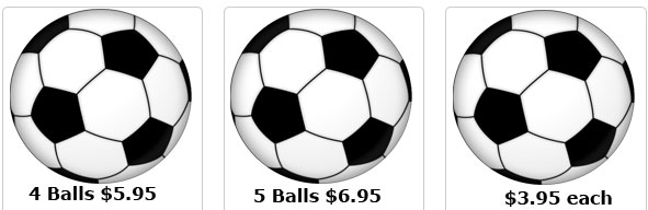

I cannot figure out how to do this. I attached a pic showing what I'm trying to do. The 3 pricing that I have in the example are:
4 Balls $5.95
5 Balls $6.95
$3.95 each
Thanks!!

With the method I explained, you will get only one product and the prices will all be displayed on the product page and based on the quantity added to the cart, the corresponding price will be used.
