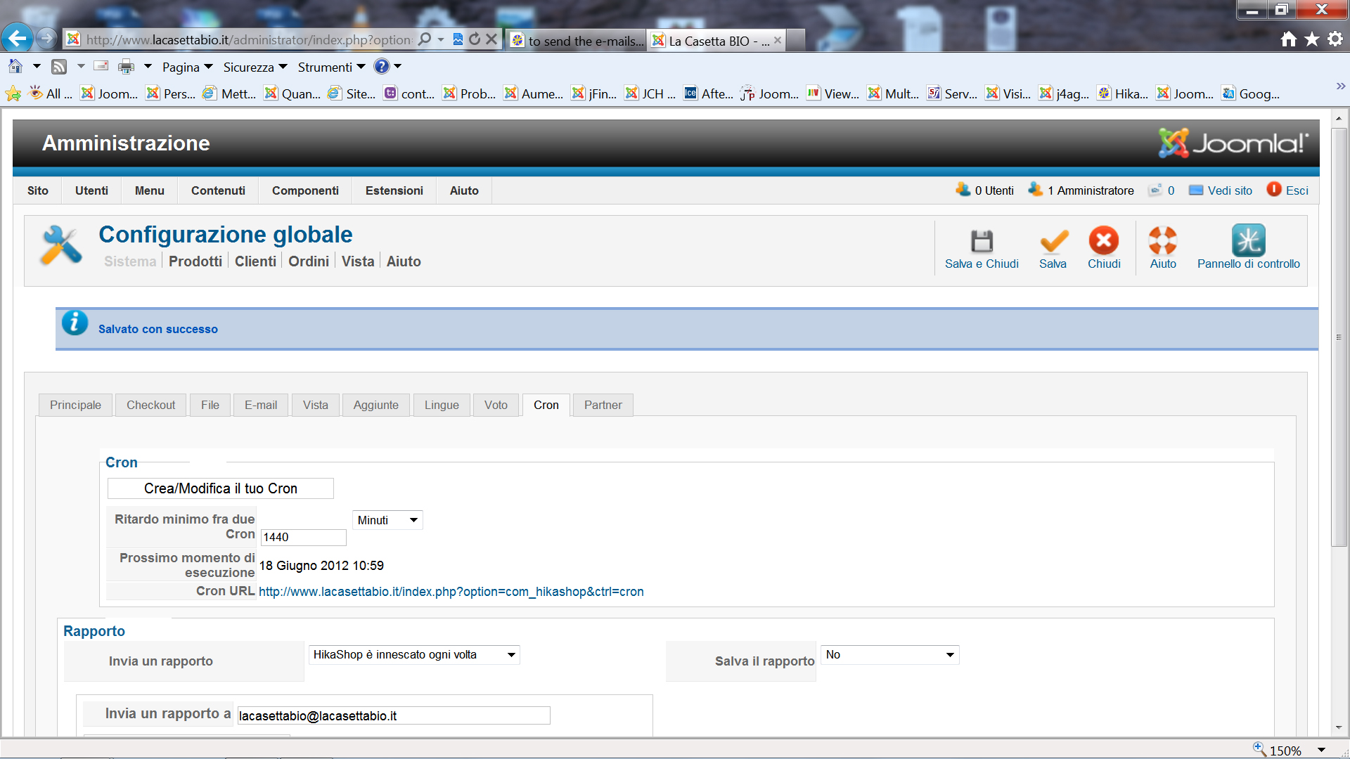

Can you do a screenshot of your cron tab in the configuration ?
  • Posts: 719
14 years 3 months ago #53167
Here you are!
my site with Hikashop
www.lacasettabio.it
Last edit: 14 years 3 months ago by lacasetta.
  • Posts: 86176
  • Thank you received: 14211
14 years 3 months ago #53248
The cron should be triggered based on the "Next Run time". Just after changing it, you will still have the next cron triggered. Only then will it set the next one at +1day. Isn't that the case on your end?
  • Posts: 719
14 years 3 months ago #53269
I set the delay time at 1440 minutes over one day and 8 hours ago.
It still sends me one mail every one hour.
www.lacasettabio.it
  • Posts: 86176
14 years 3 months ago #53556
I've changed the frequency on our end. Let me know how that goes.
