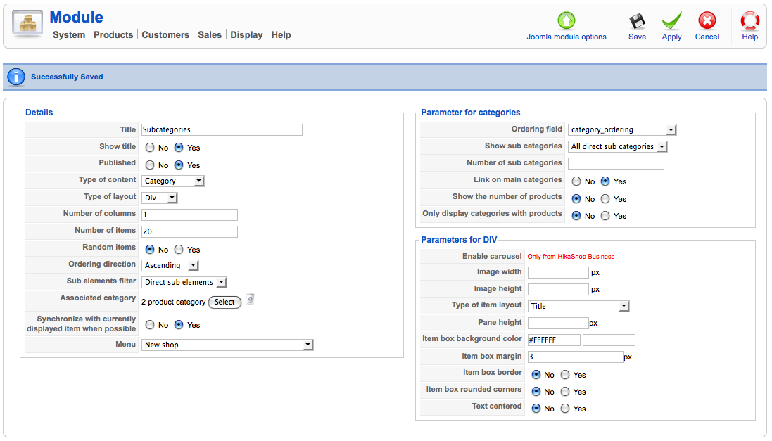

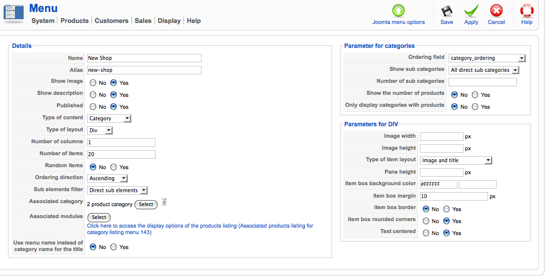

Here are two screenshots of the options we set (menu and module):
The urls generated by the categories inside the content are:
xxxxxxx.com/de/new-shop/category/14-storia
And those generated by the module:
xxxxxxx.com//component/hikashop/category/14-storia
Thanks and best regards!

14 years 3 months ago #52554
Please check the joomla options of your menu item. It needs to be public and in a valid menu. The menu item also need to be published. You can check all that via the joomla menu manager.
