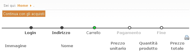

The button is now on the top as where I want it to be:
The problem is that when I push it from any stage of the checkout process (login excluded) I'm redirected to the address page and not to the shop.
