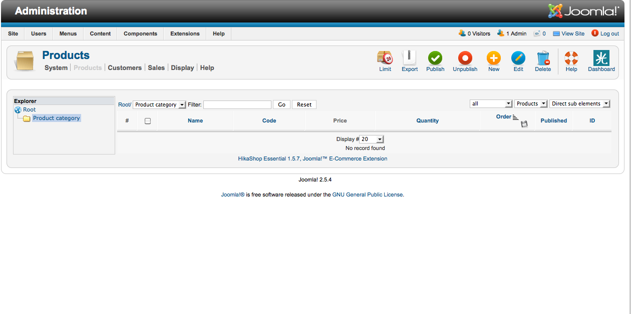

  • Posts: 13
14 years 3 months ago #53341
Sorry about the delay.
No new categories are added and I cannot see any products on the front or back end.
Attached screen of what it looks like after the sheet is added.
Products DO get added to the hikashop_product table in the database each time.
