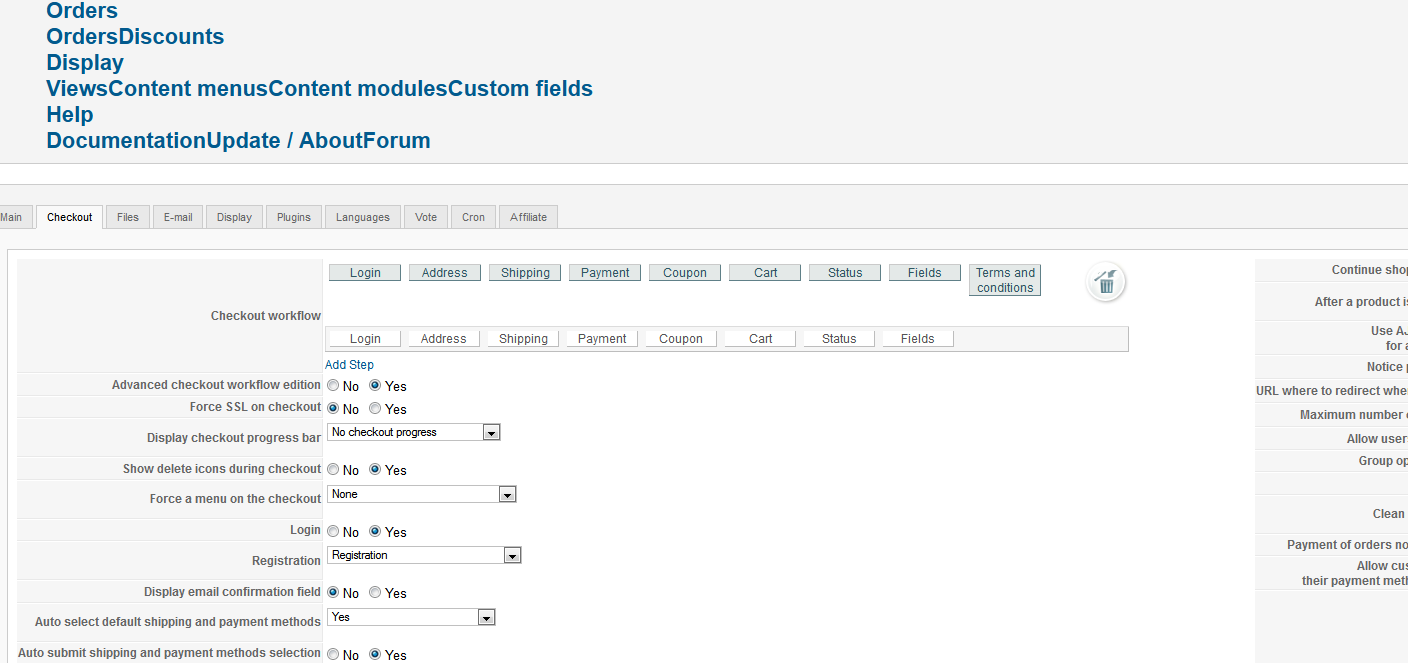

It looks as though it should be really simple, but I'm having huge problems with the checkout workflow. I see how it's supposed to work (I think), and that 'end' has to be a separate step, but I can't find a way of setting 'end' as a step at all. Please see attached screenshot, showing the error message that I've been getting. I have tried to set 'Advanced checkout workflow edition' to 'no', so that maybe I can see more clearly what is going on, but I just get the same error message and it reverts to 'yes'.

OK - I have partly solved this myself, in that I've found that I can turn off 'Advanced checkout workflow edition' in Internet Explorer (I was using Firefox), and I don't get the error message there. I have also been able to change other configuration settings in IE, when in Firefox anything I attempted just got me back to the same error message and changes were not saved.
