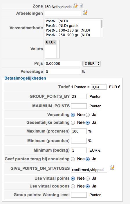

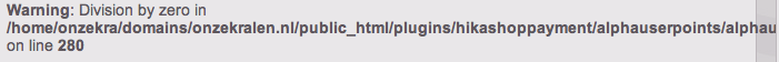

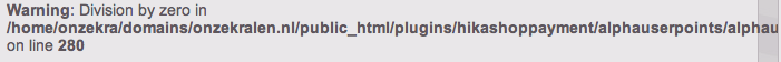

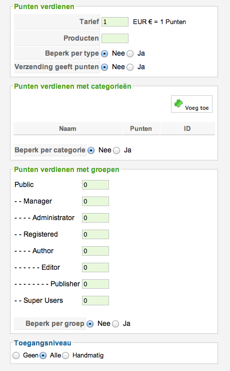

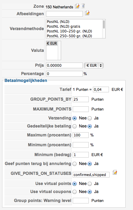

Hi again :unsure:
I wanted to start using alphauserpoints but i run into an error and i don't know why.
I have added some print screens from my settings.

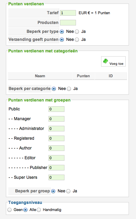

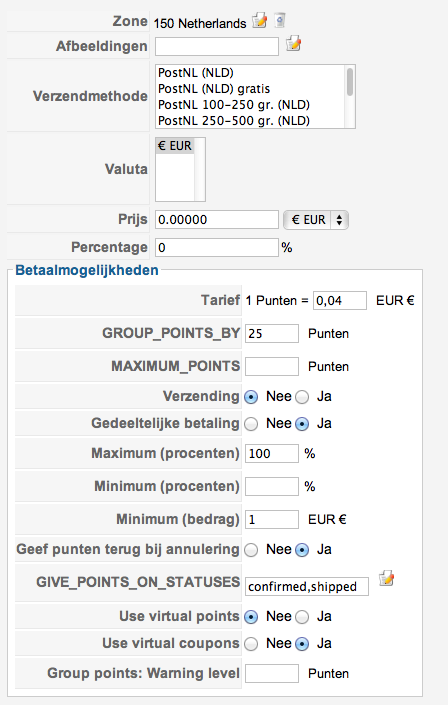

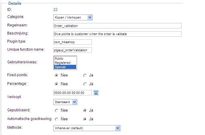

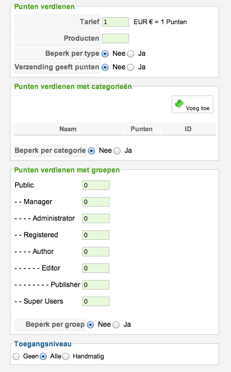

My idea is to have 1 point for every euro spent and i want to give 1 euro discount per 25 points.
I hope you can help me!
  • Posts: 86177
  • Thank you received: 14212
14 years 3 months ago #52588
Please remove the '25' in the GROUP_POINTS option and try again.
  • Posts: 56
14 years 3 months ago #52602
Ok i did that and the error seems to be gone now.

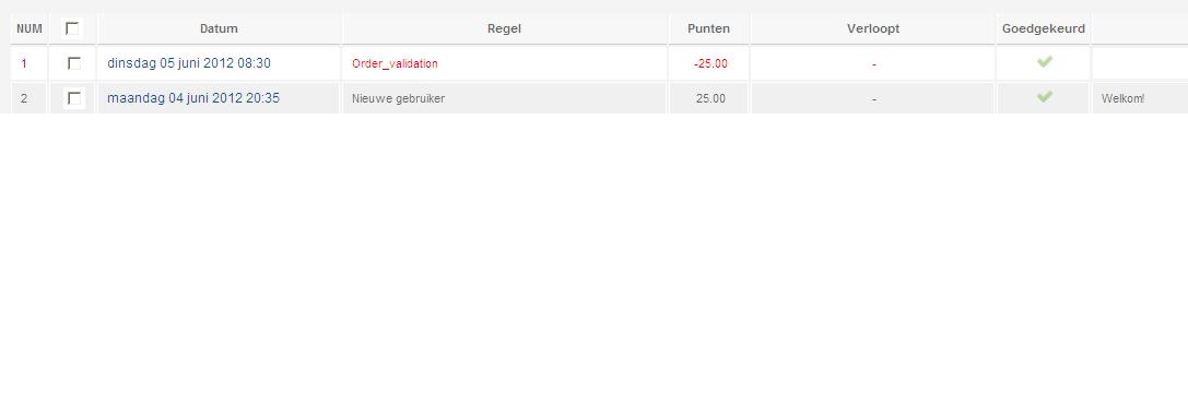

But .... i just did a testorder.

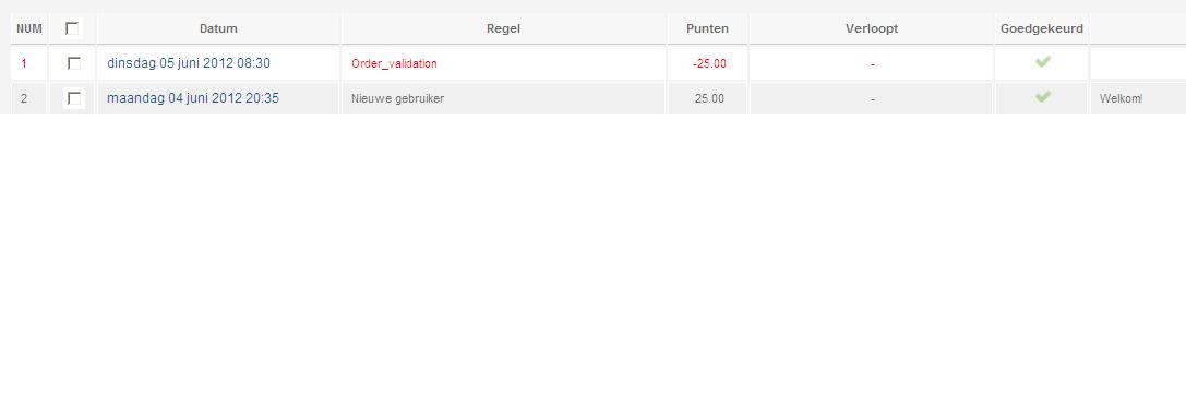

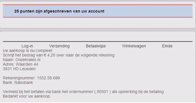

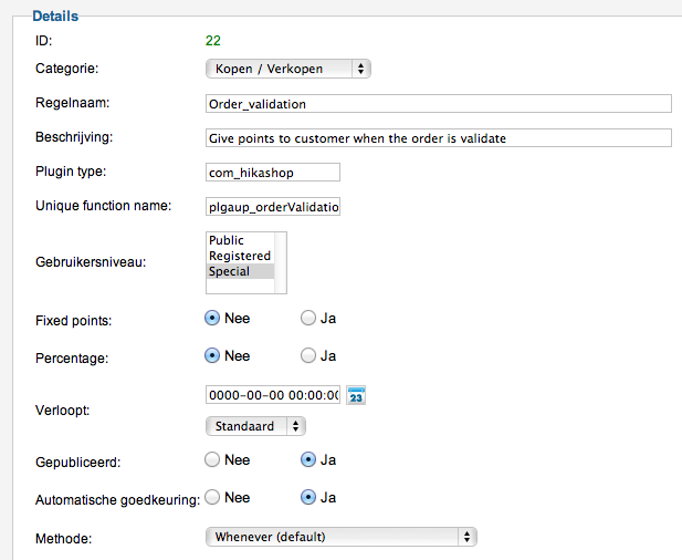

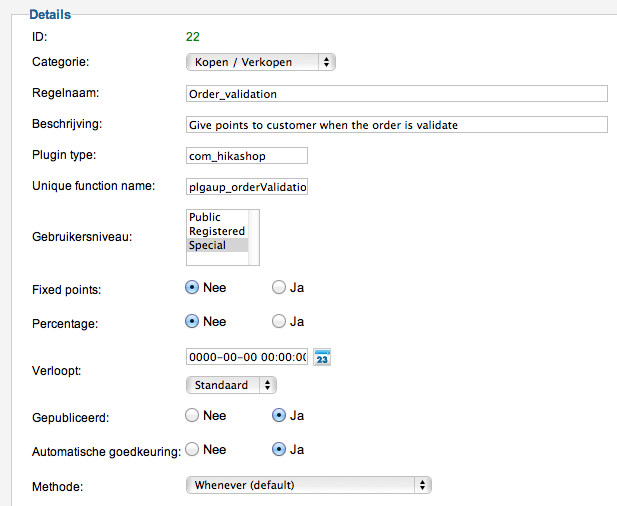

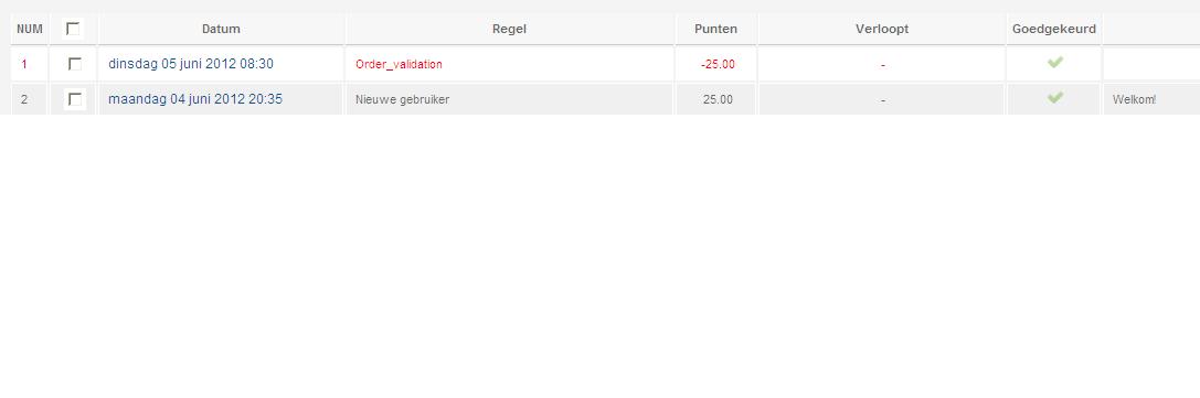

In stead of me getting new points for my purchase, it deducted my points.

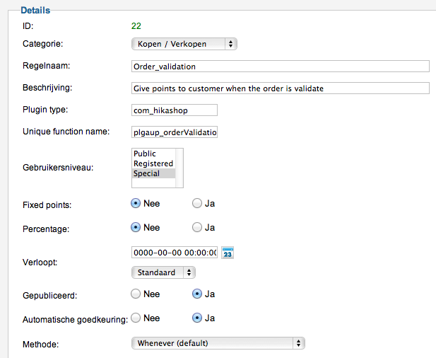

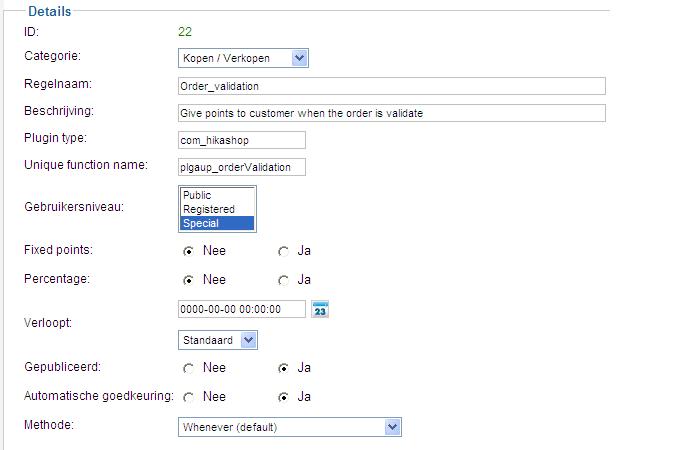

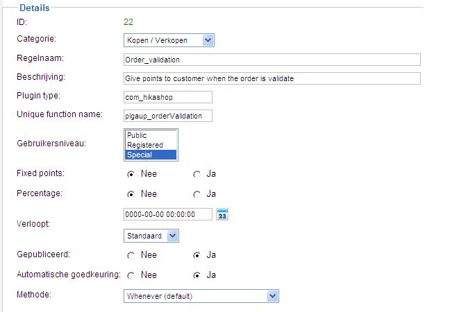

I have inserted some printscreens to help you with my settings. In the rules section of alphauserpoints i've changed the category but that's the only thing i can think of.

I don't know what is that category option for or why it would have points removed instead of added. Do you have the latest version of the plugin (1.5.8, you can check in the header of the plugin's file plugins/hikashoppayment/alphauserpoints.php)?
I see that you restricted the alphauserpoints plugin to the Netherlands, so if your address is outside, it won't propose you to pay with your points.
Maybe that's why ? You also need to have enough points in order to pay with them. Is that the case ?

i dont know what the option is for. Never used Alphauserpoints before. I have changed it now into system. Maybe that works.
I have version 1.5.8:
* @version 1.5.8
I deleted the netherlands restriction.

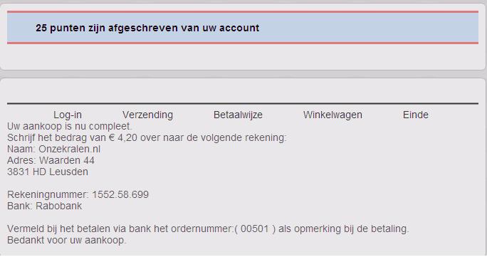

I had 25 points the last time i tried it, and it deducted all my points after completing the order.
I will try it now to see how it works with my new settings.

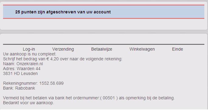

I will complete the order to see i have saved some points.
At completion of my order i now get the message that 60 points are deducted.
That is correct with what i saw in the checkout.
In Alphauserpoints i now see another activity that i completed my order and that 60 points are deducted.
Still no new saving of points ......
By the way: I had given myself 75 points, so i had enough points.

That's normal. You have the "use virtual points" option activated. Please turn it off.
That option allows the user to directly use the points he would have by completing the order in order to pay the current order. So it takes those points, plus some of the points you already had for that. That's why you get a point deduction.

Having coupons instead of points deduced comes from the "Use virtual coupons" option of the plugin. You should turn it on.

  • Posts: 86177
14 years 2 months ago #55075
That file doesn't change the fact that it would display the payment plugin or not.
It must come from the configuration of the AUP plugin itself.
Could you do a screenshot of the options ?
