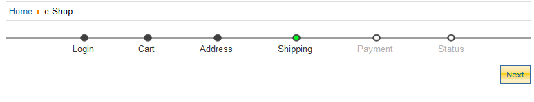

During my test on purchasing process, when customer decides to purchasing a downloading products (electronic file) nothing is written for shipping method.
i know it sounds maybe crazy but to keep a standard process, i would like to display at least a simple information like "downloading doesn't shipping" or "available only for downloading" or "download only".
How can i do that ?
at least is it possible ?
thx.

You should edit the file shipping of the view checkout via the menu Display->Views and add the line below at the end:
<?php else{echo 'No shipping needed for downloadable goods';} ?>

nicolas wrote: Hi,
1 just want to fix some little thing.
in fact you need to delete the "<?php } ?>" before to add the code line previously written and add a } before the else.
if not it returns you an unexpected T_ELSE error.
