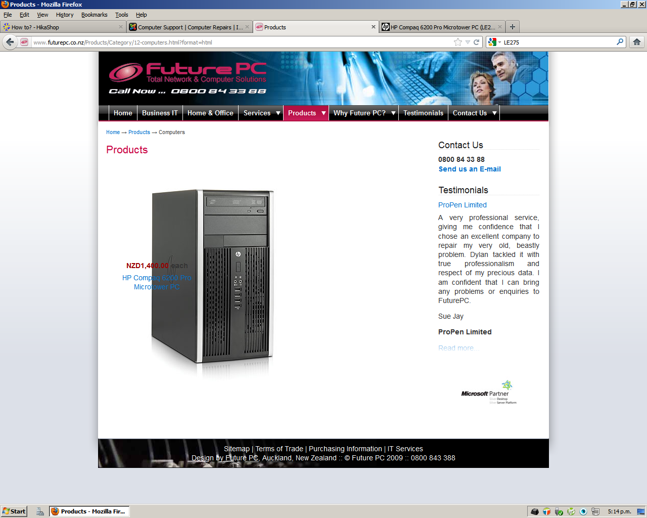

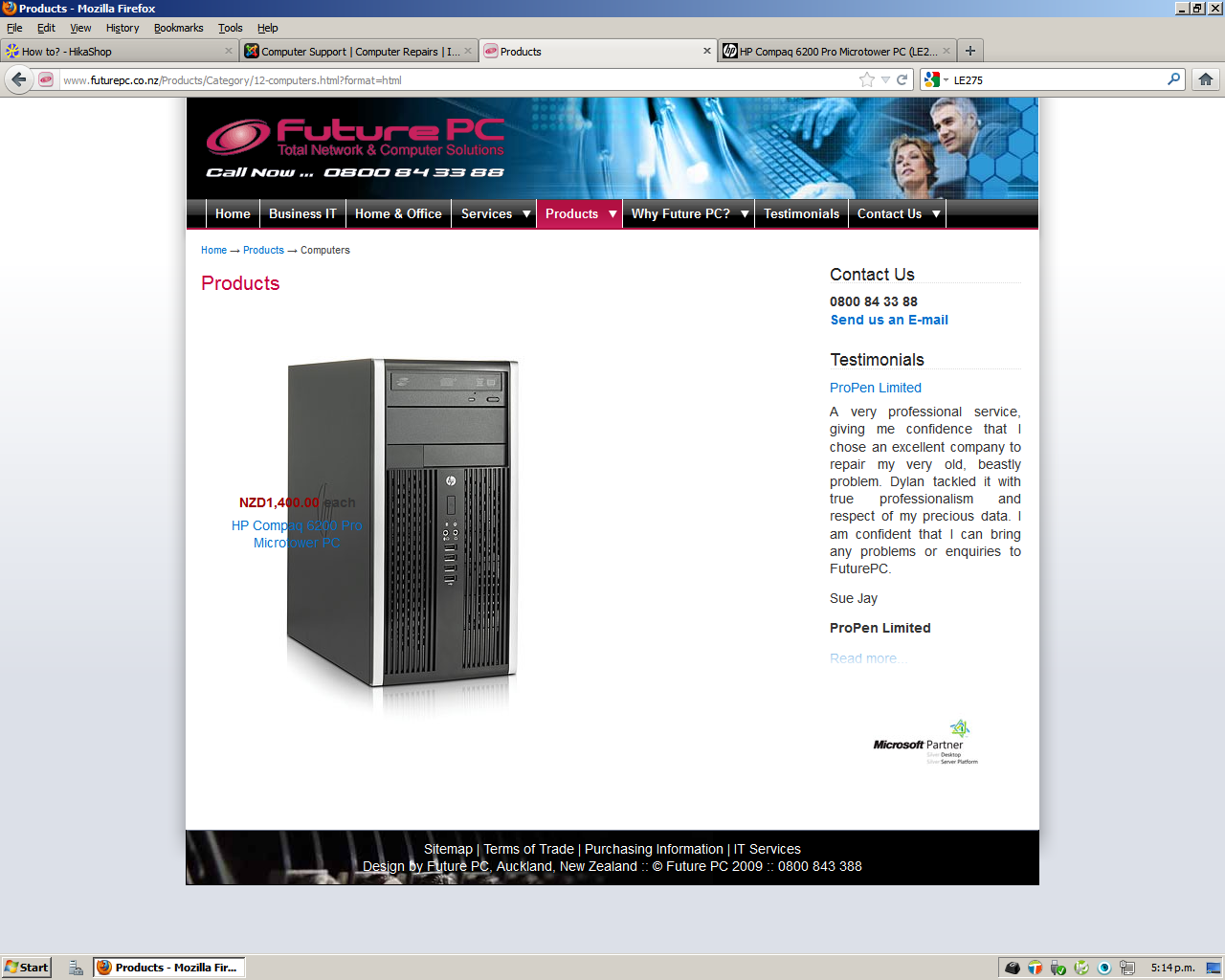

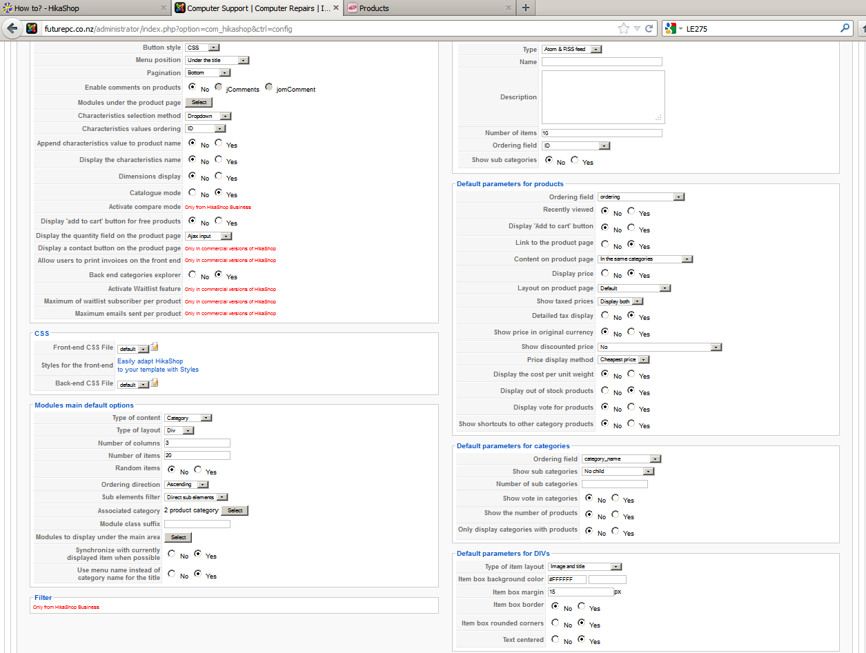

Hi guys, I'm having a weird error with the Product images with this Module,
Joomla 1.5 is the version running with the latest updates from Hikashop.
Pic error, it doesn't automatically shrink the image as it normally has for me in the past.
Error 1 & error 2 are settings which are currently set.
I have another site which this all works flawless but it has been setup with a fresh install of Joomla 2.5 and module.
any one able to help, I'm happy to up load more images.
the address for this is www.futurepc.co.nz

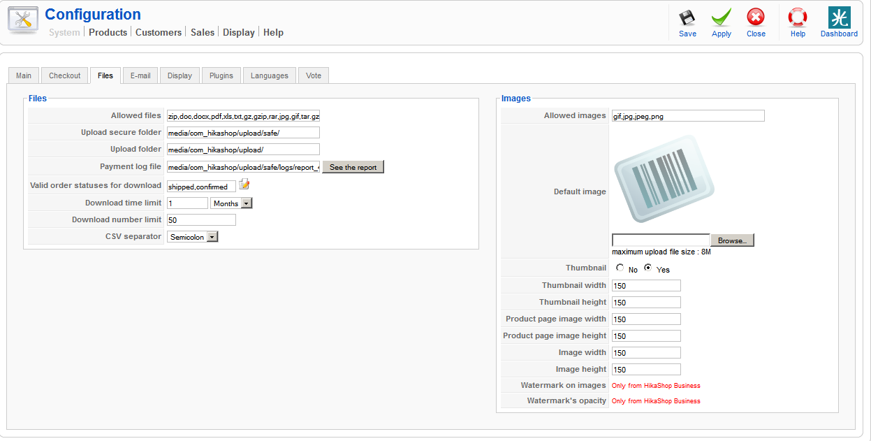

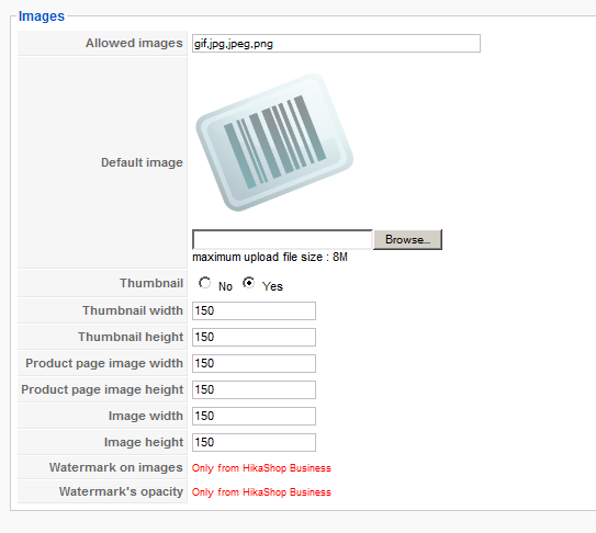

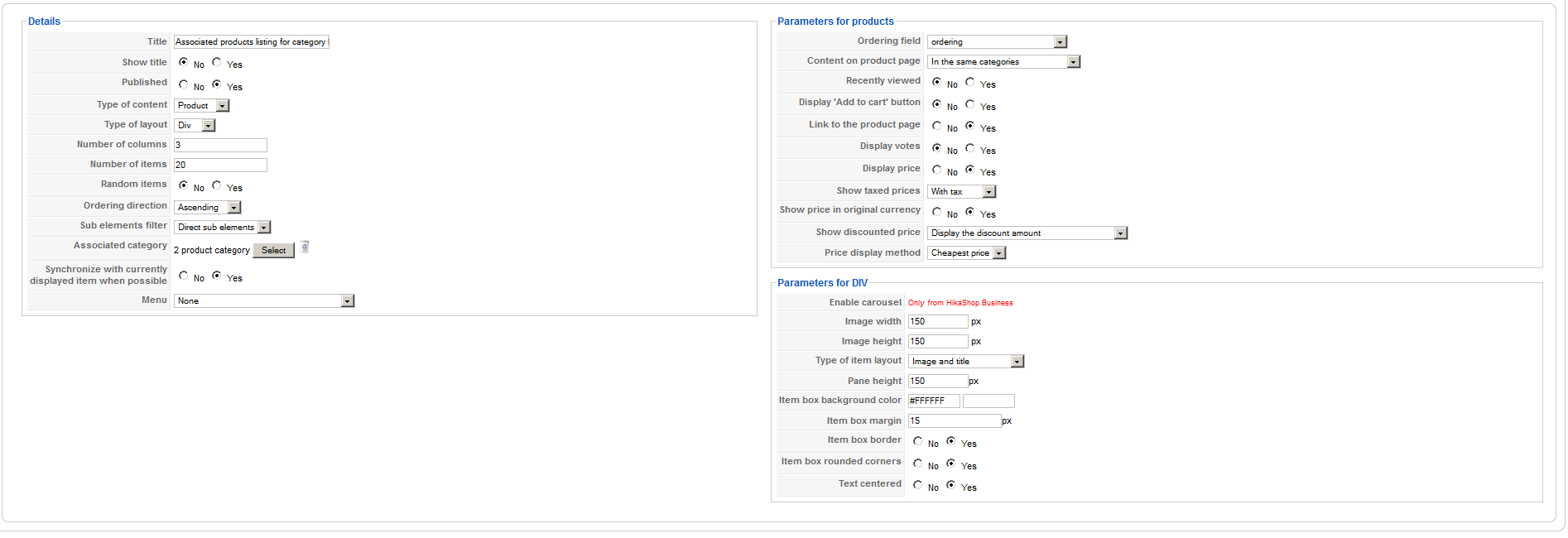

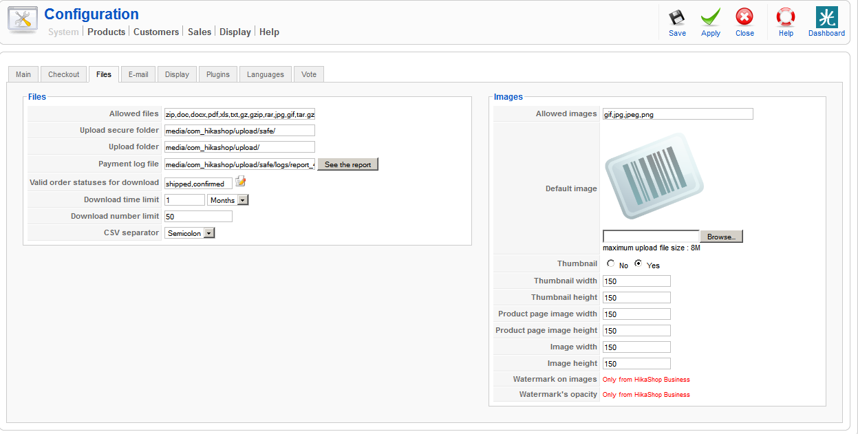

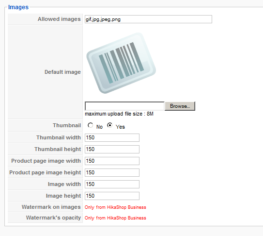

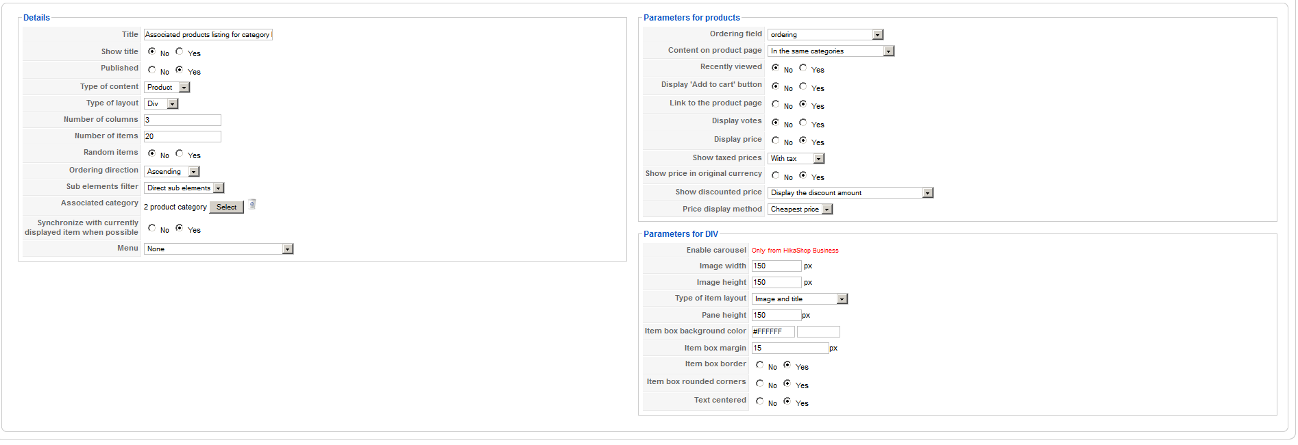

14 years 3 months ago #53609
Ok. Could you do a screenshot of the hikashop options of the module with the id 77 ? Also, could you check the image width/height options of that screen so that you have 150 there too?
  • Posts: 10
14 years 2 months ago #54154
Hi Nicolas, thanks for the reply. below are the attached screen shots

14 years 2 months ago #54230
Mmmm. I don't know why you have that.
Add the CSS code below in the front end CSS of HikaShop via the Display tab of the configuration and clear the cache of your browser and it will display Ok:
.hikashop_product_image img{height : 150px;}

14 years 2 months ago #54392
Your file is not attached.
Also, make sure that you flush your browser's cache after the modification.
I checked your website and I can see your modification. The image is now displayed fine on that page:
www.futurepc.co.nz/Products/Category/12-...ers.html?format=html
So it's just that the CSS is cached by your browser.

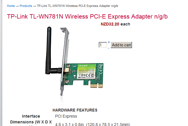

14 years 2 months ago #54731

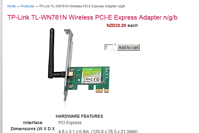

Thanks for that, worked perfect!!!
Just one last question, i want to have this auto sized as well, in that css file where would i look?
  • Posts: 86177
  • Thank you received: 14212
14 years 2 months ago #54772
Similarly, you can use that CSS:
.hikashop_product_page img{height : 150px !important;}
