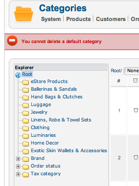

14 years 3 months ago #53136

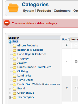

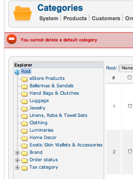

I need to delete categories I created at root so I can re-enter them correctly in Products Category. I am getting an error message when I try to do this: "You cannot delete a default category". Is there a way around this in Hikashop, or a way to delete these categories in cPanel? How do I delete them?

Hello Scott,
I think that you can't delete the default categories because Hikashop uses them.

Hi Mohamed, thanks for the help. But I only want to delete the product categories that I created.... then recreate them under the "products" category... We talked before about how I can not move theses categories because they have been created under the "root"... I assumed that I could just delete them and start over... now what?
scott
14 years 3 months ago #53154
You shouldn't have done this but if you want to start over you'll have to delete the hikashop_category table and instal hikashop again.

We don't want you to delete the default categories. Otherwise, HikaShop won't work properly. If you start to create additional main categories, they will also be considered as default categories and HikaShop won't allow you to move them.
Normally, you should create your categories under the "product categories" category. That's actually what happens when you go in the categories listing, click on new, enter a name and save. The category is automatically added under the "product categories" category.
If you delete the hikashop_category table and reinstall, that will remove your categories and put the default categories. However, that also mean that you will loose the links to the products, you so won't be able to see the products anymore...
If you have only a handful of products, you can recreate them. But if you have a lot of them that's really not a practical solution.
If you want to move the categories without destroying the link between products and categories, you can edit the categories in the hikashop_category table and change the category_parent_id to the new parent id you would like. Then, you will have to edit a product category via the interface, and change the category parent category (so it must one a category which was not a main category before, otherwise you can't edit it. That will make hikashop reprocess the category tree so that it is inconsistent. If you don't do that second step, you will get strange results in the listings.

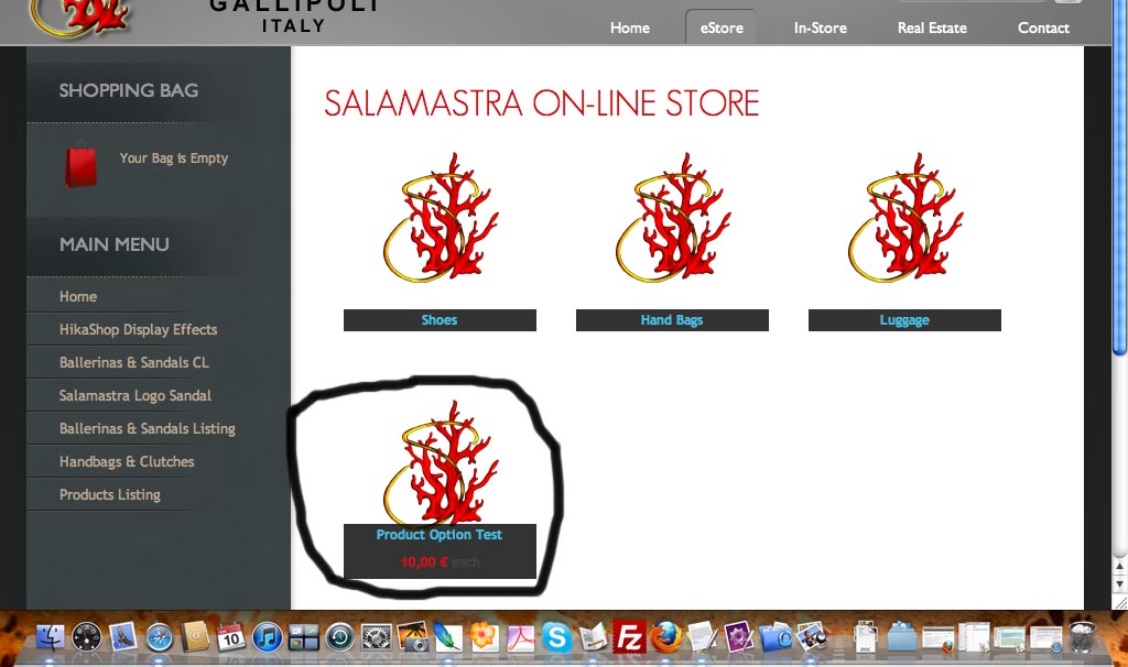

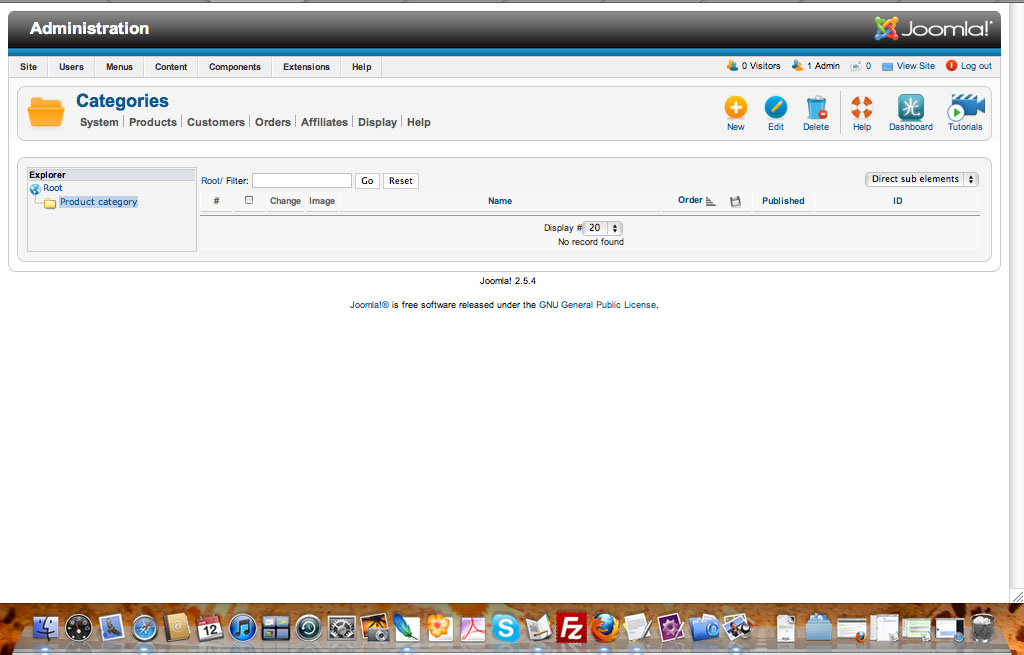

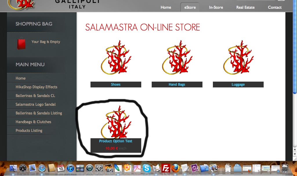

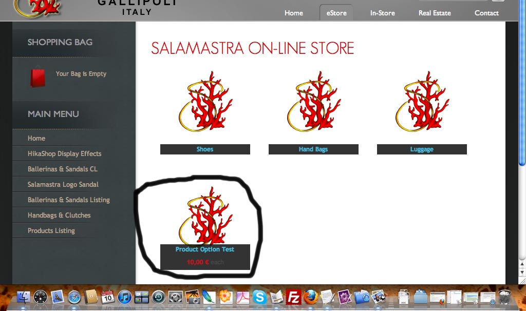

Also, will this get rid of ghost product option that I still see now when I do a categories listing? see pic below:
If the above command will not get rid of this product option, can you give me the steps to do this as well?
Thanks again
Scott

14 years 3 months ago #53360
There is no need to enter a command. Go in phpmyadmin, open your database, click on the hikashop_category table and then on the delete button...

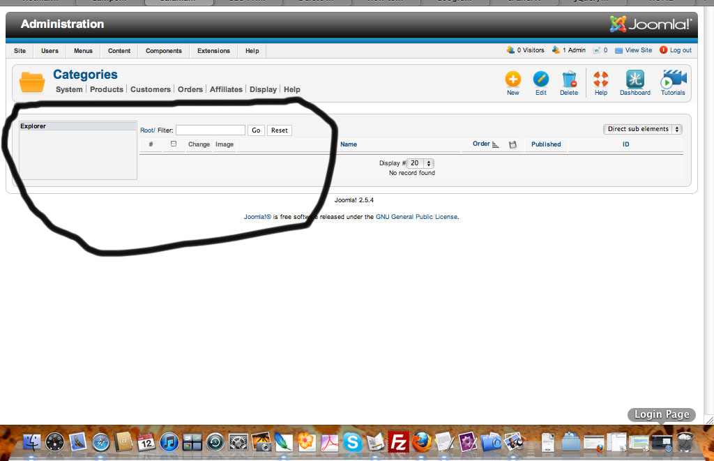

14 years 3 months ago #53392

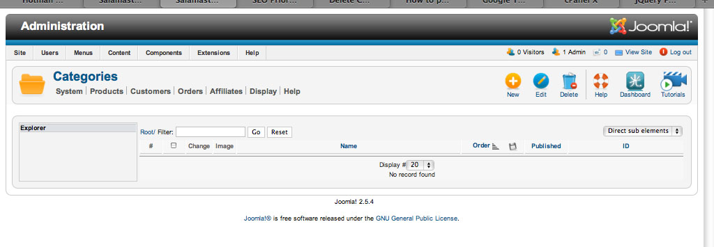

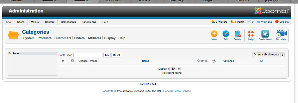

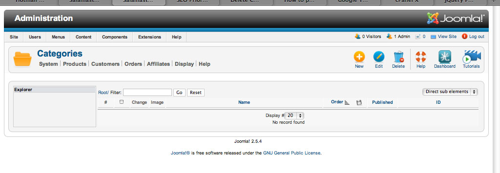

Hi again Nicolas,

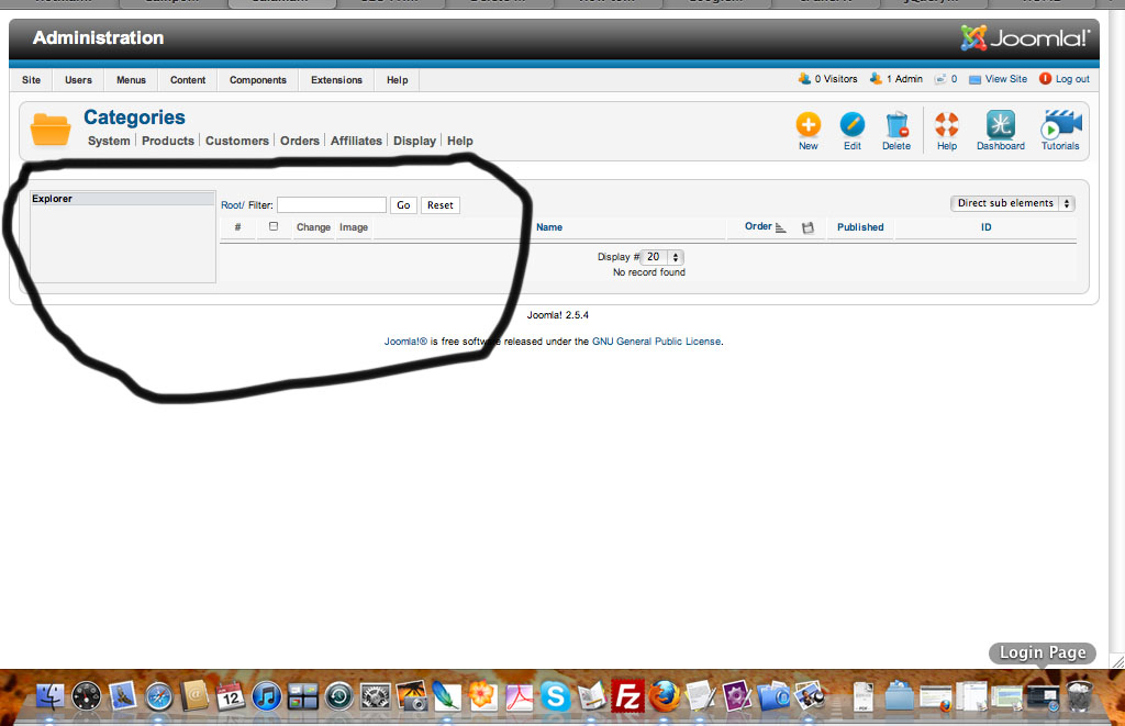

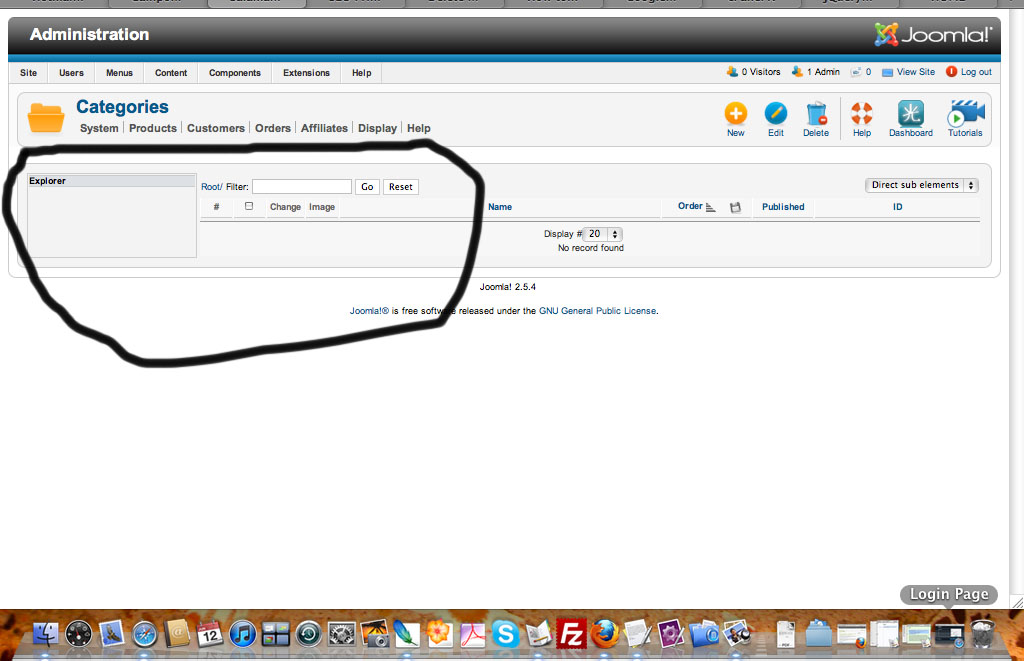

Thanks for the instructions. I deleted the hikashop_categories table and reinstalled HS. I want to avoid same error as before, but now on the add categories page, i do not see the original folders that I saw before like product categories, and I think, zones and a few others. I was hoping to see them so I could be sure to create my categories in this folder. From my attached pic, you can see that these folders are no where. I do not want to create another category under the root, but from the picture you can't see the product categories file.
Can you see anything wrong here? Where is default product categories folder? Do I need to create it now in the location on this page: please let me know, thanks.
scott
  • Posts: 86177
  • Thank you received: 14212
14 years 3 months ago #53394
This means that the installation script couldn't add back the categories. It's probably because it couldn't create the table.

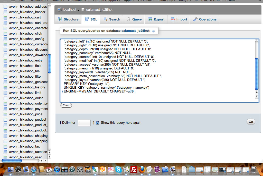

CREATE TABLE IF NOT EXISTS `jos_hikashop_category` (
  `category_id` int(10) unsigned NOT NULL AUTO_INCREMENT,
  `category_parent_id` int(10) unsigned NOT NULL DEFAULT '0',
  `category_type` varchar(255) NOT NULL,
  `category_name` varchar(255) NOT NULL,
  `category_description` text NOT NULL,
  `category_published` tinyint(4) NOT NULL DEFAULT '0',
  `category_ordering` int(10) unsigned NOT NULL DEFAULT '0',
  `category_left` int(10) unsigned NOT NULL DEFAULT '0',
  `category_right` int(10) unsigned NOT NULL DEFAULT '0',
  `category_depth` int(10) unsigned NOT NULL DEFAULT '0',
  `category_namekey` varchar(255) NOT NULL,
  `category_created` int(10) unsigned NOT NULL DEFAULT '0',
  `category_modified` int(10) unsigned NOT NULL DEFAULT '0',
  `category_access` varchar(255) NOT NULL DEFAULT 'all',
  `category_menu` int(10) unsigned DEFAULT '0',
  `category_keywords` varchar(255) NOT NULL,
  `category_meta_description` varchar(155) NOT NULL DEFAULT '',
  `category_layout` varchar(255) NOT NULL DEFAULT '',
  PRIMARY KEY (`category_id`),
  UNIQUE KEY `category_namekey` (`category_namekey`)
) ENGINE=MyISAM  DEFAULT CHARSET=utf8 ;
Then, install again HikaShop and hopefully you should get back your categories.

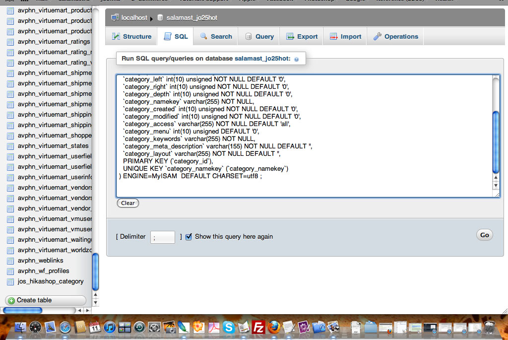

14 years 3 months ago #53538

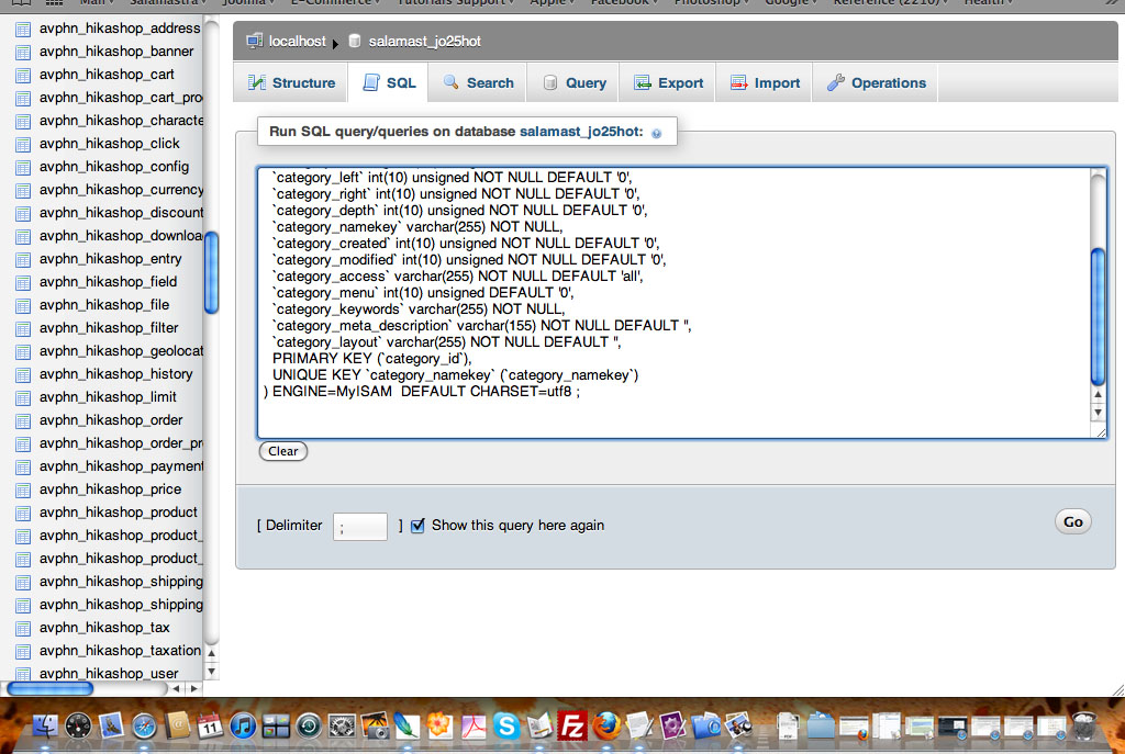

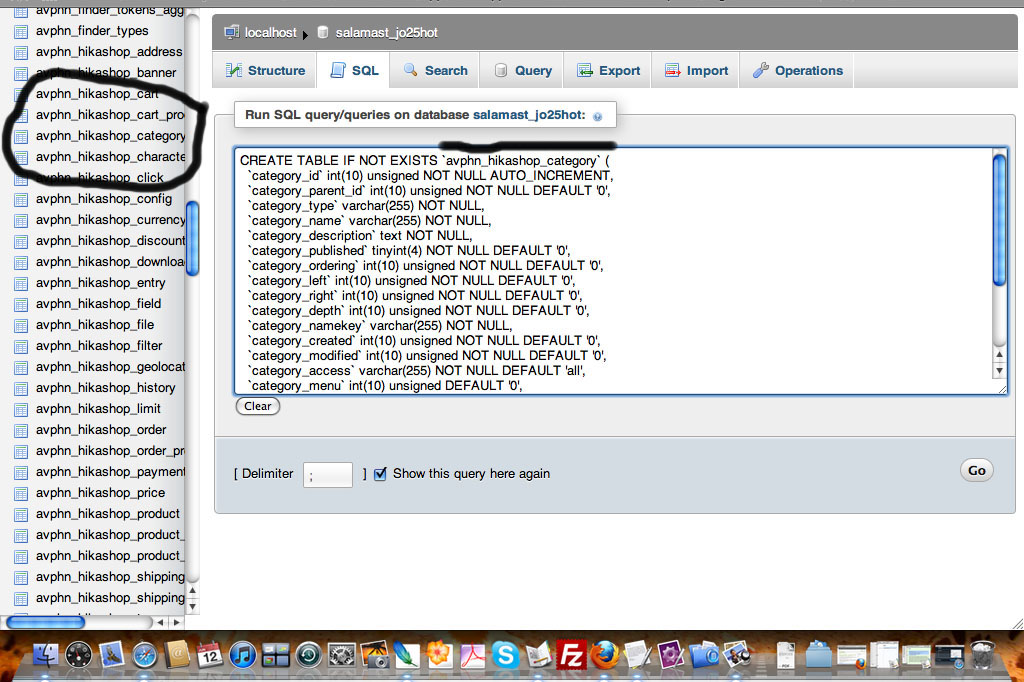

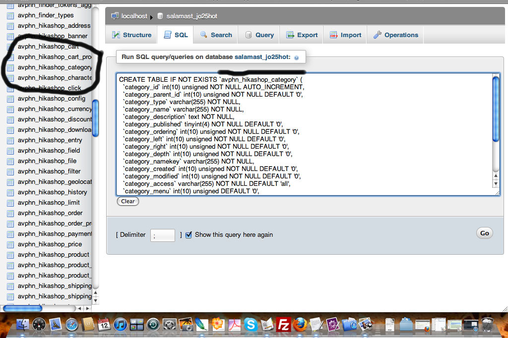

Hi Nicolas, I ran the script, but then I realized that all of my tables have prefix: avphn and this script made table with prefix jos ... and I still only see blank directory without default categories. Should I just rerun the script using avphn prefix instead of jos? Or do I need to delete this jos table first? If so, please give the comands to do that. Thanks again for your help with this and sorry for bother.
Scott
Last edit: 14 years 3 months ago by scottshort.
  • Posts: 86177
14 years 3 months ago #53545
Yes, you need to change the prefix of the table in the query. No need to delete the table.

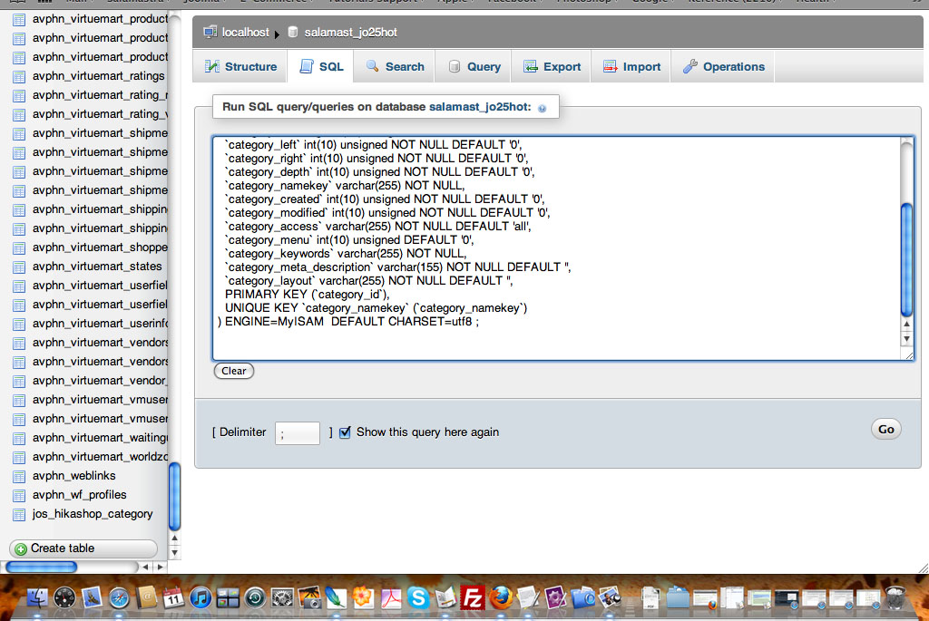

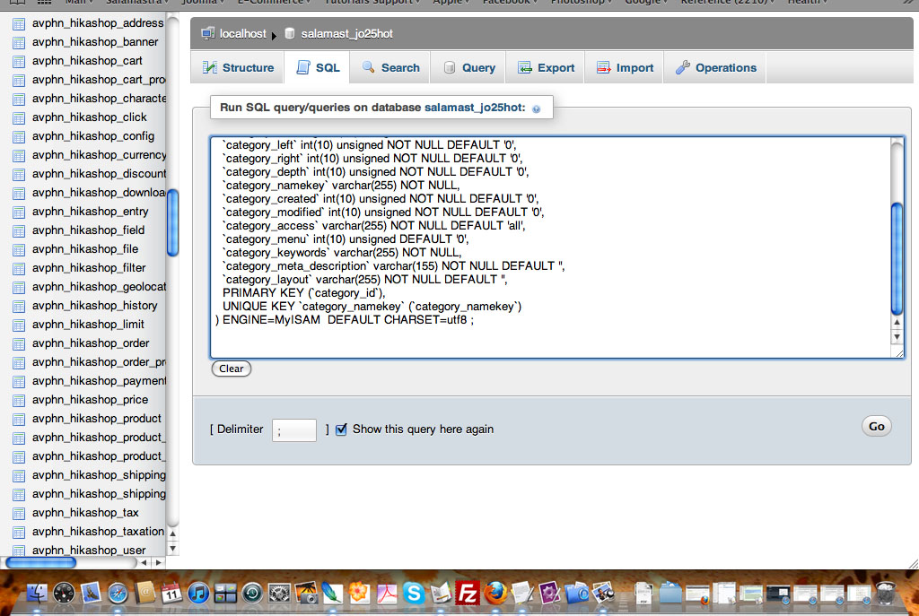

14 years 3 months ago #53581

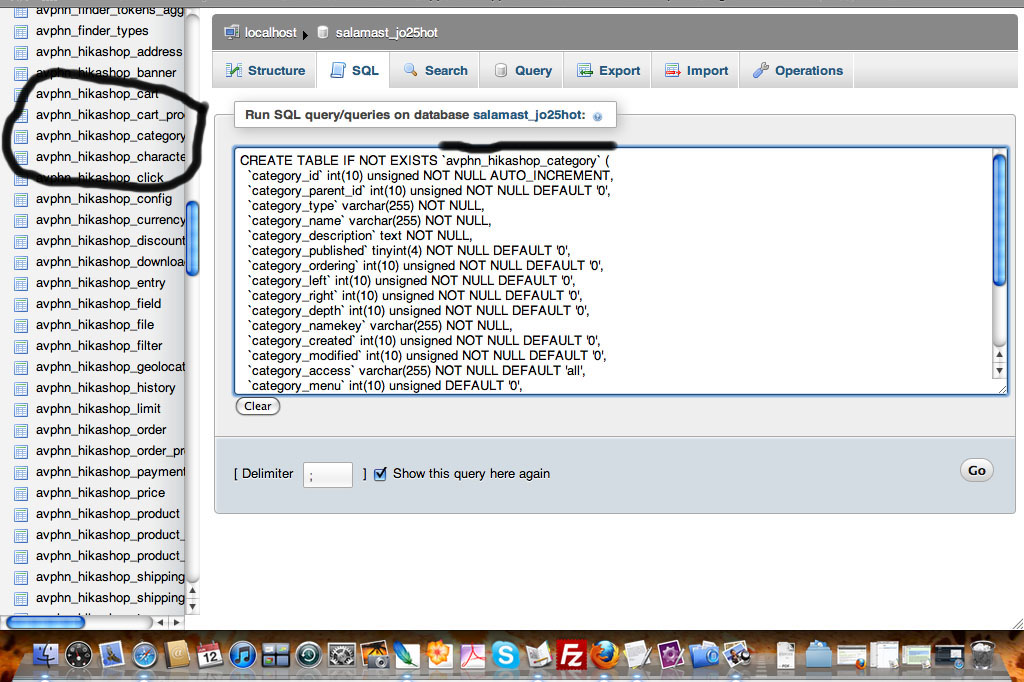

I installed the table as you can see in first pic:
But still no default folders showing on add category page... can you see if i did anything wrong? Any additional suggestions?
Thanks again for your help.
Scott
  • Posts: 86177
14 years 3 months ago #53583
Now that you added the table, you need to install HikaShop again so that it can fill the table.

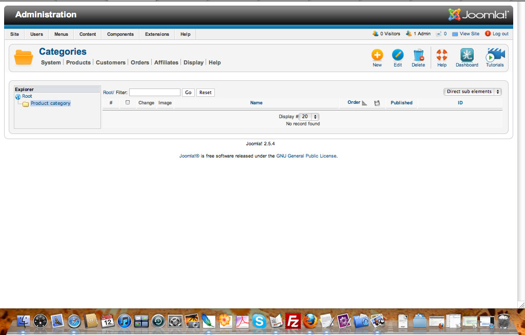

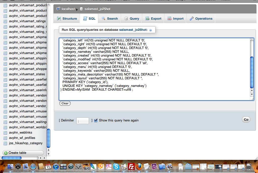

  • Posts: 76
14 years 3 months ago #53630
Hi Nicolas

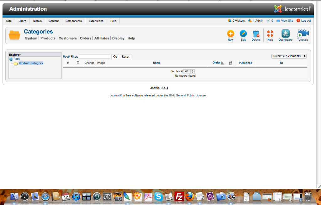

I now have product category folder. See first pic:
But what about the other category folders that I had access to before [see first post]?
I can still reach the Brand Category folder via the Brand Manager page, and the Tax Category folder via the Tax Category Manager page, but I see no way to reach the order status category folder.
Do you suggest that I need to do something further regarding these category folders?
Scott
  • Posts: 86177
14 years 3 months ago #53634
The order statuses can be accessed via System->Order statuses.
That's the normal behavior. There is nothing else to do.
