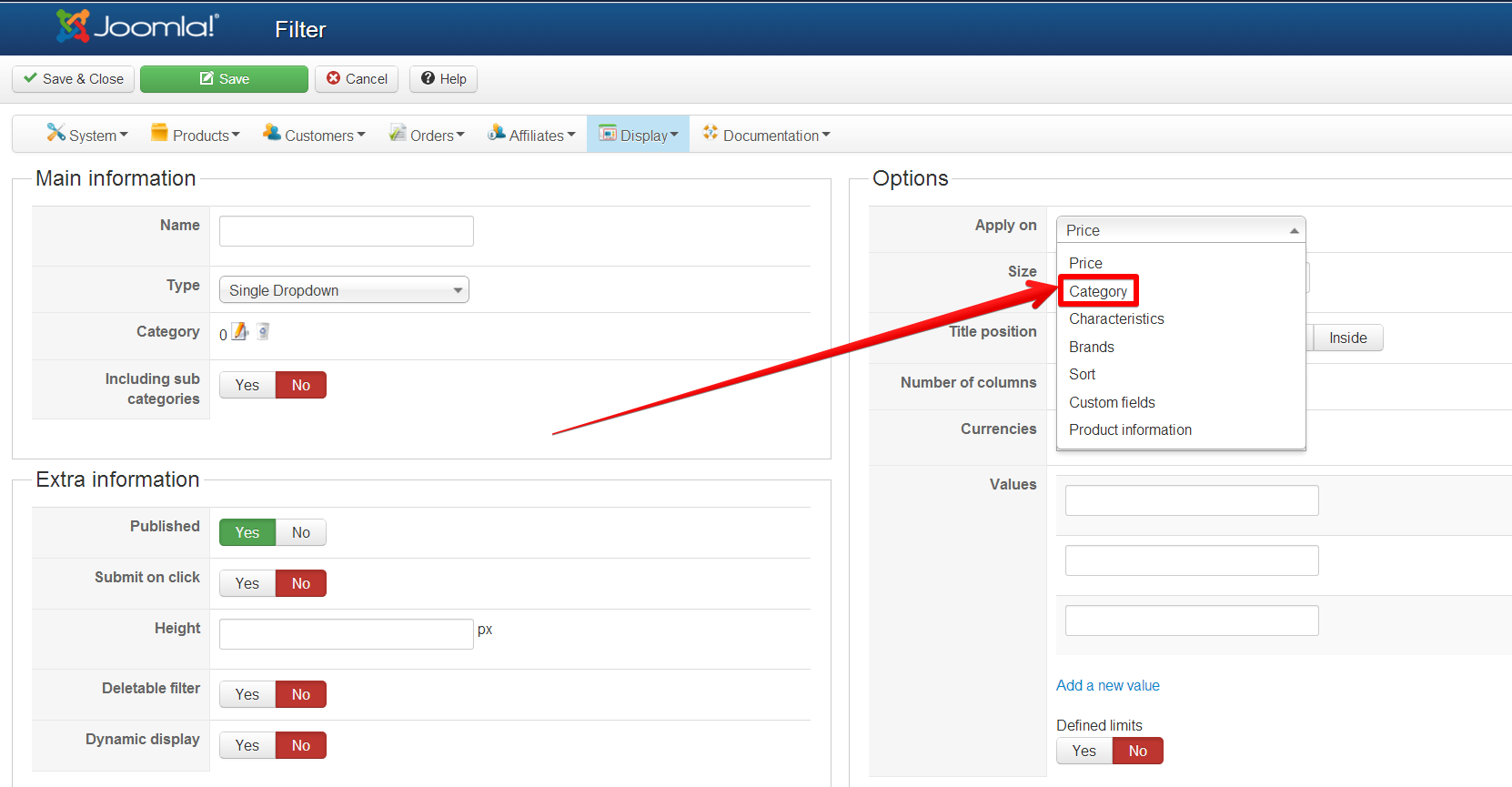

13 years 3 months ago #107193
You can already create filters which apply on categories:
So there is no need to change any code.

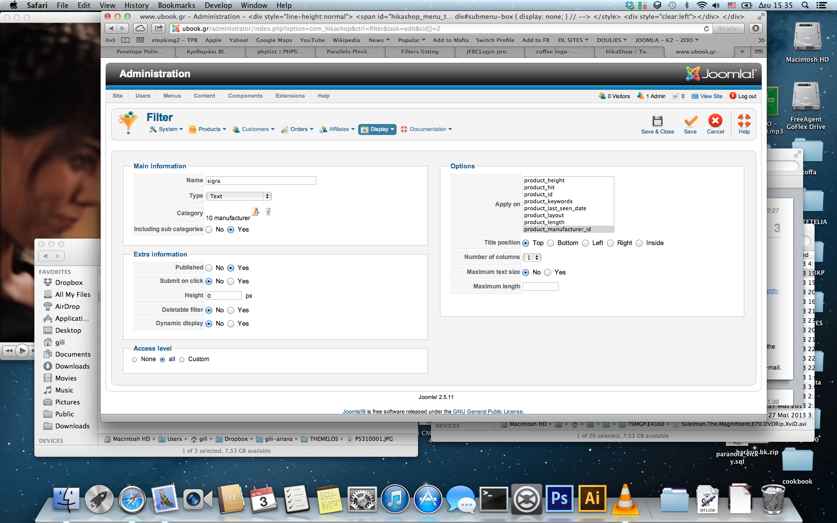

  • Posts: 51
13 years 3 months ago #107326
i dont have these options .............
apply on ... i have only product options

  • Posts: 51
13 years 3 months ago #107419

13 years 3 months ago #107454
For the filter it depends on the filter type. You have to select "dropdown" or "checkbox" to filter on categories.
You don't have to set values, it will get the available categories by default.
Regarding the search, it's based on the Joomla search, so there is maybe an option in the joomla configuration for that.
