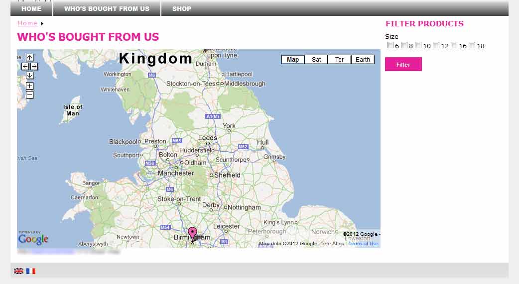

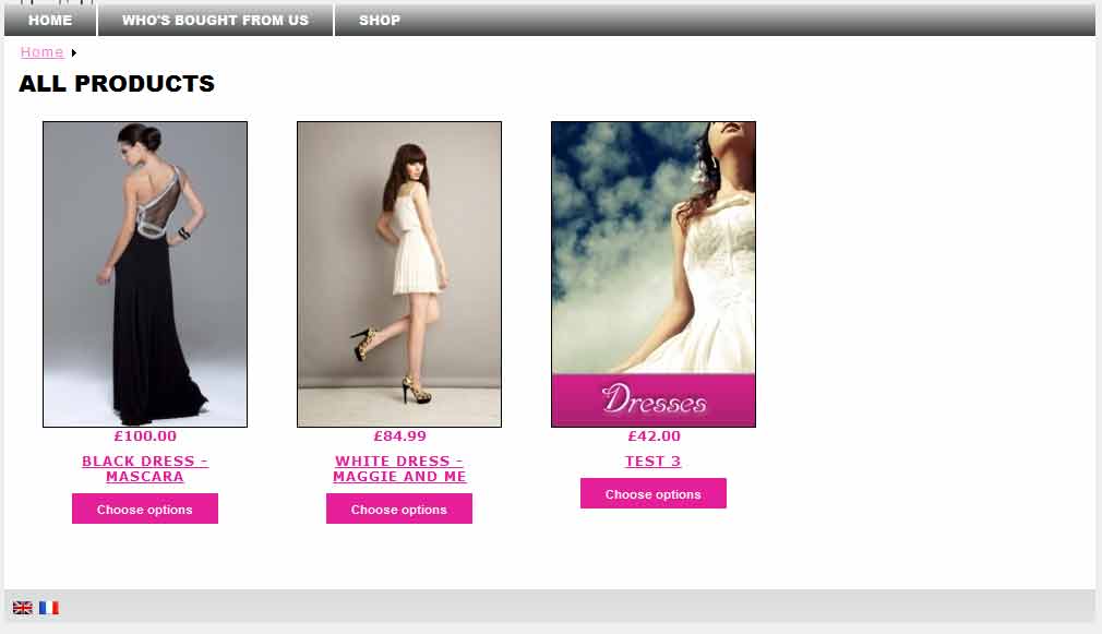

  • Posts: 39
14 years 2 months ago #54898
My site is currently on my local pc only. It is the same template for the rest of the site (apart from the home page but i haven't got the filter set to show there so that's irrelevant).

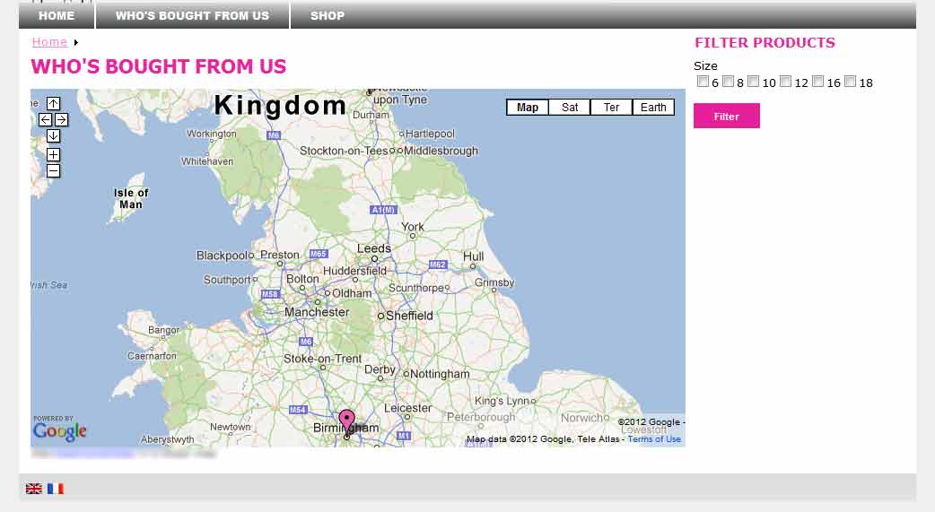

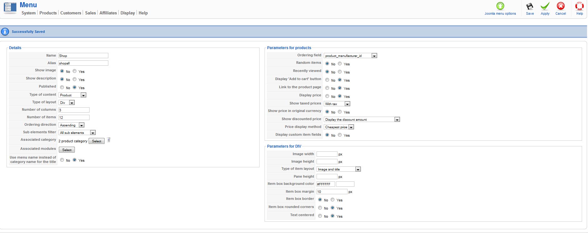

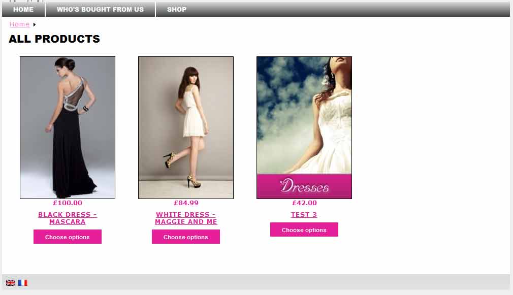

Here's the exact set up: I have a link called "Shop" on my main menu that runs on the top of all pages. That links to Hikashop "Products Listing". "Product" is the type of content it displays. I have a module made to display the filters for Hikashop. This is set to appear on all menu items. It doesn't show on the homepage since it doesn't contain the module name because it's a different template. It appears on all other pages (these all share a different template to the homepage) except for the Hikashop Products Listing page. I'm using Joomla 1.5. I've attached 2 images. e1.jpg shows how the filter displays while visible. e2.jpg shows the products page and how the space is there for the module to display but it isn't showing.
Also, if i click on one of the products on the listings page so i go to the individual product's page, the filter IS visible there. So it's only on the listings page for all the products that it isn't showing.

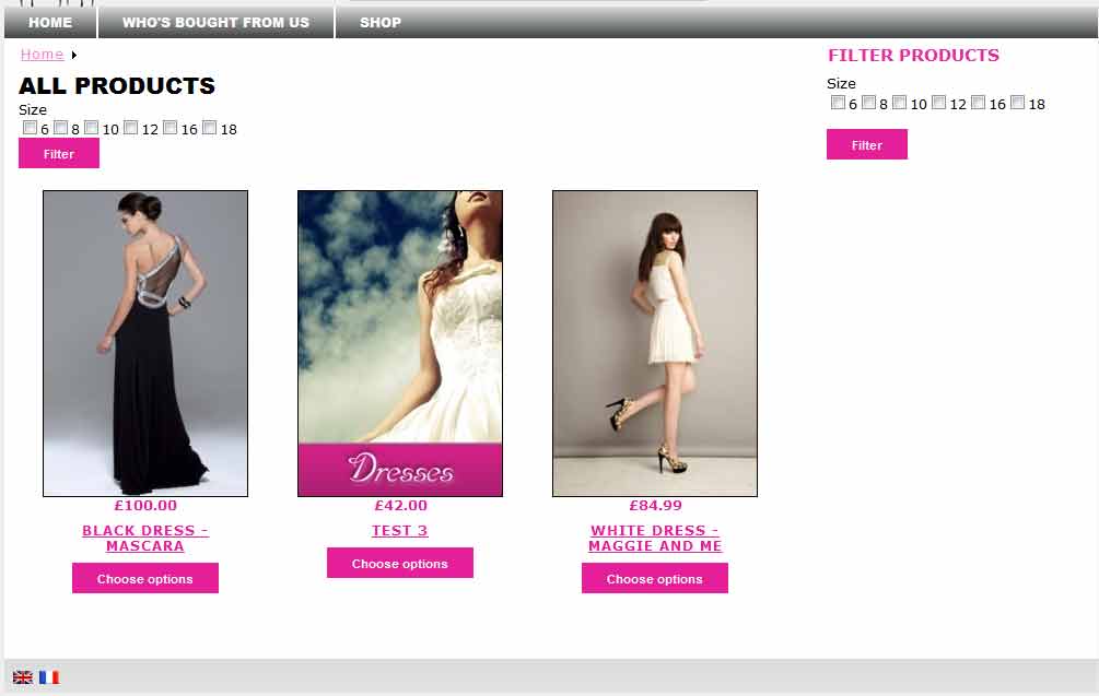

Update: I went in to the menu options for the shop and tried changing some things. When i changed the content display from product to something else i had different results. For Product and Category the filters don't show, however they DO show when it's set to manufacturer. Perhaps you might know why it won't display for products but will for manufacturer?

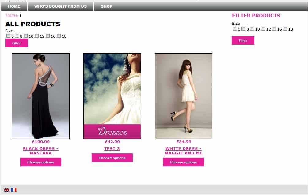

UPDATE 2: After some further playing around i set the associated category in Hikashop>Display>Content Menus>Shop to All Products. This has made the filters show in the module position, however it also shows filters above the content (see e3.jpg). How do i set it to just display in the module?
Last edit: 14 years 2 months ago by 2ndrendermedia.
  • Posts: 86176
  • Thank you received: 14211
14 years 2 months ago #54976
If you want to hide the filters at the top of the products listing that's easy, you can add such CSS (replace the X by the id of your menu) in the front end CSS file of HikaShop via the Display tab of the configuration :
#hikashop_category_information_menu_X .hikashop_filter_main_div{ display:none; }
The following user(s) said Thank You: 2ndrendermedia

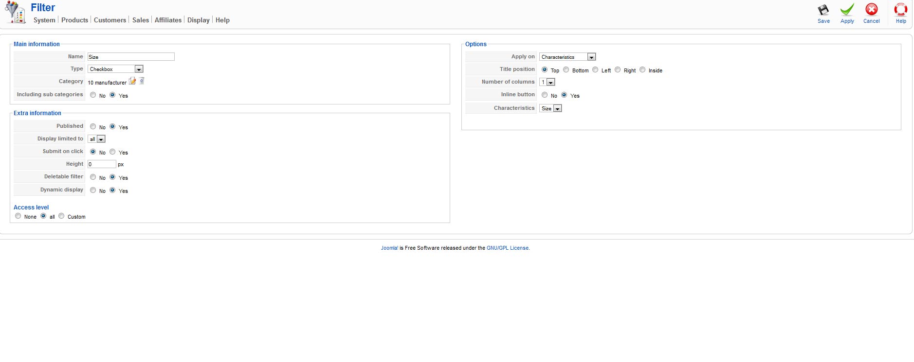

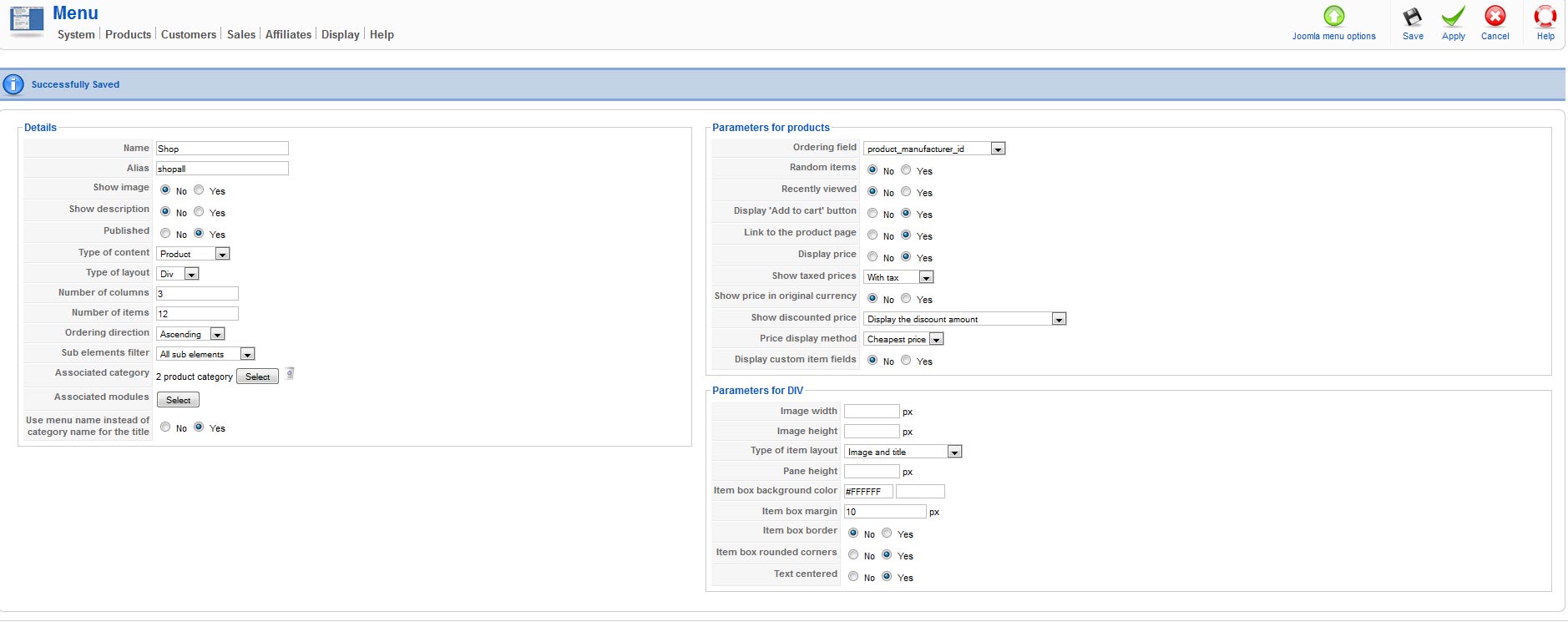

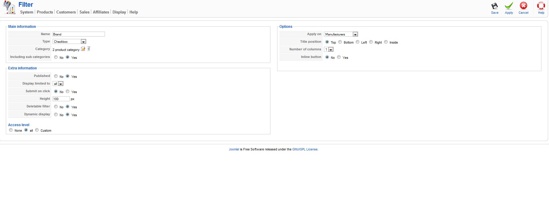

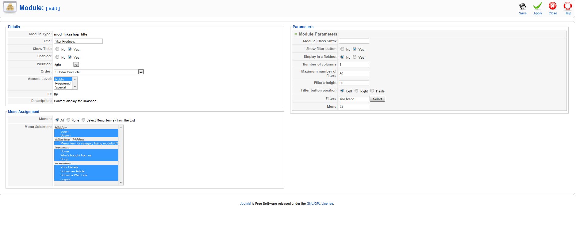

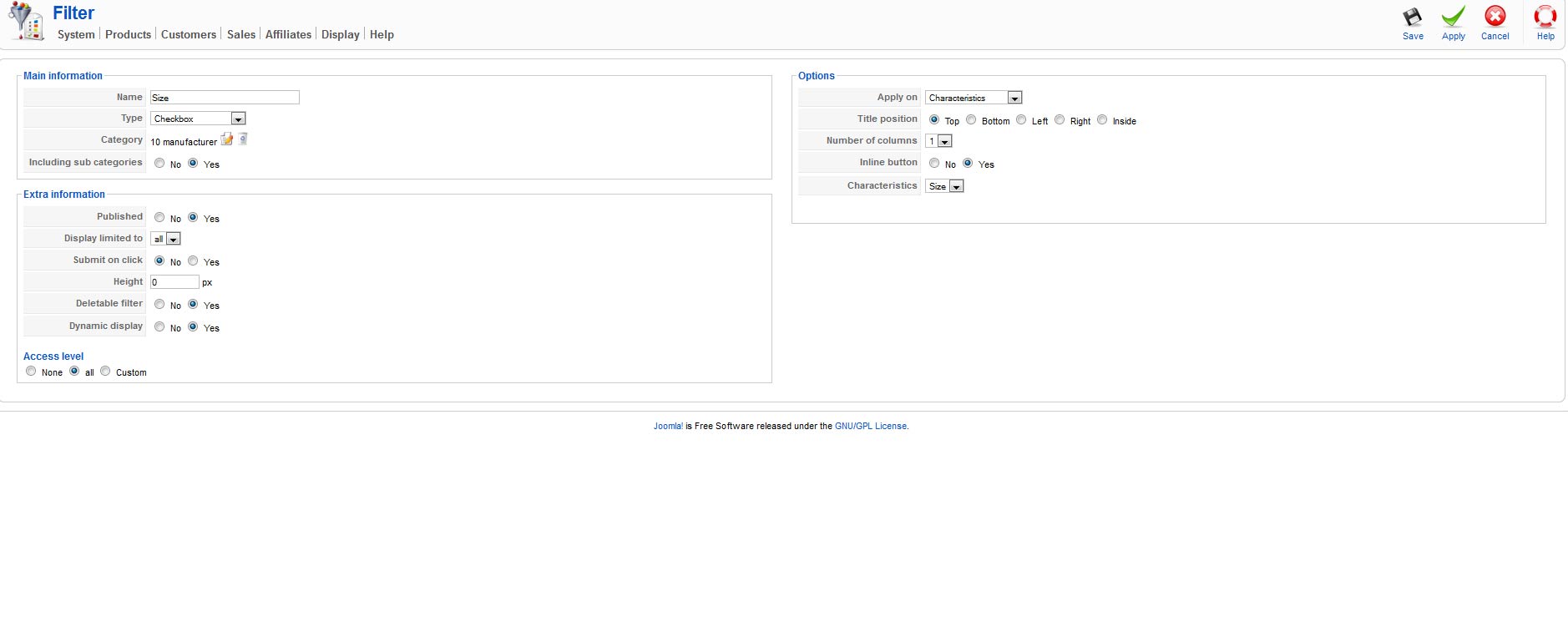

Unfortunately this didn't work. I've attached some screenshots for you.
r1 shows my menu options for the page that displays all products. (Menu is HikaShop » Product / Listing)

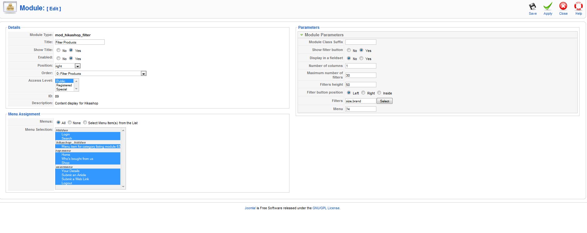

r2 shows the filter module options.
r3 shows the "size" filter options.

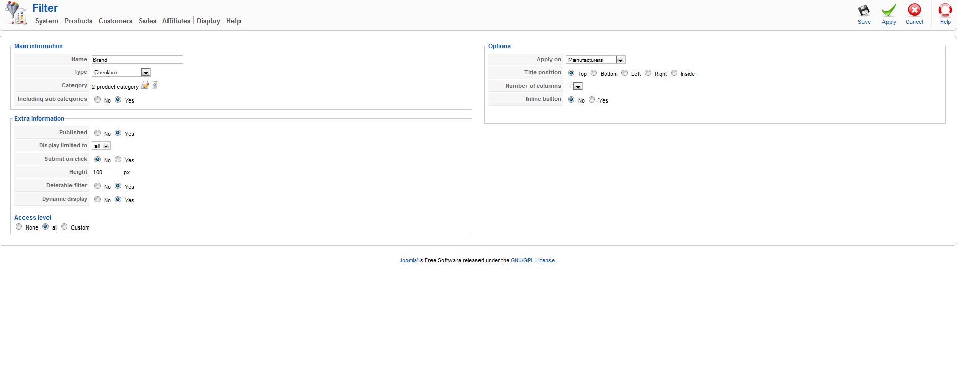

r4 shows the "Brand" filter options.
Let me know if you need to see anything else.

  • Posts: 86176
14 years 2 months ago #55883
I cant see that you have the "dynamic display" option turned on for your filters... Please turn it off.
Also, please remove the "category" restriction (third option) of each filter.
That will probably help a lot.
