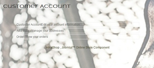

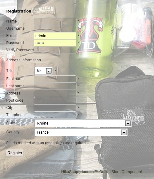

The member registration page on my website has this default "admin" and password already inputted into the fields. How do I make it dissapear its annoying. Please see screenshot.
After logging in, the member goes to his accounts page and the options there are a little ugly as well. Because the text on the options are sticking together. How should I solve this? Please see screenshot. Thanks.

The fact that the form has the username and password is normal. It's your browser which fills that automatically.
You won't have it if you try with another browser/computer and there is nothing we can do to avoid that.
For the customer account page, that's either because your browser's cache is not flushed (so try to flush it) or because you had edited the CSS before updating HikaShop. In that case, you will have to get the control panel related CSS from the default front end CSS file and add it to your custom CSS via the Display tab of the configuration.

I have flushed my cache but the problem is still there. It must be the css affair which you mentioned.
However, I don't remember editing any css which might have caused this problem. Are you referring to one of the files in HikaShop -> Display -> Views -> Frontend? Could you point out the specific one?

No, it's in the Display tab of the configuration:
www.hikashop.com/en/support/documentatio...-config.html#display
