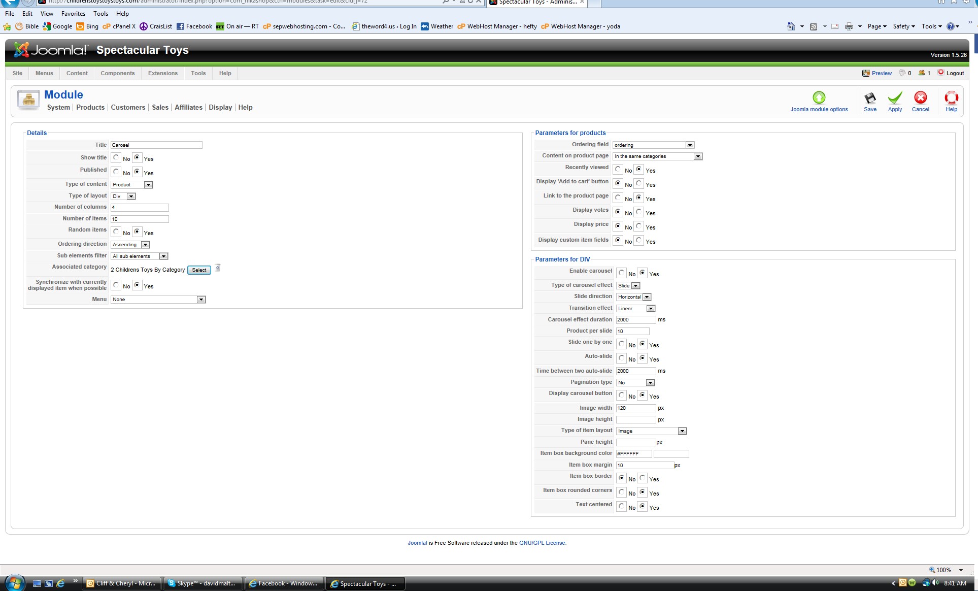

I dont understand what I am doing wrong, I have it set up as it says in the "Infinite slide" documentation I actaully think I used the exact paramaters? Any Help would be appreciated. Thanks.

Could you do a screenshot of the options of your module ?

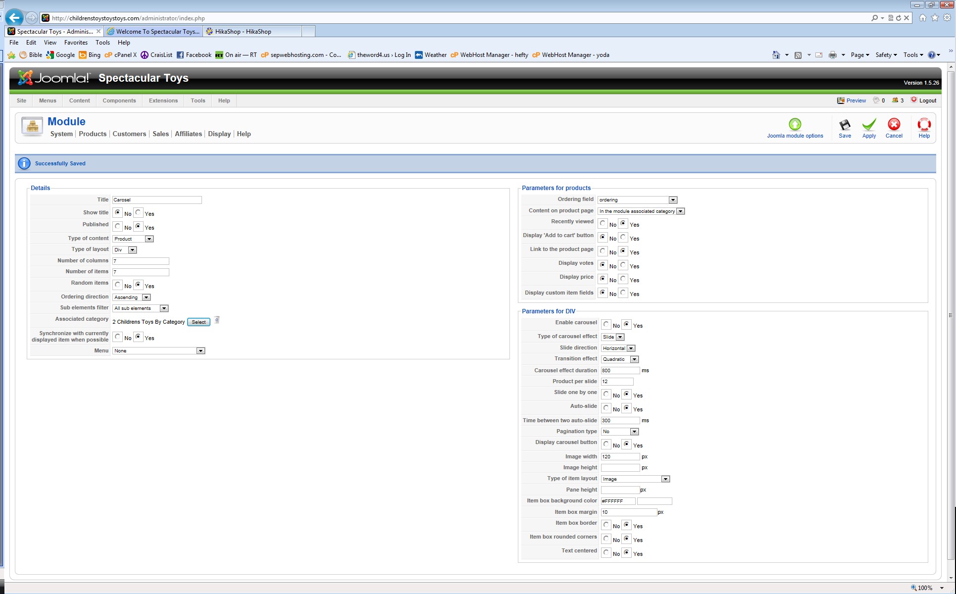

its added.

You set a number of "product per slide" to 10, while you have 4 columns and 10 products per page. So that normal that it displays like that. Change the "product per slide" option to 4 and you should have something closer to what we have in the demo website.

OK it looks more like what you have on your demo site but its not rotating on its own. Attached is another screen shot of what I have the Carosel settings

You set a number of "product per slide" to 9, while you have 8 columns and 7 products per page.
So that means that on one slide it will display 9 elements and then it will shift 1 product off and on the slide.
But since you're only allowing 7 products in total for the whole slider, it won't display enough products in order to have a slider.
You should follow the settings of the module on the demo website:
The same number for the "number of columns" and the "products per slide" options and a bigger number for the "number of items" option.
That will make it slide.
Also, as in the demo website tutorial, I recommend that you turn on the "slide one by one" option.

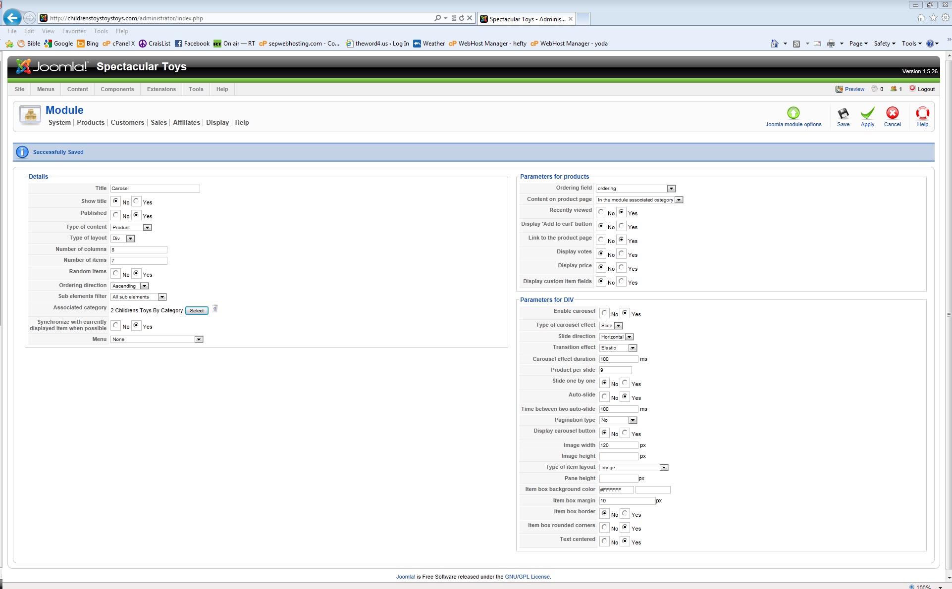

I have tried to duplicate what you have and its still not rotating. File attached

Mmm. I don't know how I should explain myself differently. It's the exact same problem as my previous message.
You need to have same number for the "number of columns" and the "products per slide" options and a bigger number for the "number of items" option. That will make it slide.

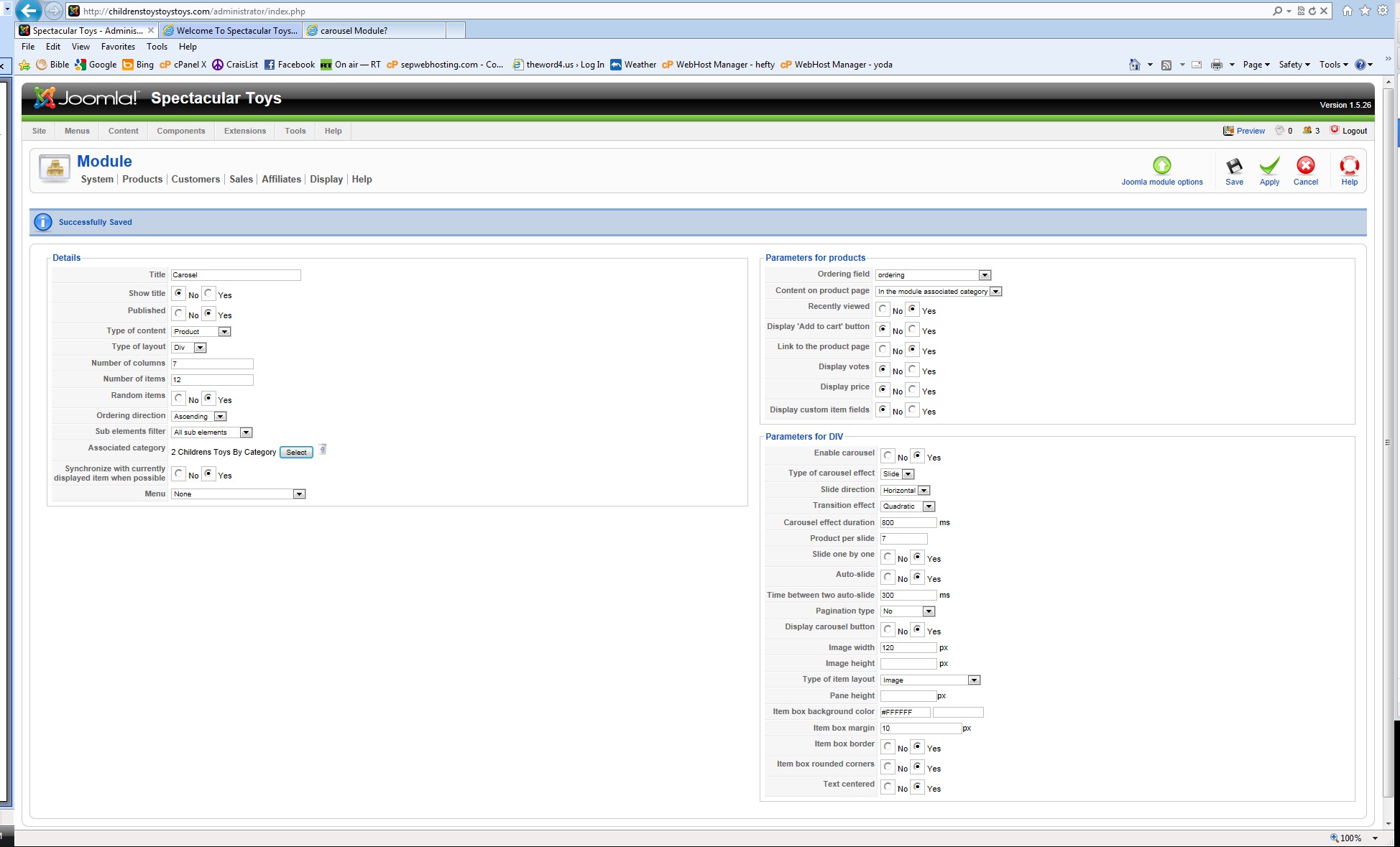

ok go look now at what happens new file attached also childrenstoystoystoys.com/

It's still not set properly. You have :
number of columns : 7
number of items: 7
products per slide: 12
I keep telling you that the number of items option should have a bigger number than the two others...
It should be:
number of items: 12
products per slide: 7

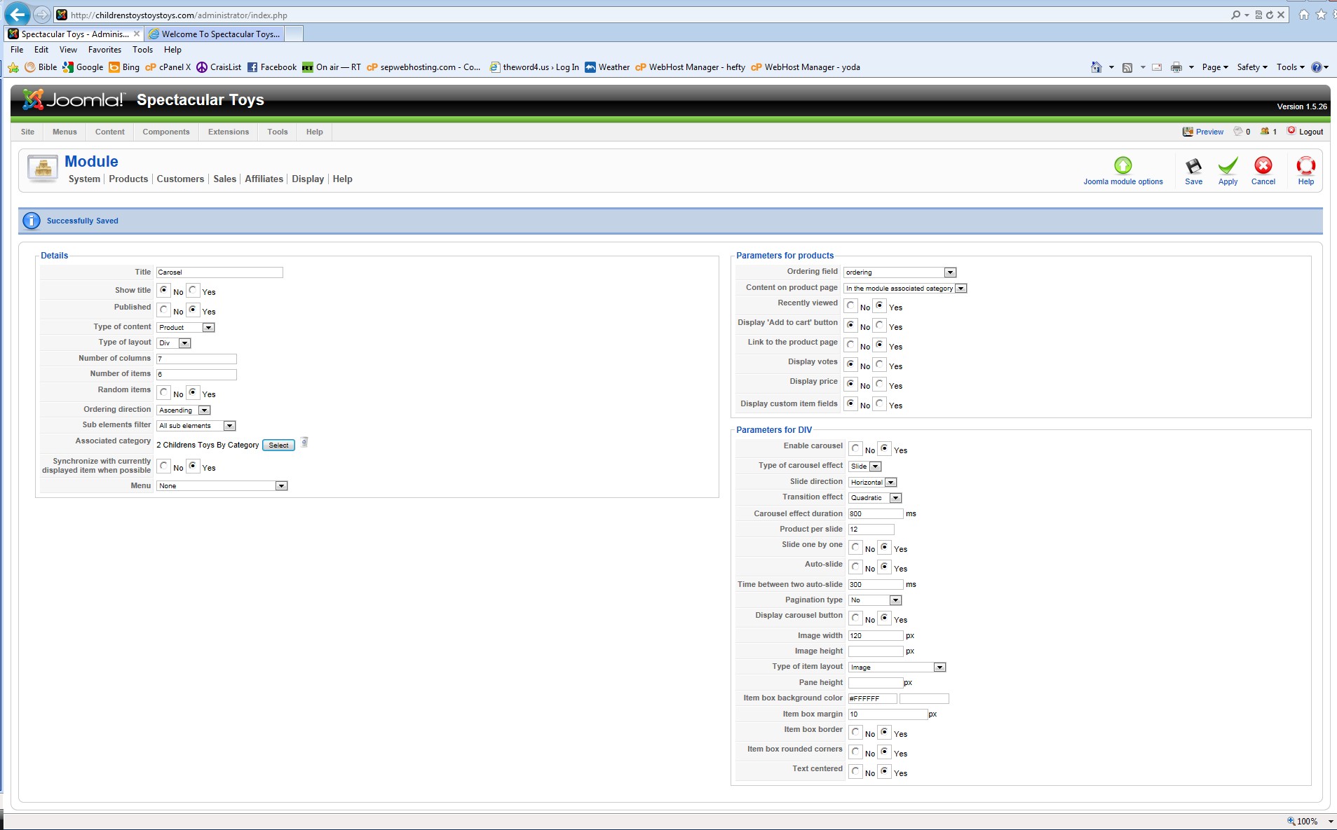

Is this correct? if it is still not showing up right. Sorry to be a bother :(

Yes, it's good now.
You just need to remove the CSS:

Your template CSS is interfering with the display of the carousel...
