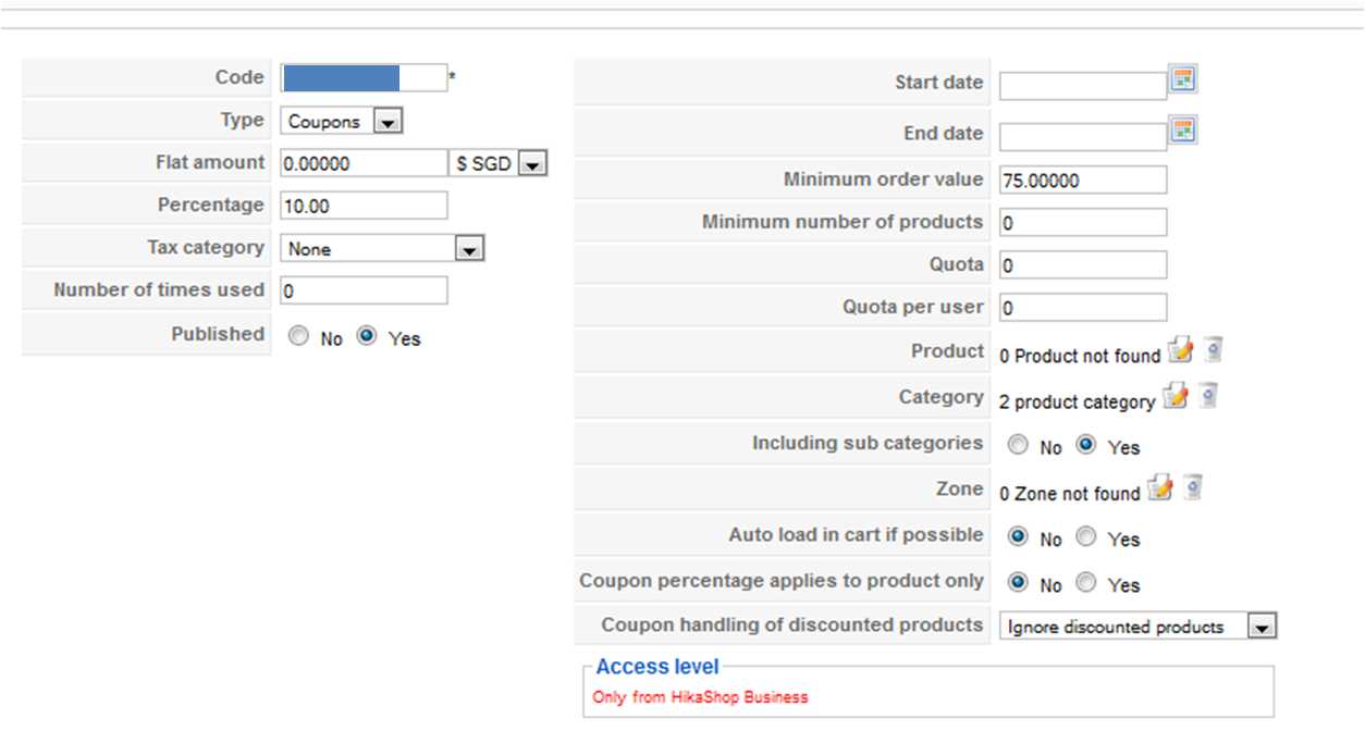

Could you do a screenshot of your coupons settings so that we can see what you did ?
  • Posts: 131
14 years 2 months ago #55017

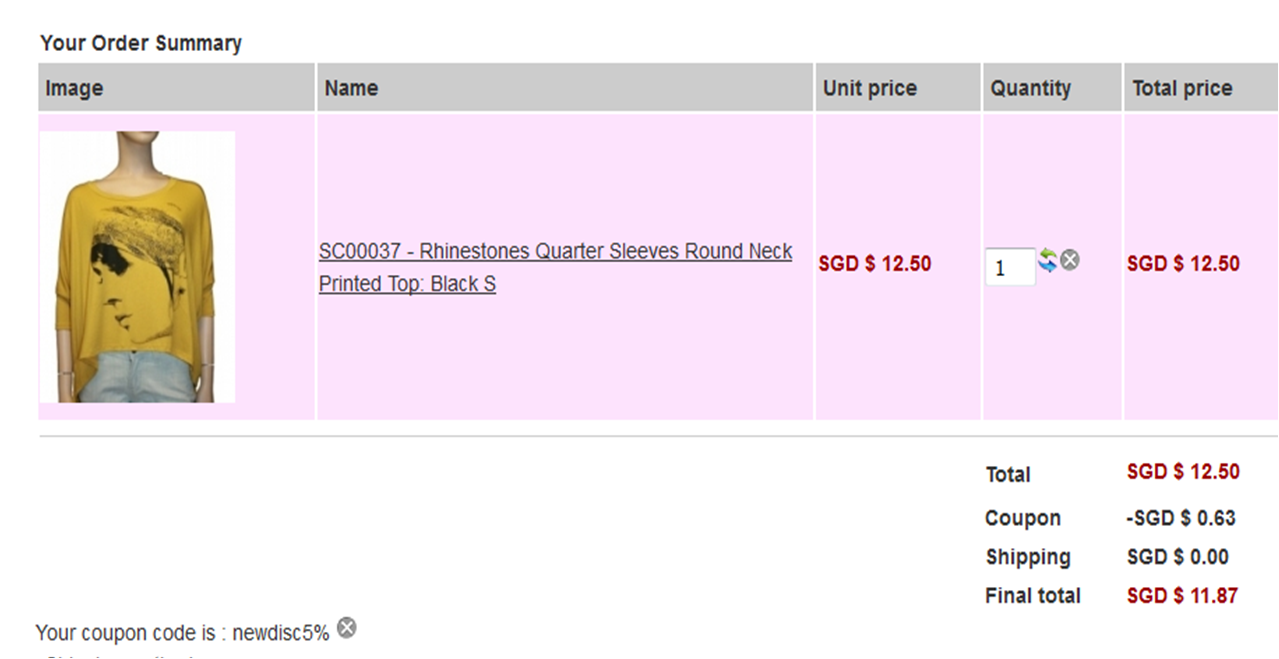

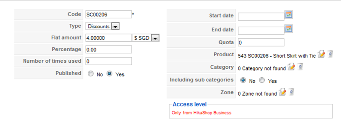

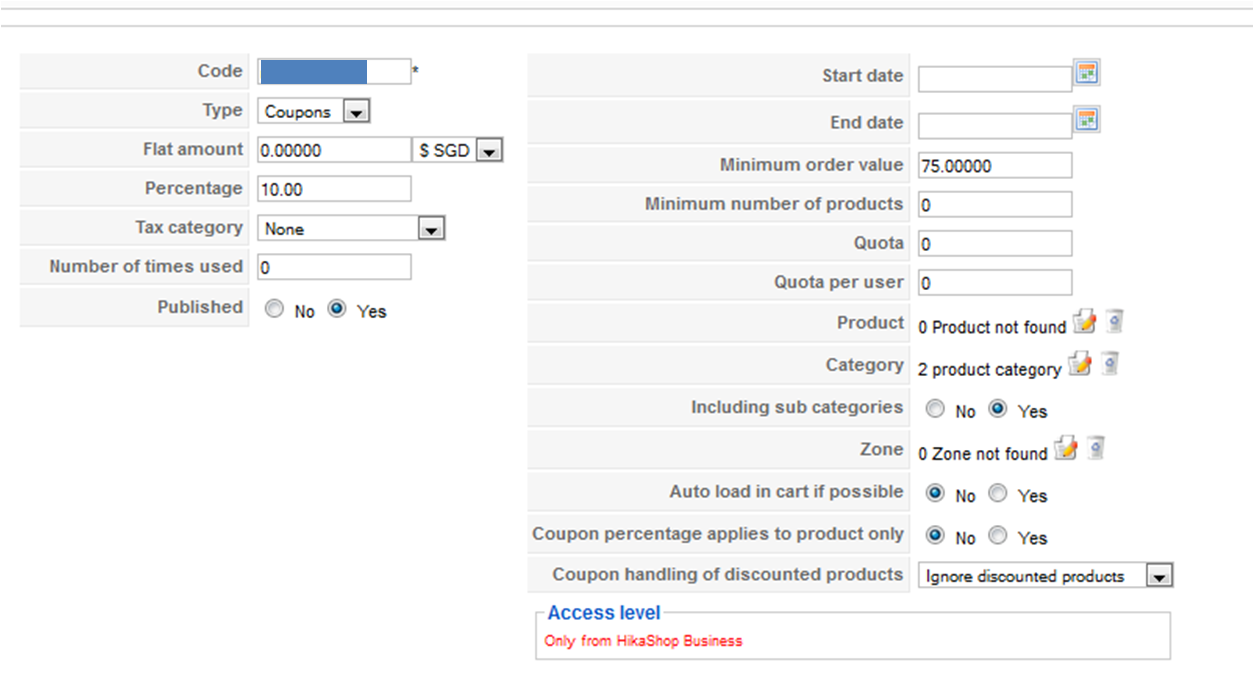

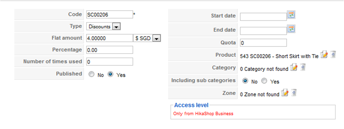

These are the screenshot of a coupon and a discount of one particular item:
Coupon (code has blocked
Discount
Thank you!

14 years 2 months ago #55073
I think that it's the normal behavior with the way you set your coupon.
Here are some examples:
// Coupon ignores discounted values
// (1) product prices less discount (coupon ignored)
// $100 product with 10% discount and 5% coupon - gives price of $90.
// (2) product prices less coupon (no product discounts)
// $100 product with 5% coupon - gives price of $95.
// (3) product prices less discount and no coupon value
// $100 product with 10% discount and 20% coupon - gives price of $90.
You are in case three: the coupon price is not important than the discount so the coupon is ignored.
You should either use 'Coupon reduced by discounted values' (where the discount would be ignored in case three) or 'Standard coupon behaviour' (where both the discount and the coupon would be taken into account).

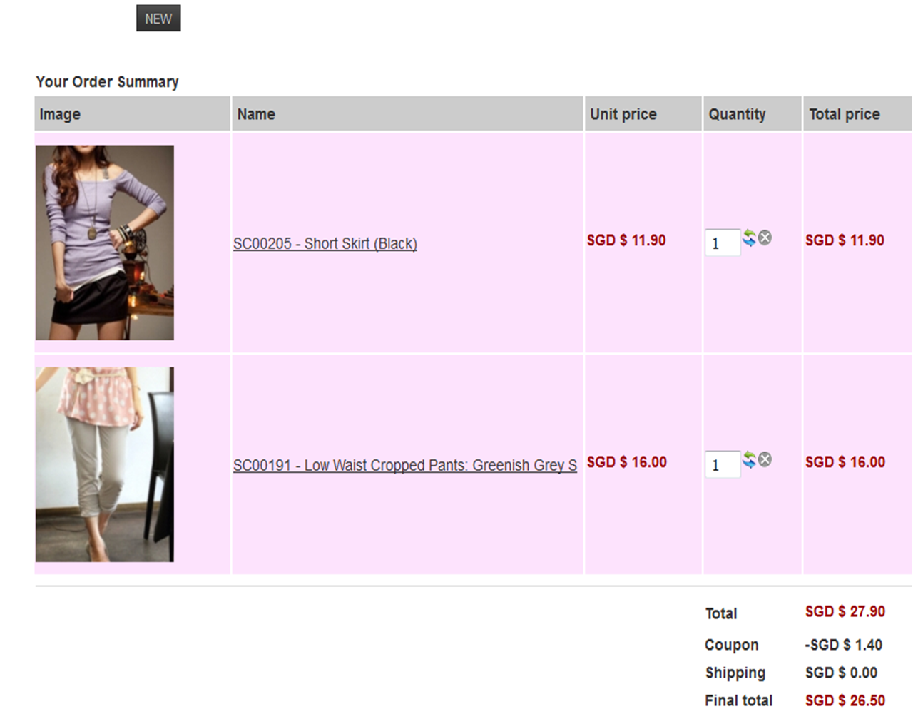

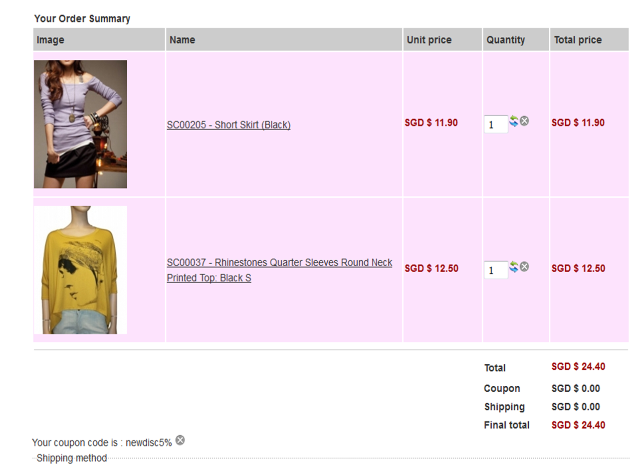

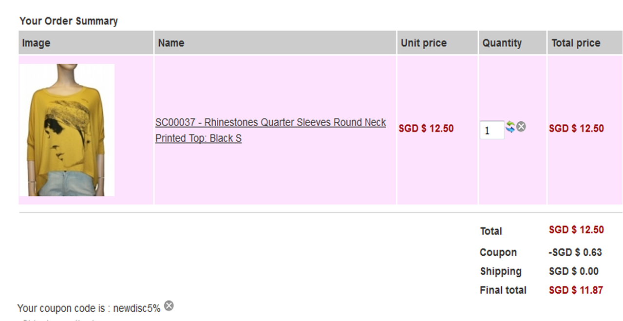

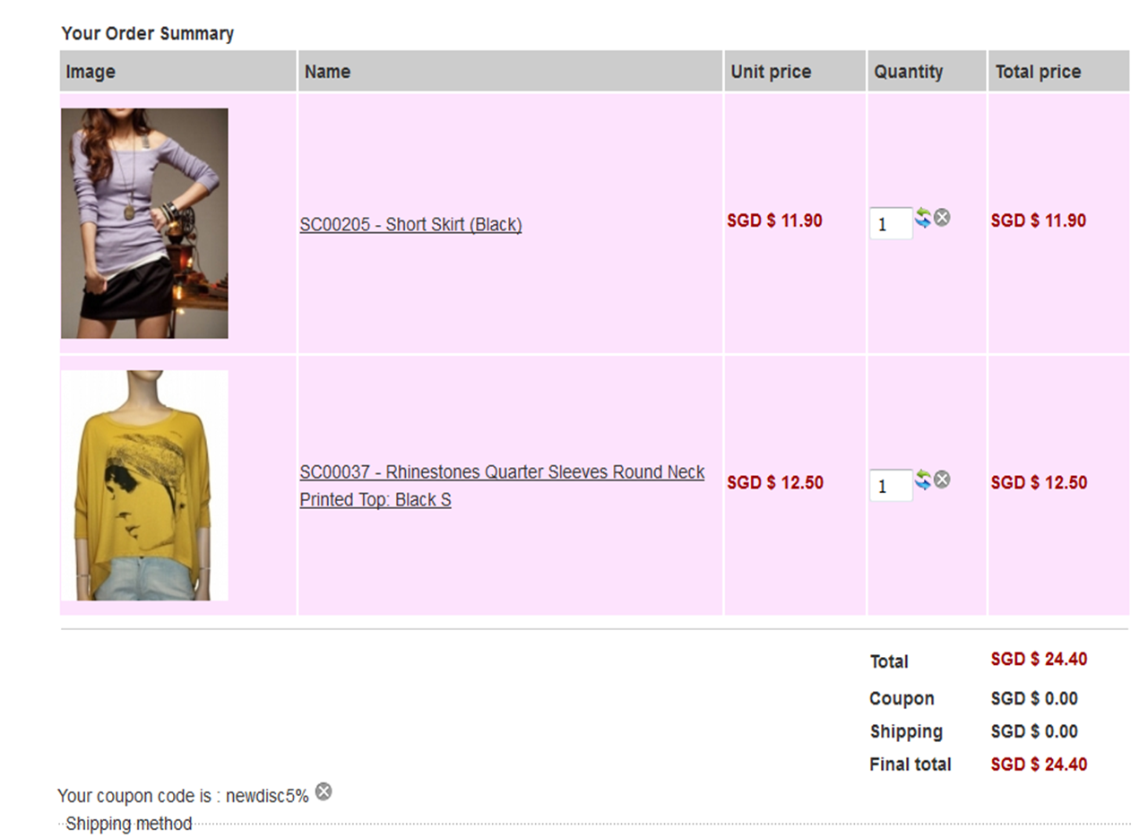

I tested all 3 types of behavious, found only 1st type working if a discount item added in the cart. It will add coupon value additional on discounted price. 2nd type and 3rd type don't works either if there is a discount item added in the cart, even there are some other item(s) not in discount, coupon will not work for all.
Example 1st image, coupon for a non discount item, it works:
After added a discount item (top one), both not work - no coupon discount either

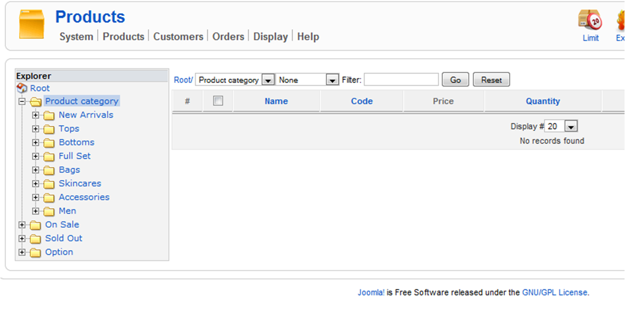

My coupon are apply to all categories, the individual discount item are also in these categories. But I have added these discount items in a separate "On Sale" category that the coupon not apply to it. Is this the issue?

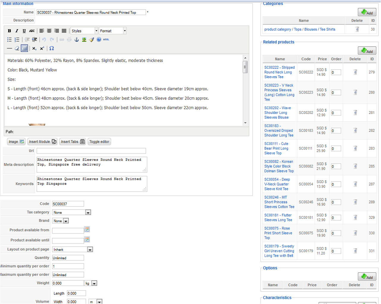

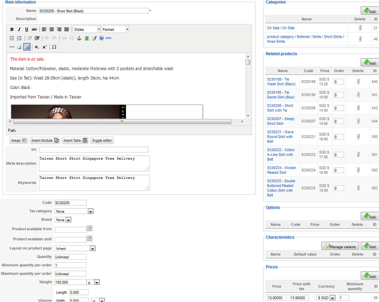

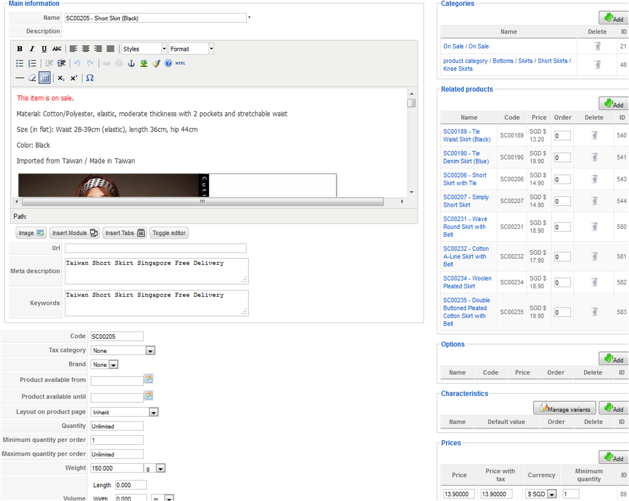

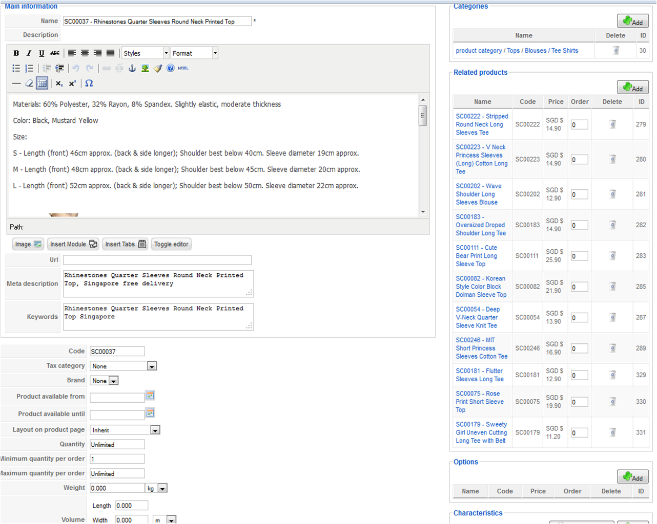

I screenshot both product pages (discount item and no discount item) and the category structure.
The coupon and discount screenshot has already in my 2nd post :)
(My screenshot for discount is for SC00206, not SC00205, but both with same setting. Sorry give a difference one!)

14 years 2 months ago #55231
The price of SC00205 is 13.9 and the discount SC00206 is 4. So the discounted price should be 9.9 but it's 11.9 in your screenshot of the cart. So it seems that the discounts don't have the same settings...
Could you check that and tell us what you have ?

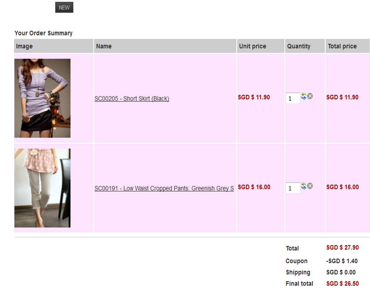

  • Posts: 131
14 years 2 months ago #55327
Just found another problem!
If it is set to 1st choice, standard behaviour, and apply only to "product category". I have set one on sale item (SC00205) in only "On Sale" category, that this category is not under "product category" and should not effected by coupon.
But if I add 2 items (1 in "product category" & 1 "on sale") in cart with coupon. The coupon will still apply to both items. Please see below (Coupon discount is 5%):
Thank you!
Last edit: 14 years 2 months ago by michael. Reason: Coupon discount is 5%
