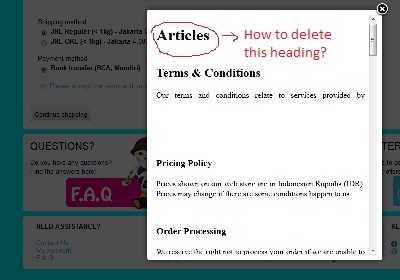

I have 2 problems :
1. I attach a picture to make it easier to explain to you.
During checkout, I set a terms and conditons where customer should agree upon it.
I set the article on the terms and conditons and put in the category of terms and conditions.
What I want to know, how to delete the header "Article" in the box of terms and contions?

1. I suppose that you could do that by hiding the title via CSS. We would need to look at the page on your website in order to give you the precise CSS code to use. Could you give a link ?

You can use such CSS on your website:
body.contentpane h1.title{display:none;}
You will have to add it to the CSS of your template and make sure that you turn off the CSS caching option in your template.

Hai Nicolas,
I found you thread at www.hikashop.com/forum/4-how-to/18604-qa...e.html?lang=en#18645
and when I apply it, it works!:)
