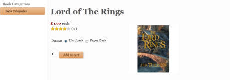

  • Posts: 55
14 years 2 months ago #55342
Ok I kinda got what i needed regarding the product_code. I was in fact using show_reverse to show my products so went into the file - I did notice it already had the code below, which makes me think that there is a button somewhere that will get the code to show automatically but I may be misunderstanding the code as im certainly not a developer.
<?php if ($this->config->get('show_code')) { ?>
<span id="hikashop_product_code_main"
class="hikashop_product_code_main">
<?php
echo $this->element->product_code;
But anyway i copied echo $this->element->product_code; and pasted it elsewhere just to see if I can get the code to appear which it did. My only problem with this is because the products have variations (hardback and paperback) when i click either of the radio buttons the product code then dissapears, so im assuming that once these buttons are pressed its then using a different php file somewhere.
So I guess my questions are now - is there actually a button somewhere that will auto insert my product code into the product listing and if not how can i get my pasted product_code echo line to appear when either of the variant radio buttons are pressed.

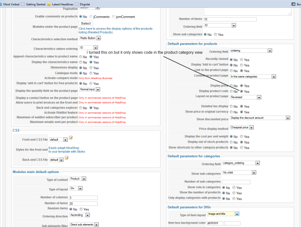

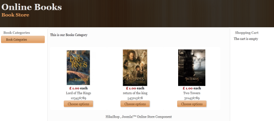

14 years 2 months ago #55436
Thank you for your reply - I had already ticked the show product code - which olnly seems to show the product code on the product category page and not on the actual product page. I have attached some images so you can see - it may be that I have some other settings i need to look at?
  • Posts: 180
  • Thank you received: 13
14 years 2 months ago #55443
It is on the page but set to not show in the CSS.
Add this to your template CSS:
#hikashop_product_code_main.hikashop_product_code_main {visibility: visible; display: inline;}
