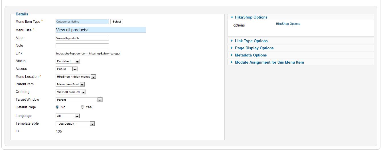

  • Posts: 25
14 years 2 months ago #56451
I use Joomla SEF system,
Here is the screenshot for the menu item 135
  • Posts: 86177
  • Thank you received: 14211
14 years 2 months ago #56516
Please turn off all the cache in Joomla:
Disable the cache in Joomla configuration.
Site -> global configuration -> system -> "Cache settings".
Disable, if it's enabled, a joomla cache plugin.
Check your template' options for a potential cache option and deactivate it.
That should help I think.
The following user(s) said Thank You: hamidre13
