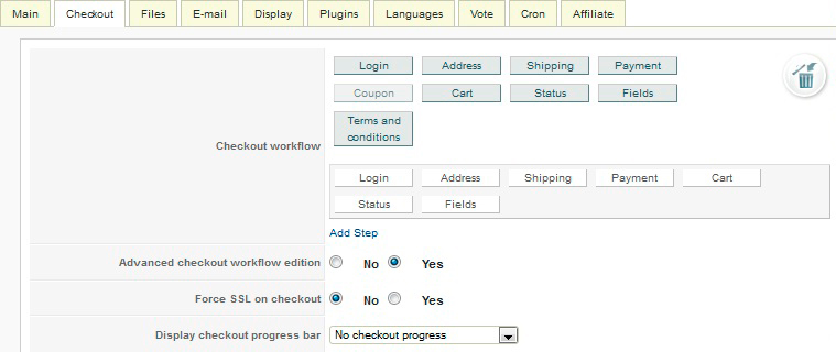

When I use the supplied HikaShop cart module to start my check-out process I get the usual Login/Register page, but under that is the cart contents.
This makes a very cluttered long page's worth of data that goes off the bottom of the screen.
Can I just have the Login/Register page on its own (if required), with a 'next' button to then give me the cart contents on a new page like there is on the HikaShop website when you purchase Essential or Business packages?

Yes. You need to change your 'checkout workflow' option in the Checkout tab of the configuration for that.

Thanks for that, but would you give more detail please on how to do it?
In my checkout tab, I can change the order of the items but that is all.
Thanks.

Click on "add step" and drag and drop all the views except the login view from the first step to the second one and then save the configuration.
