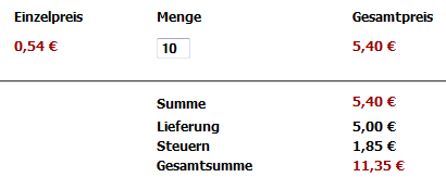

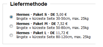

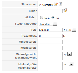

no, the other one has another problem. On his side the calculation is wrong but it shows right on the checkout screen. On my side the calculation is right but it shows the wrong price (without tax) on the checkout screen. I took some screenshots for better understanding.
This is what my shipping method in the backend looks like:
The price witout tax is 5,-€ and the tax here is 19%
This is what the shipping methode shows on the checkout page:
Here you can see that this is the price witout tax and I want the price with the tax.
And here you can see the calculation:
Here you can see that the calculation is right, but the shipping costs are displayed without the tax. And thats a problem in germany. Here you have to allways show the price with the tax included.

15 years 7 months ago #5708
Could you go in the menu Display->Views and edit the file shipping of the view checkout ?
There, change the code
if(bccomp($taxes,0,5)){
to
if(bccomp($taxes,0,5)==0){
That will display the taxed price when a tax is applied to the shipping price on the shipping selection view.
Then, in the same file, change the code
echo $this->currencyHelper->format($rate->shipping_price_with_tax,$rate->shipping_currency_id);
to
								echo JText::_('PRICE_BEFORE_TAX');
								echo $this->currencyHelper->format($rate->shipping_price,$rate->shipping_currency_id);
								echo JText::_('PRICE_AFTER_TAX');
That will display teh price of the shipping methods like this:
My shipping method 1 17,76 € (14,85 € without VAT)

15 years 7 months ago #5710
thanks, the first thing was enough, the second change is not needed.
to
But this time in the view -> checkout - cart
Thanks for all!
