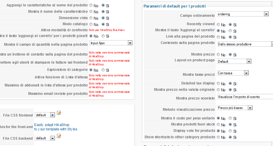

I think that you should :
- Go to "Hikashop->System->Configuration->Display"
- Set the Option "Display price" to YES
And it should work.
  • Posts: 82

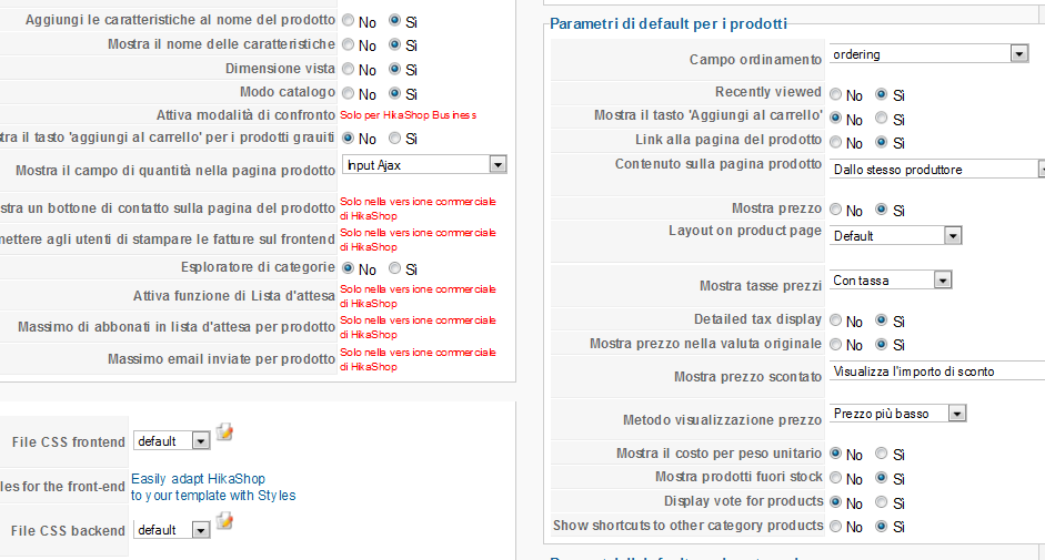

14 years 2 months ago #56449
you can see in my modoCatalogo.png screenshot that display price (mostra prezzo in italian) is set to yes but the price isn't shown on my 'bacio' product....

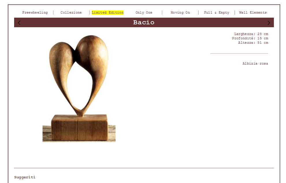

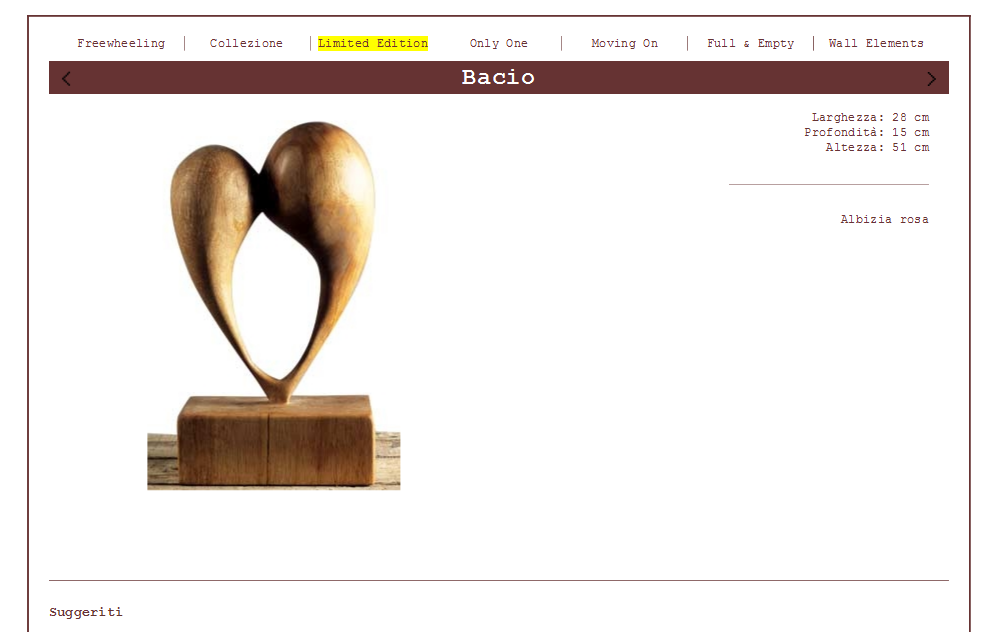

  • Posts: 82
14 years 2 months ago #56848
this is the link.

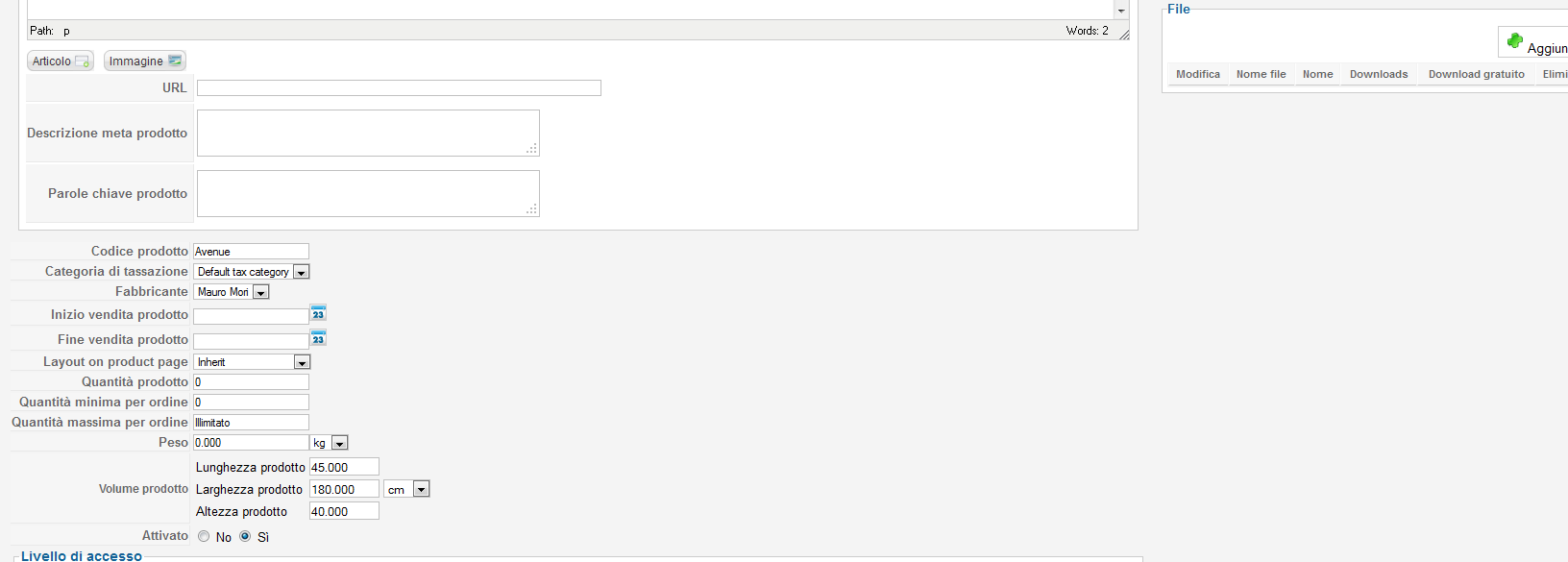

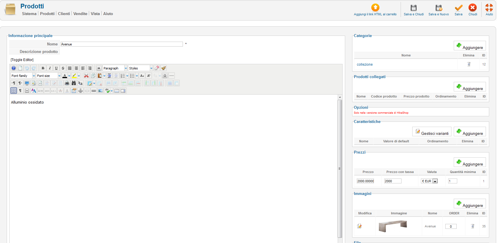

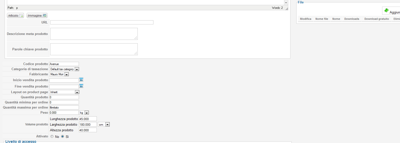

14 years 2 months ago #56855
I think that he wanted you to do a screenshot of your product page ("Hikashop->Product->'Your product'")

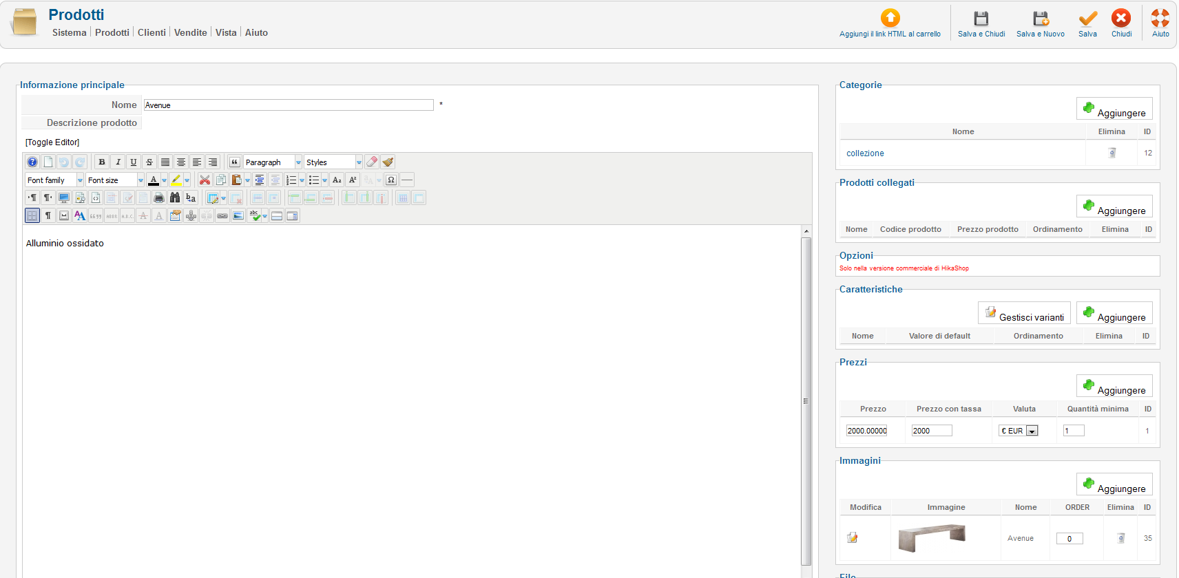

  • Posts: 82
14 years 2 months ago #56856
here they are!
thank you
14 years 2 months ago #56875
I think that your problem is coming from your CSS, so you'll probably have to remove the line :
.hikashop_product_price_full{display:none!important}
