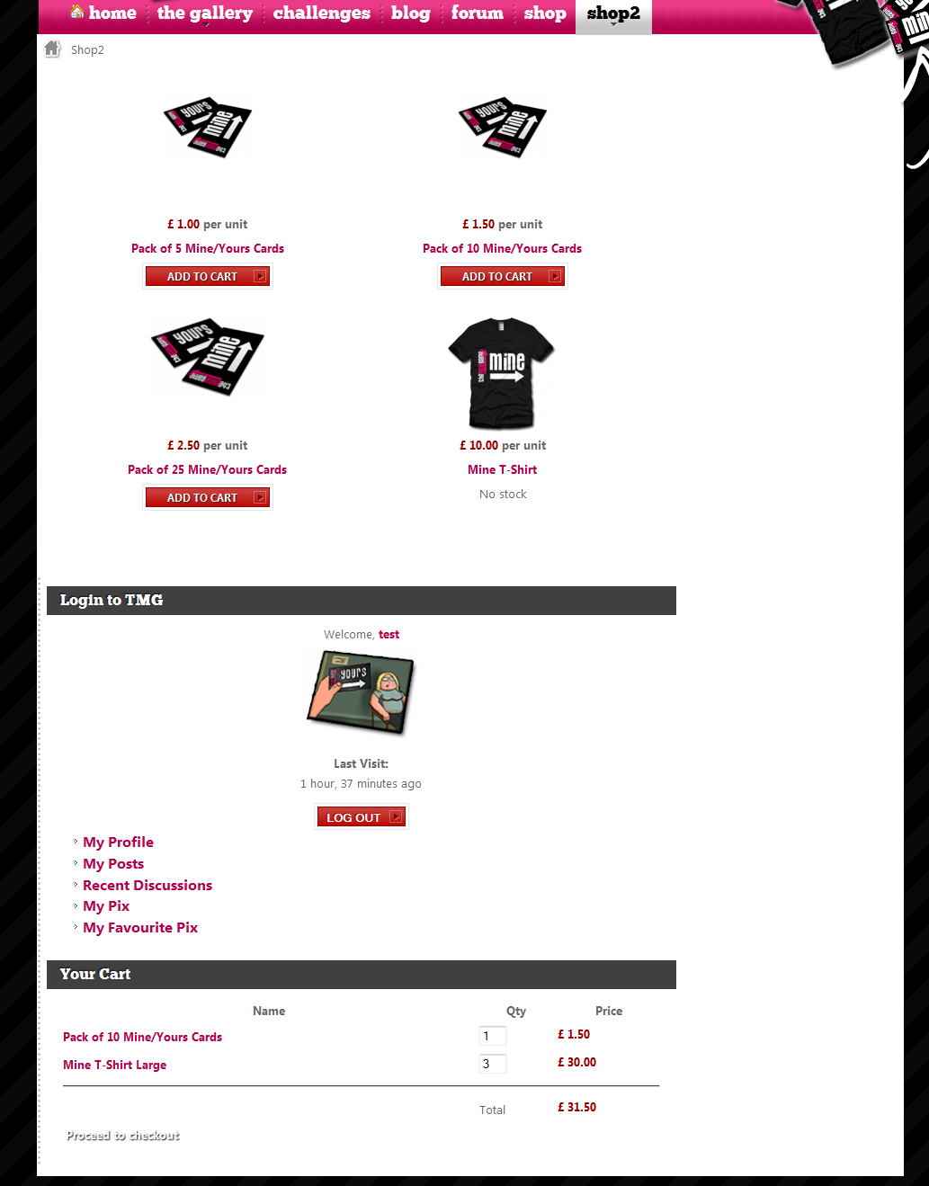

I have just tried a product with 0 stock to show the 'No Stock' message instead of an add to cart button.
The product showed correctly however it has broken my layout, with the sidebar now showing below the main content of the page (see screenshot - Login/Your Cart should be in right hand side bar).

  • Posts: 86183
15 years 8 months ago #5654
We just checked on our end and the HTML code when there is no stock is ok for us.
Could you provide a link to that page ?
