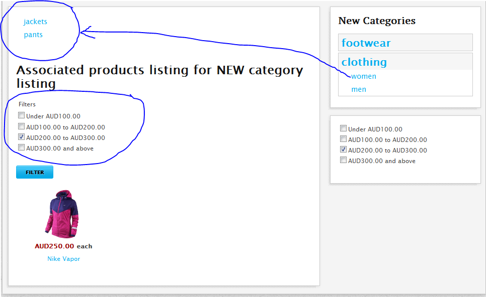

I have created a category listing in my site and it has 2 issues.
1. As per the screen capture attached, it displays the sub categories in the product listing, which I do not want
2. The filter module appears on the products listing section, again, which I do not want to happen
Can you please help me fix these issues.
Many thanks...

1. In the "menu" option of your category listing module, please select a products listing menu and not a category listing menu and it won't display the categories in the main area.
2. If you want to hide the filters on the main area of your page and only display the filters via the module, you can add such CSS (replace the X by the id of your menu that you selected as explained in 1.) in the front end CSS file of HikaShop via the Display tab of the configuration :
#hikashop_category_information_menu_X .hikashop_filter_main_div{ display:none; }

Thanks Nicolas, all good.
