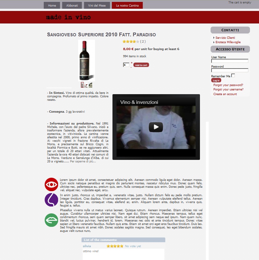

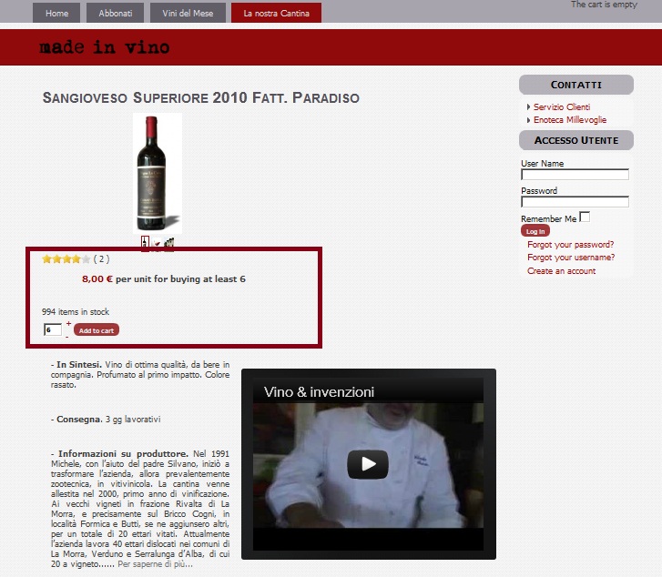

I use Joomla 2.5.6, Hikashop 1.5.8 and a template generated with Artisteer 3.1
My product page doesn't look very well.
Probably due to some space constraints (the product page has about 750/800 px) the "right part" goes under the "left part".
Is there a way to avoid it?
I would also to customize a little bit the product layout page in order to obtain this result (all the fields alligned on the left). Is it possibile?

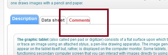

I would also like to know if is possible to view the comment in a separate tab?
Thank you so much for your help. :)

For the right area going under the image, you can look here:
www.hikashop.com/en/forum/4-how-to/48858...t-inconsistency.html
For the price alignement, you can look here:
www.hikashop.com/en/forum/2-general-talk...uct-detail-page.html
For the tabs, you will have to do something similar to this:
www.hikashop.com/fr/forum/4-how-to/52260...on-product-page.html

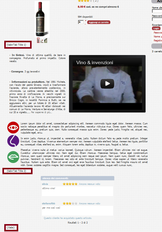

I was able to modify the first 2 things but I have some problem with the last one.
I modified the product / show_default.php as follow
<div id="hikashop_product_bottom_part" class="hikashop_product_bottom_part">
{tab=Tab Title 1}
<div id="hikashop_product_description_main" class="hikashop_product_description_main">
<?php
echo JHTML::_('content.prepare',preg_replace('#<hr *id="system-readmore" */>#i','',$this->element->product_description));
</div>
<span id="hikashop_product_url_main" class="hikashop_product_url_main">
<?php
if (!empty ($this->element->product_url)) {
echo JText :: sprintf('MANUFACTURER_URL', '<a href="' . $this->element->product_url . '" target="_blank">' . $this->element->product_url . '</a>');
</span>
{tab=Tab Title 2}
<?php
$this->setLayout('show_block_product_files');
echo $this->loadTemplate();
<div id="hikashop_product_vote_listing" class="hikashop_product_vote_listing">
<?php
if($this->params->get('show_vote_product')){
$js = '';
$params = null; //Params already existing in the previous getLayout('vote', ...)
echo hikashop_getLayout('vote', 'listing', $params, $js);
</div>
<div id="hikashop_product_vote_form" class="hikashop_product_vote_form">
<?php
$js = '';
$params = null;
echo hikashop_getLayout('vote', 'form', $params, $js);
</div>
</div>
i also modified the product / show.php as follow
<form action="<?php echo hikashop_completeLink('product&task=updatecart'); ?>" method="post" name="hikashop_product_form" enctype="multipart/form-data">
<?php
$this->setLayout($this->productlayout);
Old code - Stefano
echo JHTML::_('content.prepare',$this->loadTemplate());
but unfortunately it doen't work, did i miss something?

I would say that the problem is that the second view file modification you made (in product/show.php) was not for the correct template. Could you double check that ?

You didn't install and publish the tabber plugin:

I apologize, I hadn't done the most important thing... :blush: :blush: :blush:
Thanks a lot

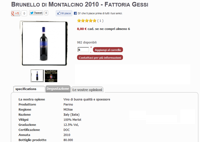

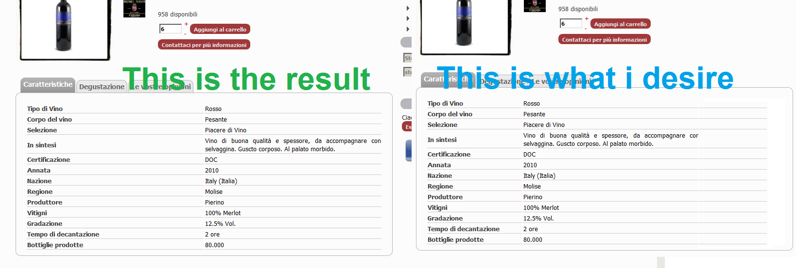

do you think is possbile to move the "specificatons fields" to a separate TAB?
Could you indicate what piece of code I have to move/change?

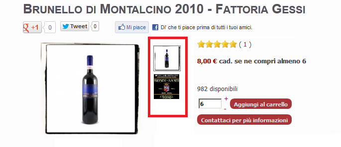

Could you also indicate if is possible to move the small product image at the right of the main picture?
Thank you
Last edit: 14 years 3 weeks ago by Teto.
  • Posts: 86080
  • Thank you received: 14186
14 years 3 weeks ago #59799
That's the code used to display the specifications area in your view file :
if(!empty($this->fields)){
$this->setLayout('show_block_custom_main');
Just move it inside your tab tags with potentially <?php and ?> tags around it and it will be in the tabs.

14 years 2 weeks ago #59893
Thank You!!!
I did it, I also had to move that part in the bottom area B)
<?php // Stefano Start - Le 5 righe di cui sopra sono state spostate qui ed è stata aggiunta la stringa per abilitare la TAB?>
<?php
?> {tab=Caratteristiche|grey} <?php
<?php // Stefano End ?>
I'm falling in love with Hikashop!!! :laugh: :laugh:

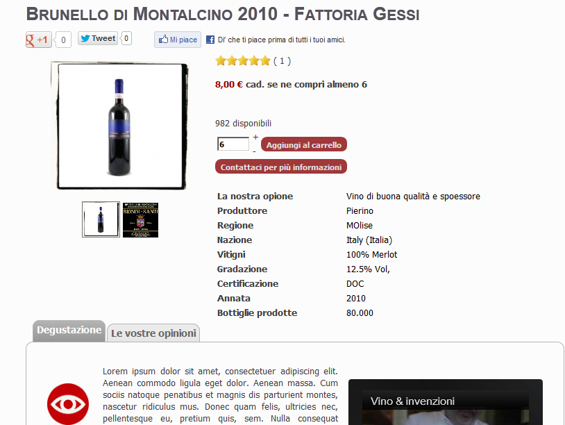

Do you know if is possible to move the small picture of the product to the right of the image? (see my previous message).
Thanks as usual! :cheer: :cheer:
Last edit: 14 years 2 weeks ago by Teto.
  • Posts: 86080
14 years 2 weeks ago #59975
You can do that with CSS. You might need to adapt the values a bit but you should be able to do it with that CSS:
.hikashop_main_image_div{
width: 60%;
float: left;
.hikashop_small_image_div{
width: 20%;
float: right;

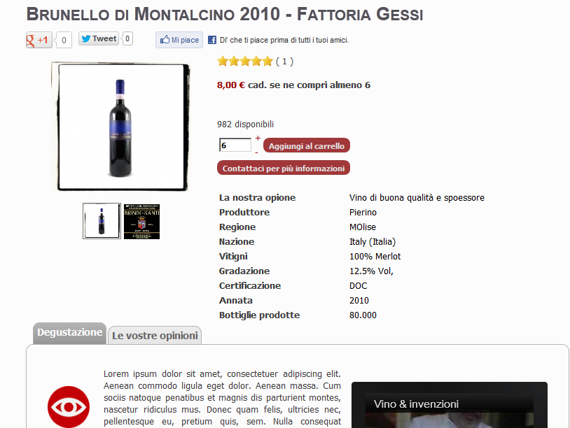

  • Posts: 184
  • Thank you received: 4
14 years 2 weeks ago #60055
Great!!!!! :laugh: :laugh:
I swear this is my last question...

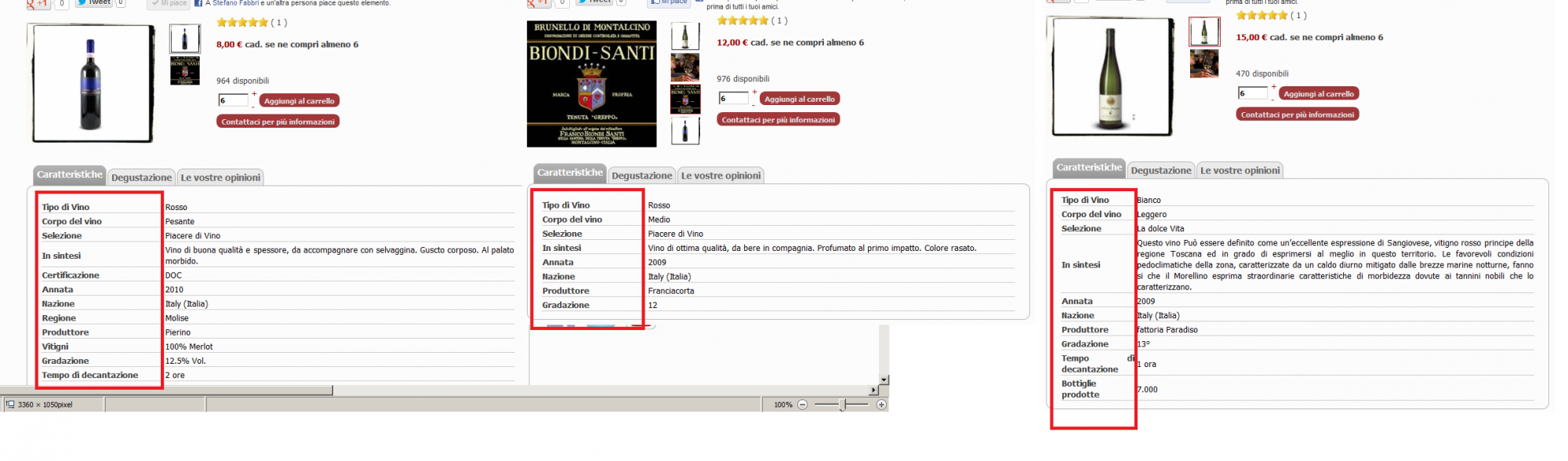

how could I set a fix width for the name of the custom fields?
I tried to insert a margin in .hikashop_product_custom_name but the space is different between the varoius products
.hikashop_product_custom_name{
font-weight:bold;
/* Stefano Start */
/* Spazi per caratteristiche */
margin-right:50px;
/* Stefano End */
I would like to have the same width and different height depending on the content of the relative field.
  • Posts: 86080
14 years 2 weeks ago #60126
I think that you should use something like that CSS:
#hikashop_product_custom_info_main td.key{ width 100px; }

14 years 2 weeks ago #60158
Thank you, unfortunately it works only partially.
when you set a width the system automatically splits the table in 2 parts of the same width.
I tried to increase/decrease the pixels and also to use the % but it isn't possible to set the left part and the right part with different width.

  • Posts: 86080
14 years 2 weeks ago #60308
You added the CSS:
#hikashop_product_custom_info_main td{
border-bottom: 1px solid #CCC;
width: 100px;
but I told you to add:
#hikashop_product_custom_info_main td.key {
width: 100px;
That's why it's not working like you want.
