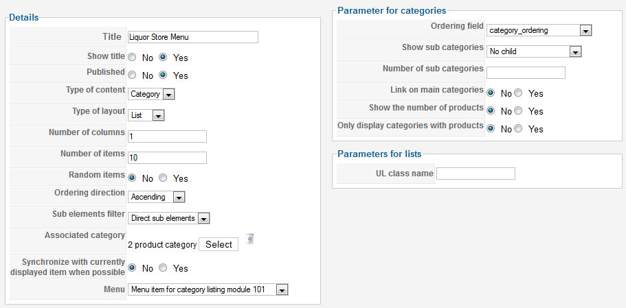

Hi setup a content module, put it in position 5, configured it like below.
My issue is, I have 4 primary categories, beer, wine, spirits & Ciders, under a couple of those, they have sub categories. I added at least one product to one of the categories for testing.
It displays the main 4 categories correctly. If I click on any of the 4 main categories, it tries to load a page and gives a 404 error? Like if I click on beer it tries to load beer.html etc
I was expecting the categories to open up and display the sub category and by clicking on the main categories, it would load / display all products in the main category.
Where have I gone wrong?

Hi, I found the option to enable links on the top level categories in the Accordion menu, sub categories link fine without SEF, main give 404's. I removed the suggested code to test that, no difference.

14 years 2 months ago #57240
Hi bluetonguedesigns,
You need to set the "menu" option in your module's hikashop options.
http://www.hikashop.com/en/forum/3-bug-report/13786-hikashop-content-module-and-sef-urls-gives-404.html#13786
