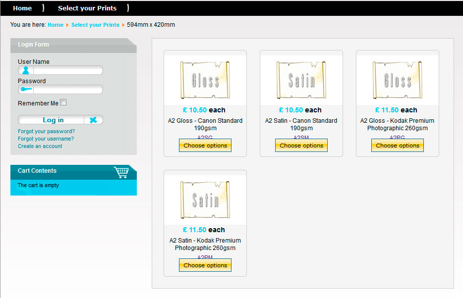

I am using the Hagane template.
When the user selects a product category from the main menu they are presented with 4 products.
When they select one of these an actual product checkout page is then displayed.

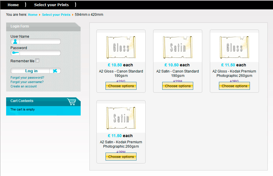

I don't need the 'Choose Options' button, as the user will select the product variation on the next page.
How to I suppress the 'Choose Options' button display, or if I can't, move it down a little?
I would like to present this page with two columns (not 3), but I cannot find anywhere to do this?

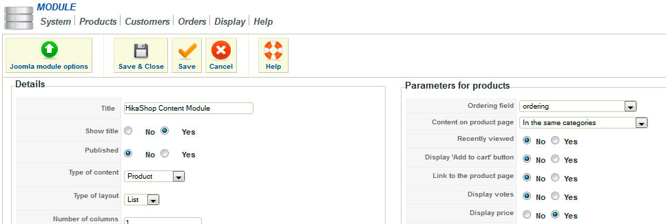

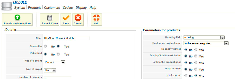

Go in your products listing module's hikashop options (via the menu Display->Content modules) and turn off the "show add to cart button" option.
  • Posts: 74
14 years 2 months ago #57500
Thanks for the information.
However nothing happened.
I think I changed the correct module, but the 'HikaShop Content Module' is not even published in my set-up.
Thanks.

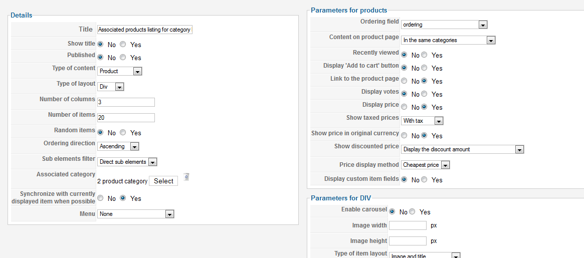

  • Posts: 74
14 years 2 months ago #57502
I also had a Content Module called 'Associated products listing for category listing menu 123' which I don't remember creating.
When I set the 'Add to cart' to 'No' here, that did the trick.

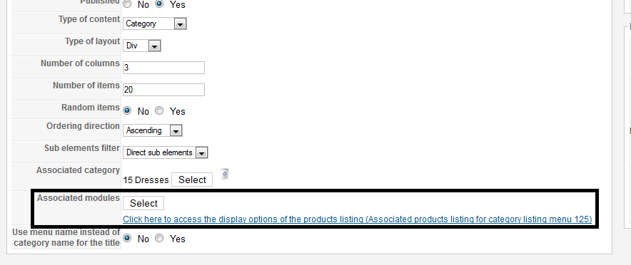

  • Posts: 17
14 years 1 month ago #57561

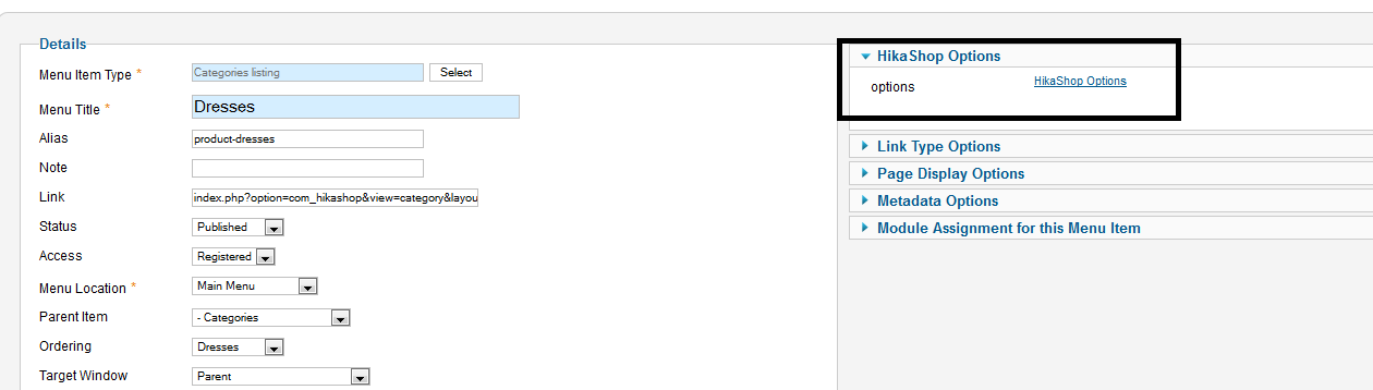

I had that same problem 2 days ago and I see the solution

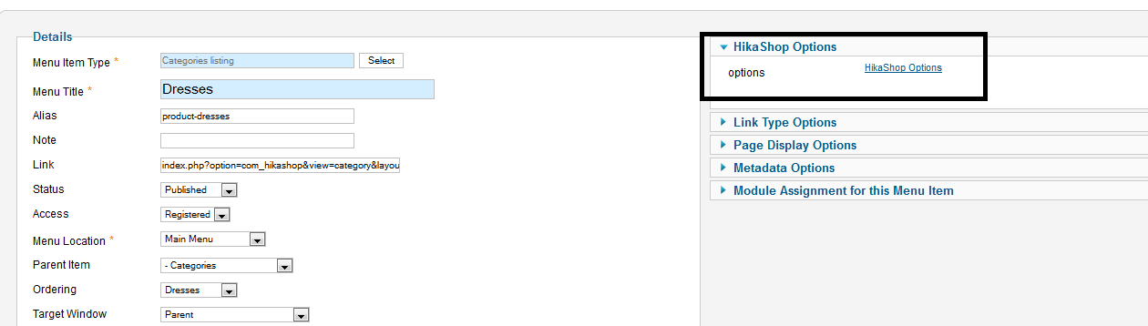

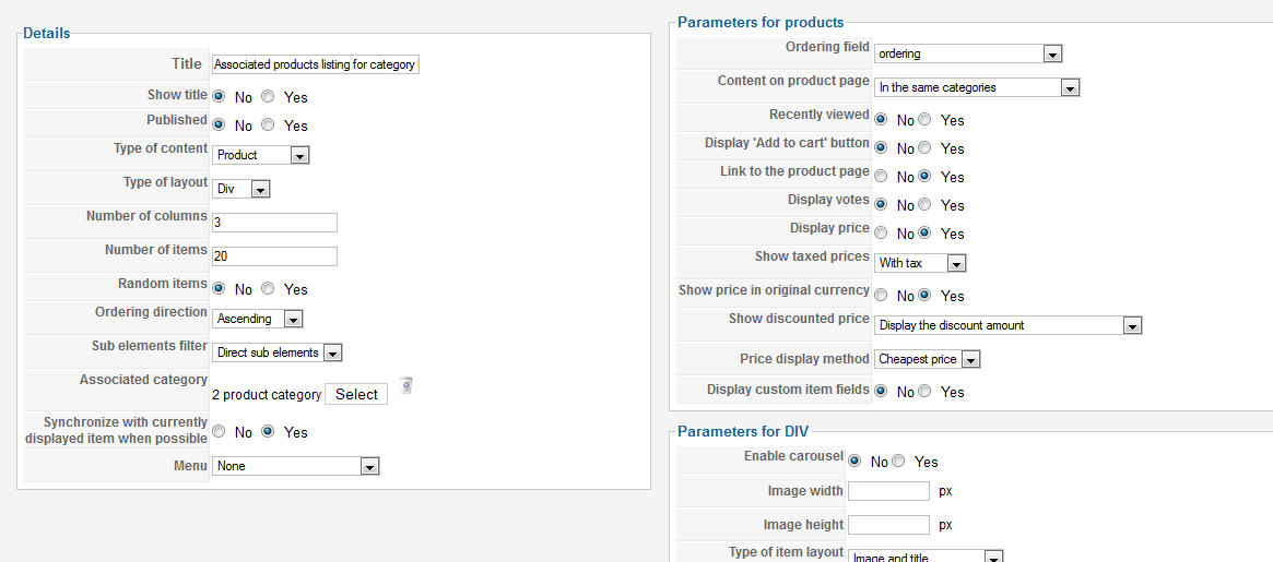

go to menu manager - edit that category menu

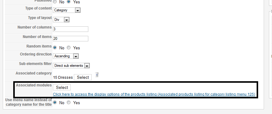

1. select hikashop options
2. after that look for the associated modules~ the one with click here to access the display options etc..
click that to epen.
3.the nu3.png is the setting i'm using I think I set the add to cart button to - NO
then save refresh page to see changes hope it works for you i'm using hikashop business edition
  • Posts: 17
14 years 1 month ago #57562
and for the 2 columns change the div column size into 2 or whatever you prefer

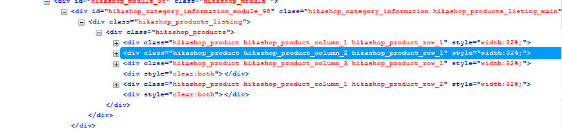

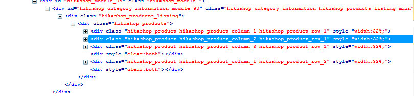

Using FireBug I can change the width (see screen shot below) from 32% to 48% and remove the first '<div style="clear:both></div>' to achieve what I want, but I cannot find which .php file generates this, so that I can permanently change it.
Thanks.

  • Posts: 86176
  • Thank you received: 14211
14 years 1 month ago #57792
You don't need to do that via the code.
You can just change the "number of columns" option from 3 to 2 in the options of your menu/module as Yuji explained.
Looking at your HTML, you need to edit the module with the id 98 via the menu Display->Content modules and change the "number of columns" option there.

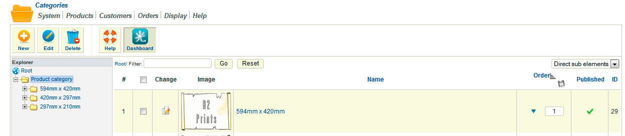

  • Posts: 74
14 years 1 month ago #57835

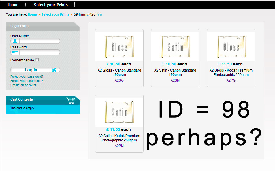

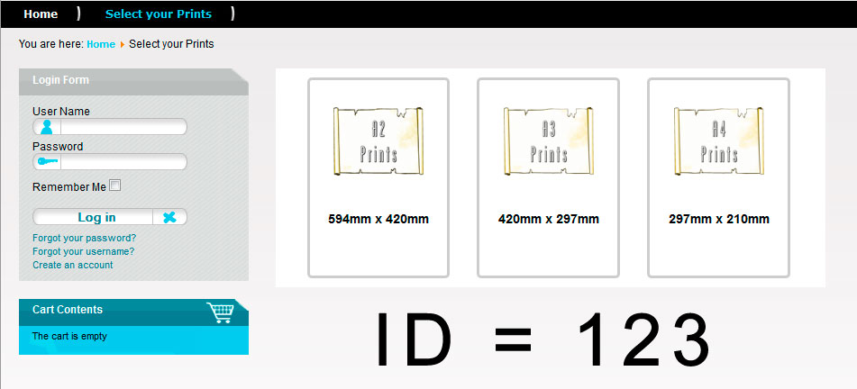

I think I may have set up my website incorrectly, as I can't get access to anything with an ID of 98.

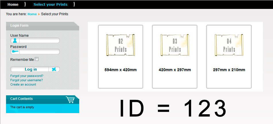

From my main menu I have Categories Listing item (ID 123) called 'Select your Prints', which yes I can change the number of columns.
However this page needs to stay at 3.

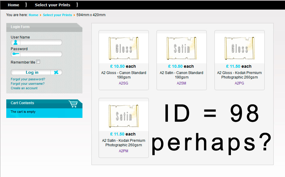

From 'Select your Prints' the user can pick one of three items (each containing 4 products), say they pick '594mm x 420mm' (ID 98 perhaps?), and it is this page I want to change to 3 columns from 4, but there seems no option to do this.
Thanks.

Can you do a screenshot of your Display->Content modules menu and give a link to that page so that we can see that ?
  • Posts: 74
14 years 1 month ago #57942

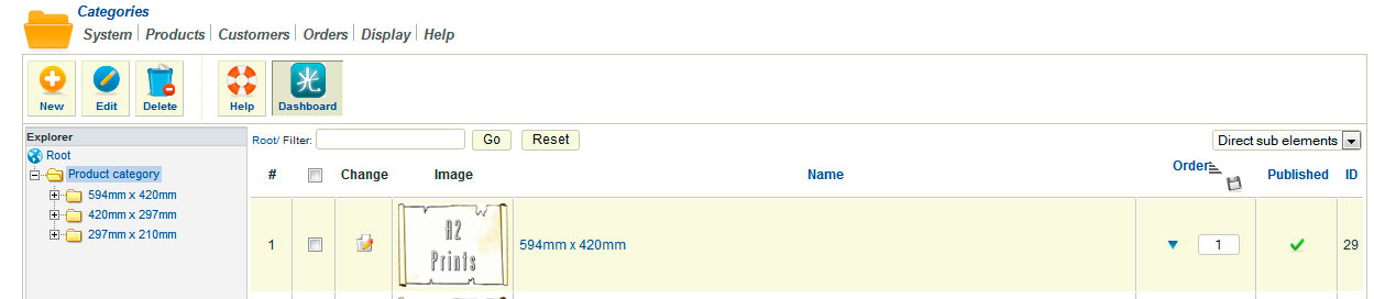

I don't know how you do it, but when I was in the process of producing a Display->Content modules screenshot there was ID 98, so I have managed to fix it myself.
