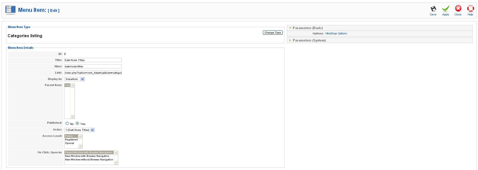

Here are several screenshots of the settings for the menu and the module. If you go madhatterrgames.com and click any of the titles under the Dark Horse listing they all go to the same Category page instead of taking me to a page with the Sub Category listings of just that title.
madhatterrgames.com/images/menu_type.jpg
madhatterrgames.com/images/menu_settings.jpg
madhatterrgames.com/images/associated_modules.jpg
madhatterrgames.com/images/module_settings.jpg

The problem is that you're using the same module for the listing of categories and as an associated module of your sub categories listing. You should create a new categories listing module which need to have the synchronize option active and the type of content as product, and then you can use that module as an associated module of your menu.
