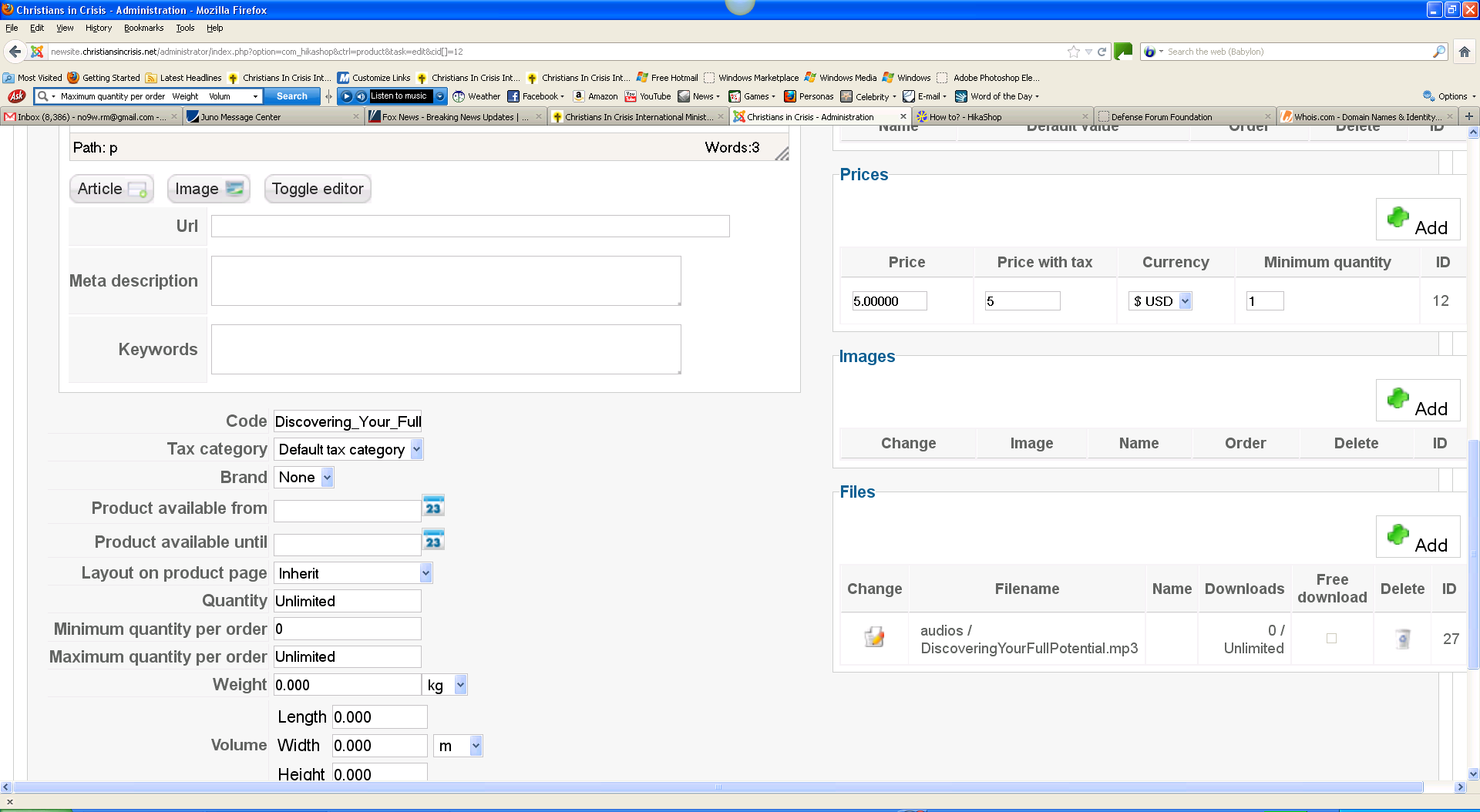

  • Posts: 30
14 years 1 month ago #57893
I'm on a different computer and got the screenshot to work! Maybe this will help? I don't think I changed the config on the upload safe folder.
Actually, all I entered in the product file area was 'audios/DiscoveringYourFullPotential.mp3' because I thought since it is in the control panel in the 'audios' folder that was all I needed. That is how I did it the very first time with the wrong folder, when it worked.
Thank you so much for your patience and help!
  • Posts: 86176
  • Thank you received: 14211
14 years 1 month ago #57951
You entered audios/DiscoveringYourFullPotential.mp3 so it means that the file needs to be in the folder:
media/com_hikashop/upload/safe/audios
if you want to have them in the folder audios of your website, you should either enter:
http://newsite.christiansincrisis.net/audios/DiscoveringYourFullPotential.mp3
or
/home/user/path/to/website/audios/DiscoveringYourFullPotential.mp3 (you will have to replace /home/user/path/to/website by the absolute path of your website).
