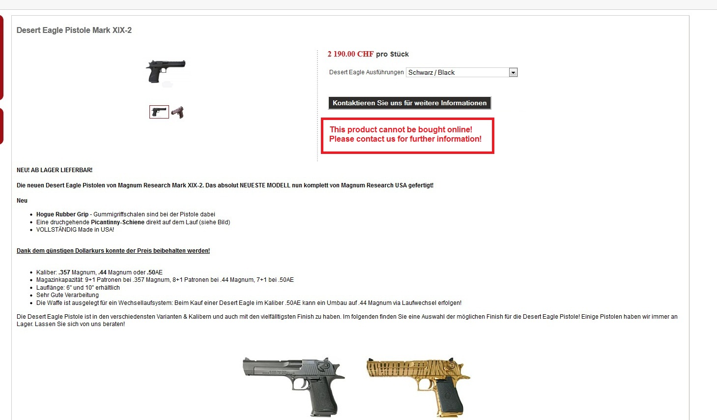

What I planned is: I just create a new product layout page and assign this new, adapted product page to the corresponding items (like guns and ammunition). I would copy the existing default page layout which is very nice and change the following things:
- Remove the "Add-to-Cart"-function
- Add a hint-text (red with a red square around it): "This product cannot be bought online! Please contact us for further information!" or something like that (please find an example in the attached pic).
- Out-of-Stock message (since I don't need a Stock for these items)
