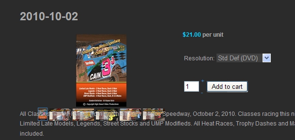

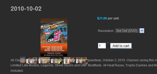

  • Posts: 242
15 years 7 months ago #6220
Nicolas,
Your code changes fixed my problems, but 1.4.4 broke them again. I thought maybe changes in 1.4.4 were conflicting with the suggestions offered in this thread, so I took them out, but there is still a problem. Sample image attached.
Ed

  • Posts: 242
15 years 7 months ago #6238
Nicolas,
Once you are logged in this page should display the problem (same as screen shot above). Also note how the row of thumbnail images jumps up when the Resolution option is changed.
Hoping to get this shop live soon and add it to your showcase thread! Still need to do some work on email messages though.
Thanks,
Ed
  • Posts: 86177
  • Thank you received: 14212
15 years 7 months ago #6239
I think that it is because the thumbnails were resized based on a height of 170px, but you changed the thumbnails height to 150px later on without deleting the thumbnails folder in media/com_hikashop/upload. So the calculations on divs height made by HikaShop are based on that 150px but your vertical image which is 170px height is bigger, thus the problem.
Deleting the thumbnails folder so that HikaShop can recreate the thumbnails based on the new height setting should solve the problem.
