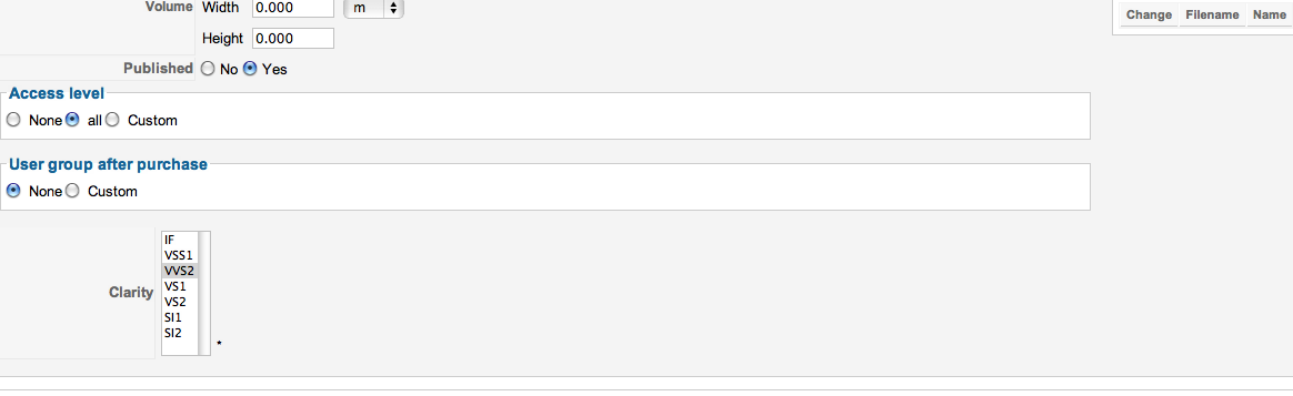

14 years 12 hours ago #58566
Ok, so i think i am getting close. I created custom field. Then a filter. Then I go to the product and to bottom of the back-end product page and see the custom field with selections. HOWEVER, only one custom field is showing up (clarity). The others are not showing up (cut and color). ????

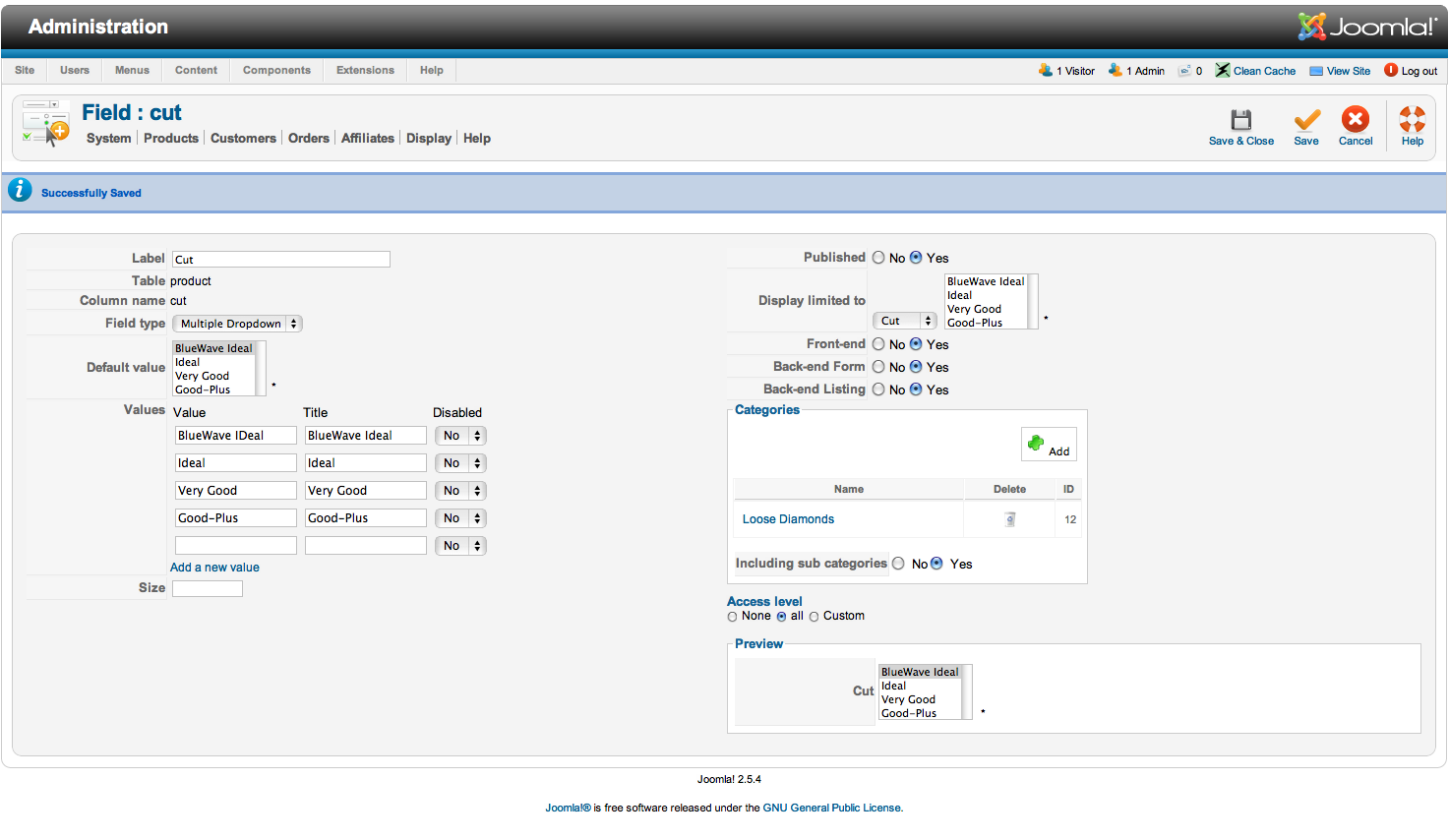

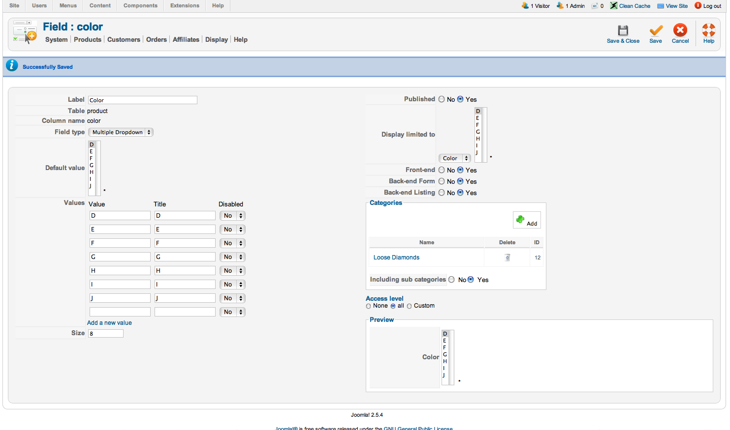

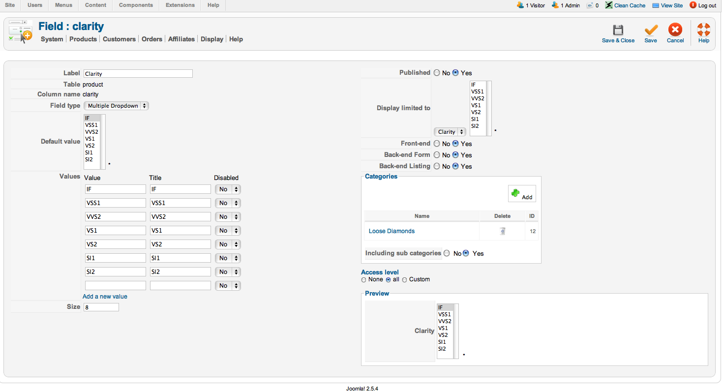

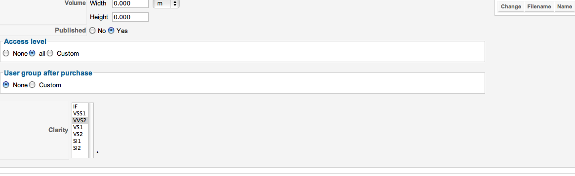

13 years 11 months ago #58714
I have attached three screenshots. First one is the options for "color" which is not appearing in the product page. The second is for "clarity" which is working well and appearing on product page. And third is the bottom of the product page where the selection can be made on back-end for each product.
  • Posts: 51
  • Thank you received: 4

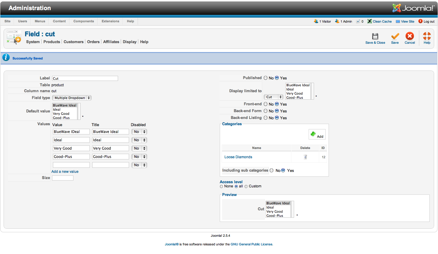

13 years 11 months ago #58715
the field for "cut" is also not showing up. I have attached a picture for this also (just like color that doesnt show).

13 years 11 months ago #58770
In your custom fields, please set the option "display limited to" to "all" and then try again.
  • Posts: 51
13 years 11 months ago #59002
whoops. nevermind.
ok, got everything working. very well put together system. ! thanks for help!
I just needed to do a few things, including designate a pixel size other than 0 , also.
