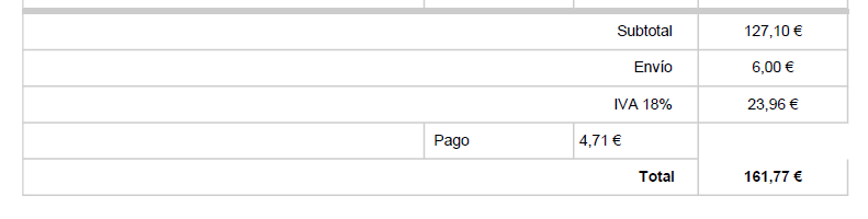

Hi Nicolas. I've uninstalled and installed the plugin again and it works, but text and quantity of paypal tax appears in other column than they may appear. I attach image.
Thanks.
  • Posts: 85950
  • Thank you received: 14139
13 years 11 months ago #58908
Ok, I fixed that. Please download it and install it again.
  • Posts: 107
13 years 11 months ago #58910
I had invoice.php customized to my layout, so I've changed the code in the file by this one:
