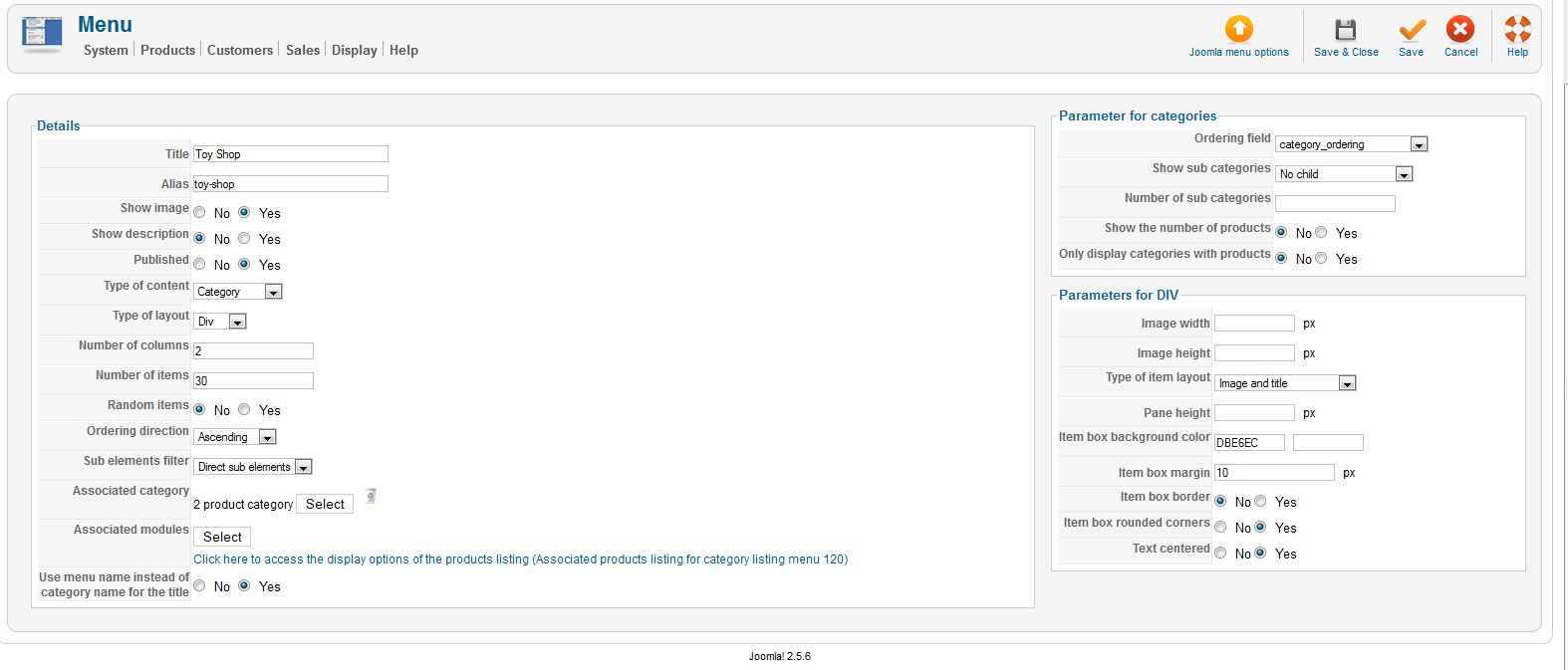

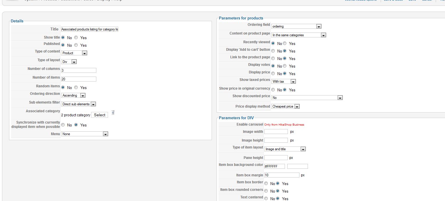

Thanks for your reply. I can see how removing the text from the category menu options works... but this also removes the text from the product menu where I really need a desscription. I am not that familiar with CSS although do have a limited knowledge of how to alter colours etc... do I add the css code you kindly provided at the end of the backend CSS in Hikaship or after the other lines that start with .hikaship?
Your help is much appreciated.
I have attached screenshots of my menu options page and also the associated products option page.
One more query I have is - is there a way to make the images on the individual product information page larger?

1. Both the category listing and the products listing of the category listing menu use the same option. So you can't have image displayed at the top for some categories and not for others.
2. At the end of the file is fine yes.
3. For the product page image, you can change the "product page image height/width" options of the Files tab of the configuration.
