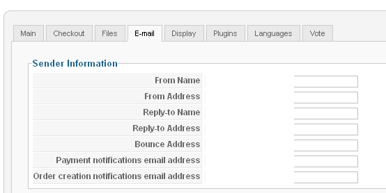

System > Configuration > E-mail
I don't see where you can unpublish the email. Do you mean to leave the "Order creation notifications email address" blank and an email will not be sent?

The Email tab of the configuration screen is something else which allows you to configure the sending settings of emails.
The System->Emails menu which allows you to fine tune each email of HikaShop is only in the Business edition.
