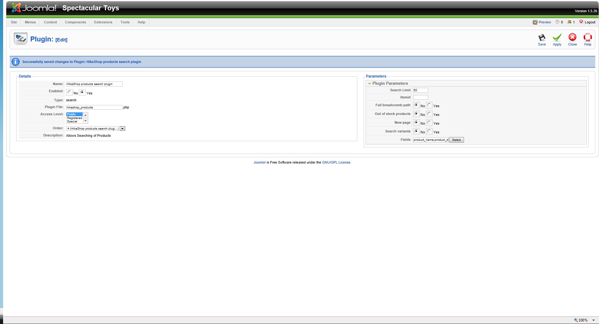

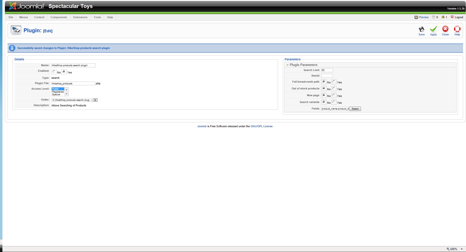

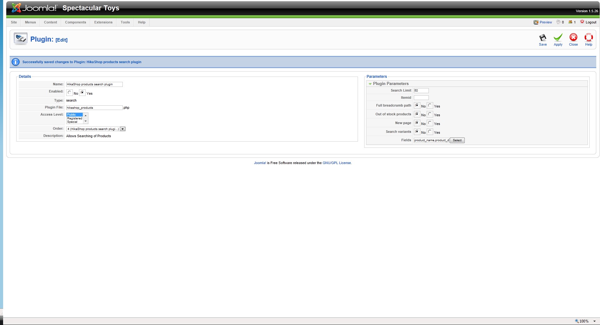

Hi Nicolas here is a screen shot of the search plugin and how its set. when you search childrenstoystoystoys.com/index.php/comp...ng=&searchphrase=all the items still pop up in a new window ie9
Dave
  • Posts: 85949
  • Thank you received: 14139
13 years 11 months ago #60023
It's working fine for the products results. No new window opens.
It does it only for categories results. I suppose that you didn't turn off the "new page" option of the category search plugin.

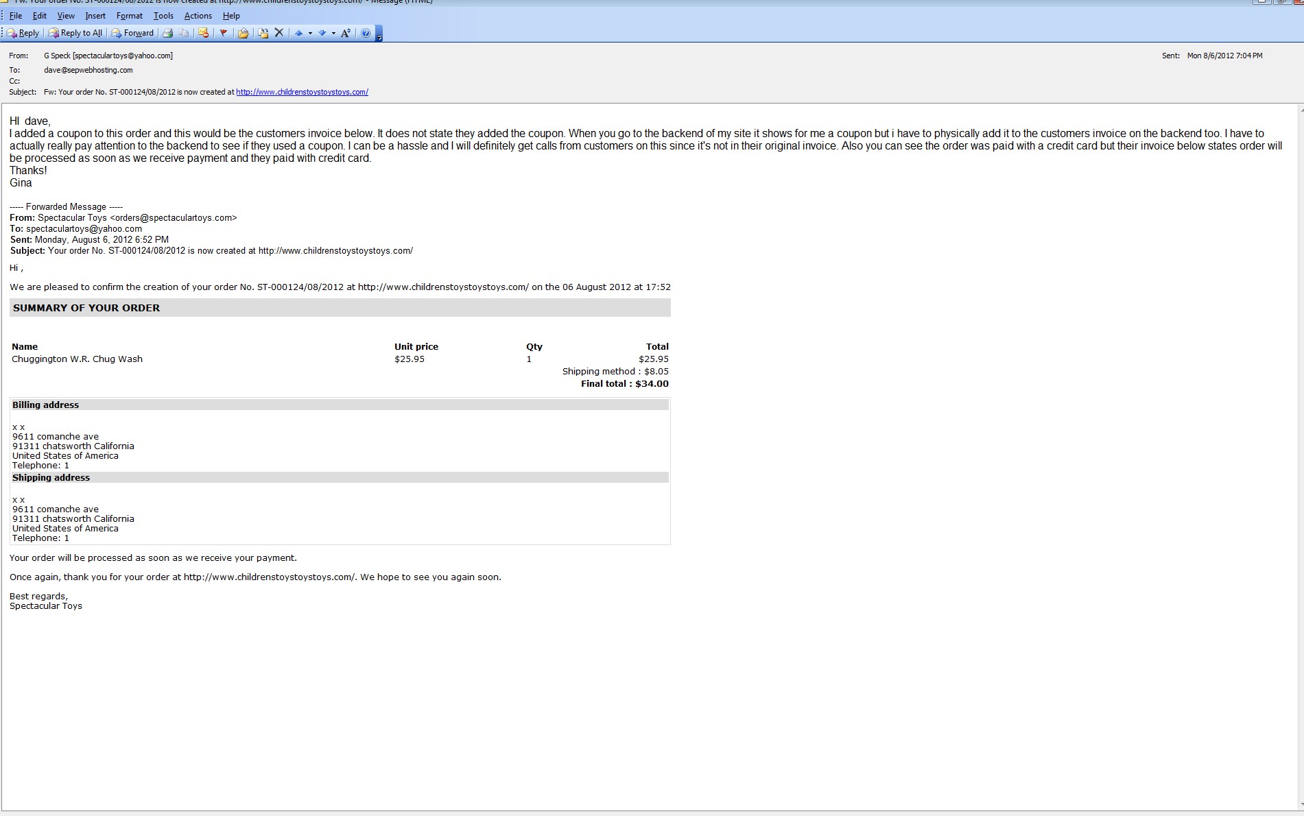

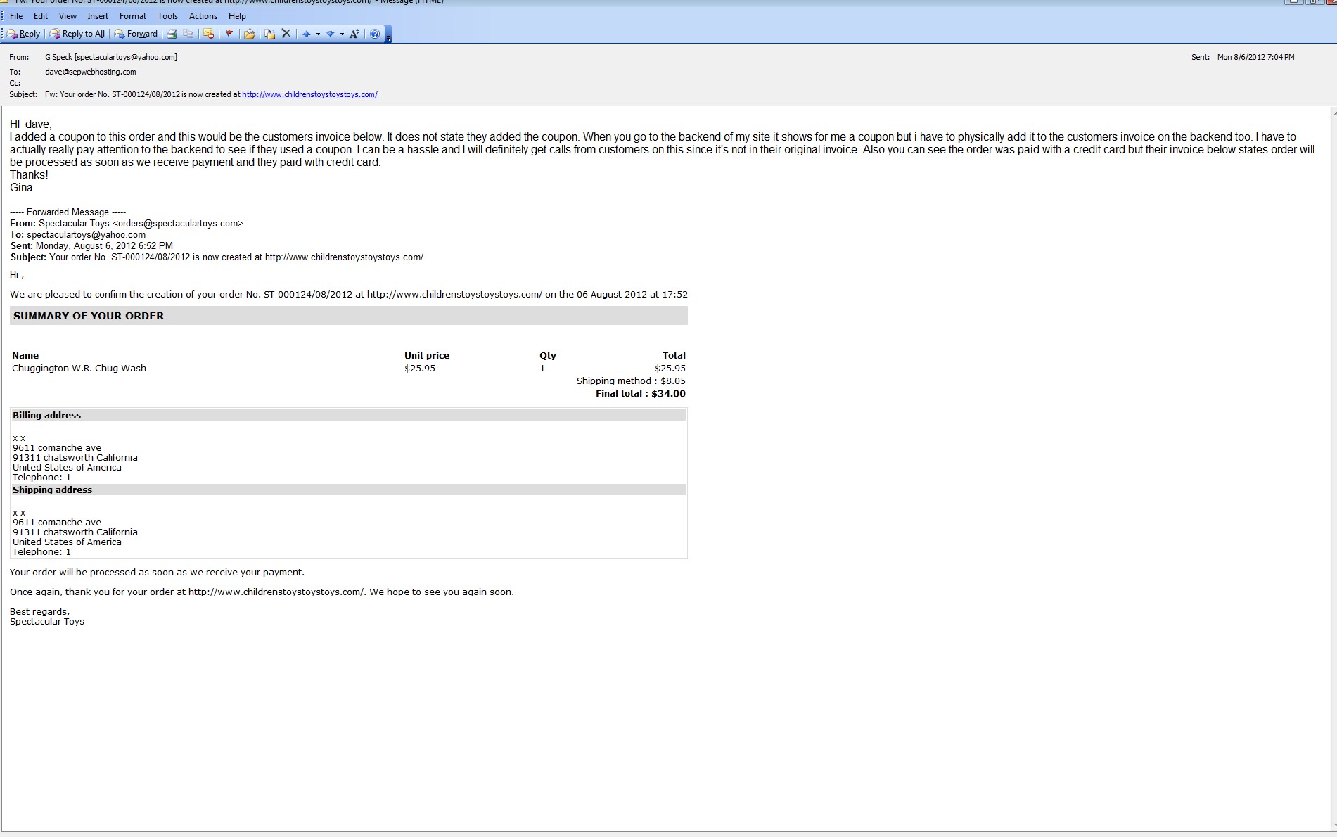

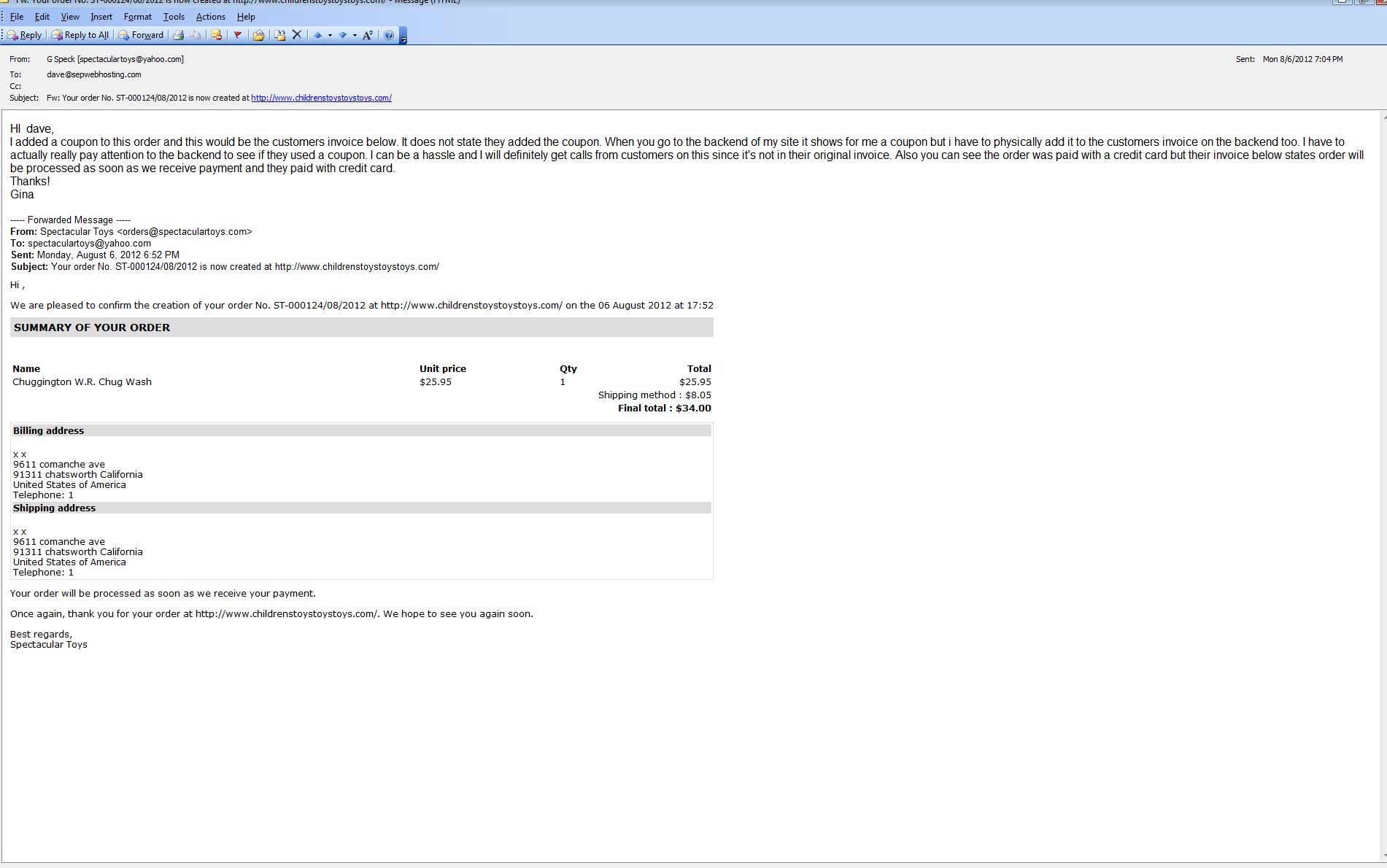

Here is a copy of a customer invoice and the coupon is not on it. Also I need to know how to get rid of the line that says "Your order will be processed as soon as we receive your payment" if someone uses a paypal we have already received their payment.
Dave
Last edit: 13 years 11 months ago by davemalton.
The following user(s) said Thank You: SpectacularToys
  • Posts: 85949
13 years 11 months ago #60363
We don't have that problem on our end.
Can you give a link to your shop and the code of a coupon so that we can try it ?
Also, did you change anything in the email ?

13 years 11 months ago #60557
Hi davemalton,
As I can see on the invoice, the coupon is not applied, the product price + shipping fee = total price.
Does the customer entered the good one coupon ?
Can you tell me in wich zone can be used the coupons ?

13 years 11 months ago #60632
Hi SpectacularToys,
When I try you coupons, they are added with success, but the coupon value is $0.
When the coupons have a value set on 0, they are not added in the invoice, because they are detected as null.
Try with coupons having a value > 0.
