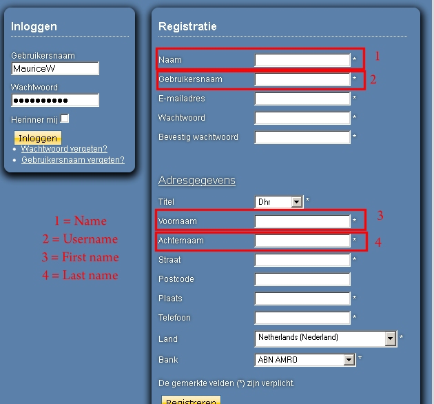

Please see the attached image. Whe a user registers, he/she is asked several times for a name.
1. Name
2. Username
3. First name
4. Last name
First name and last name (3 & 4) with the address is okay.
Username (2) is also okay.
Buy why is Name (1) asked? Where can I remove this?
Thank you,
Maurice

The name at the top is the name of the user.
The first/last name in the address area is for the address.
They might not always be the same.
You can remove the code
<tr class="hikashop_registration_name_line">
		<td class="key">
			<label id="namemsg" for="register_name">
				<?php echo JText::_( 'HIKA_USER_NAME' ); ?>
			</label>
		</td>
			<td>
				<input type="text" name="data[register][name]" id="register_name" value="<?php echo $this->escape($this->mainUser->get( 'name' ));?>" class="inputbox required" maxlength="50" /> *
			</td>
	</tr>
from the file "registration" of the view "user" via the menu Display->Views if you want to remove the first name field. It will be filled automatically with the address first/last name.

14 years 1 month ago #59985
That was it. Thanks!!! :)
