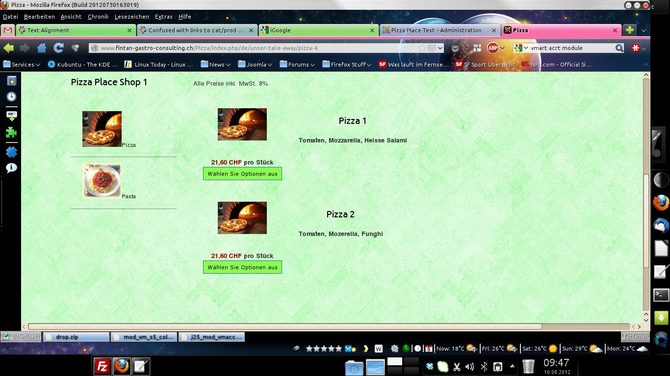

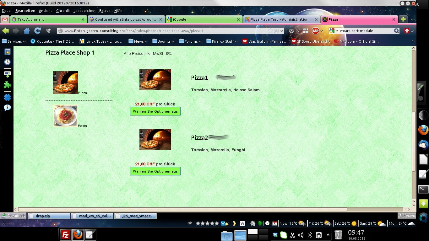

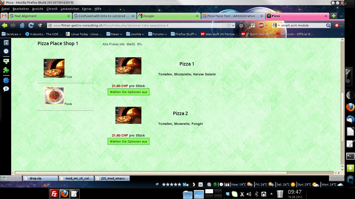

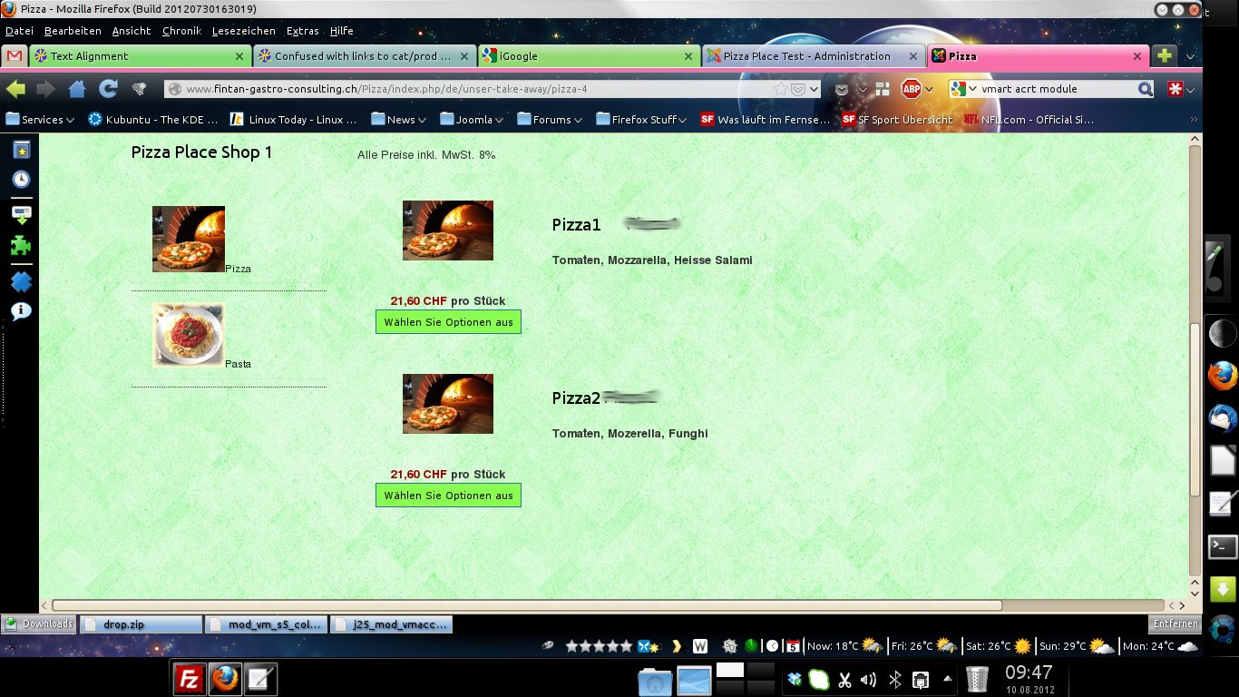

13 years 11 months ago #60334
I can see that you changed your products listing page so that it uses another item box layout. So I don't think that you want to have the product name centered on the left anymore with this one.
Thanks for getting back to me so soon.
The product detail page is good noe.
When I click on the product category I get this:Prod_List1.jpeg
I would like it to look like this:Prod_List2.jpeg
What do I need to edit?
