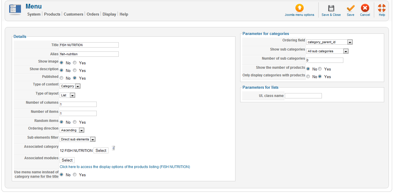

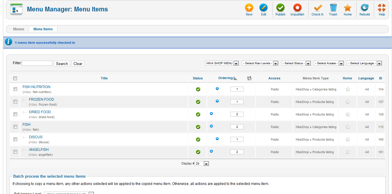

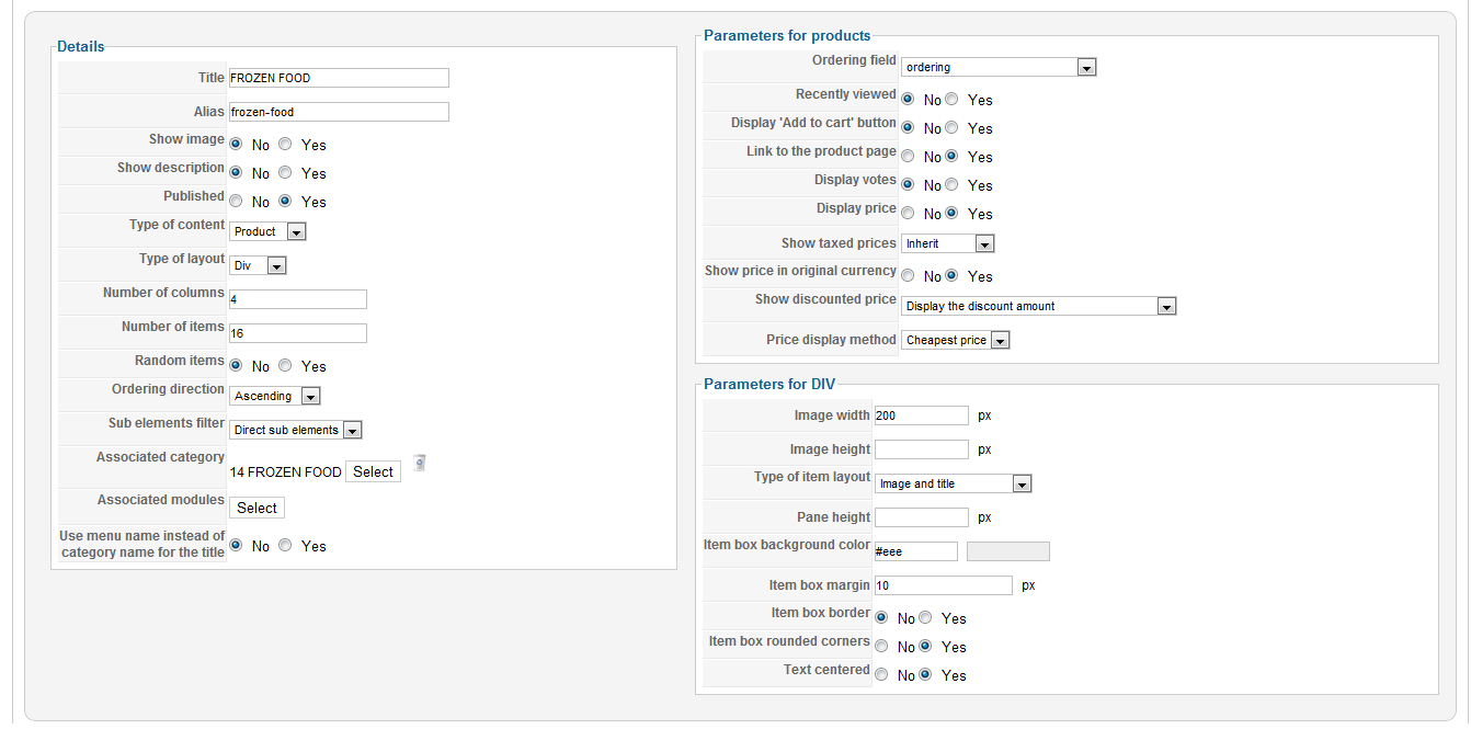

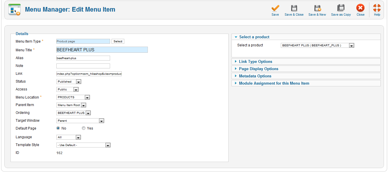

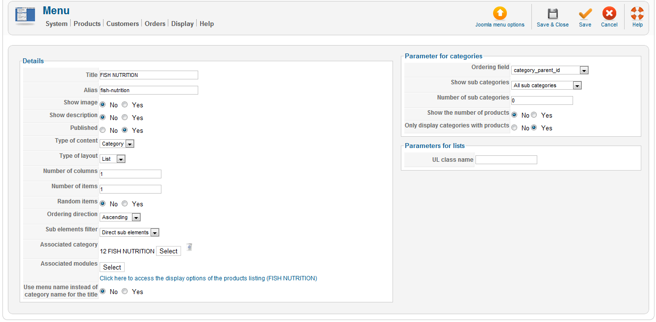

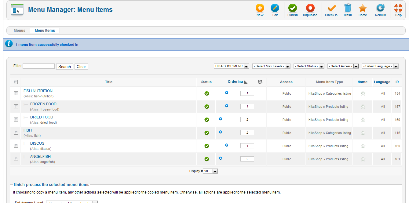

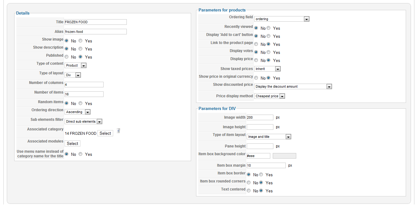

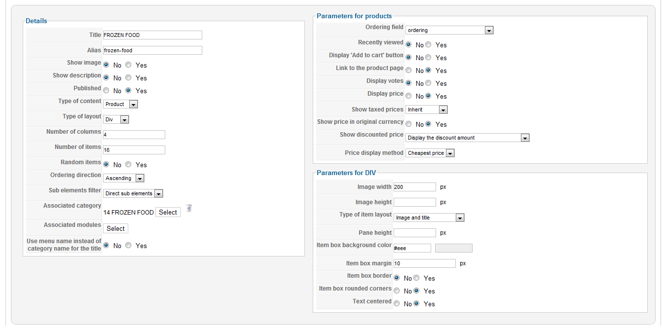

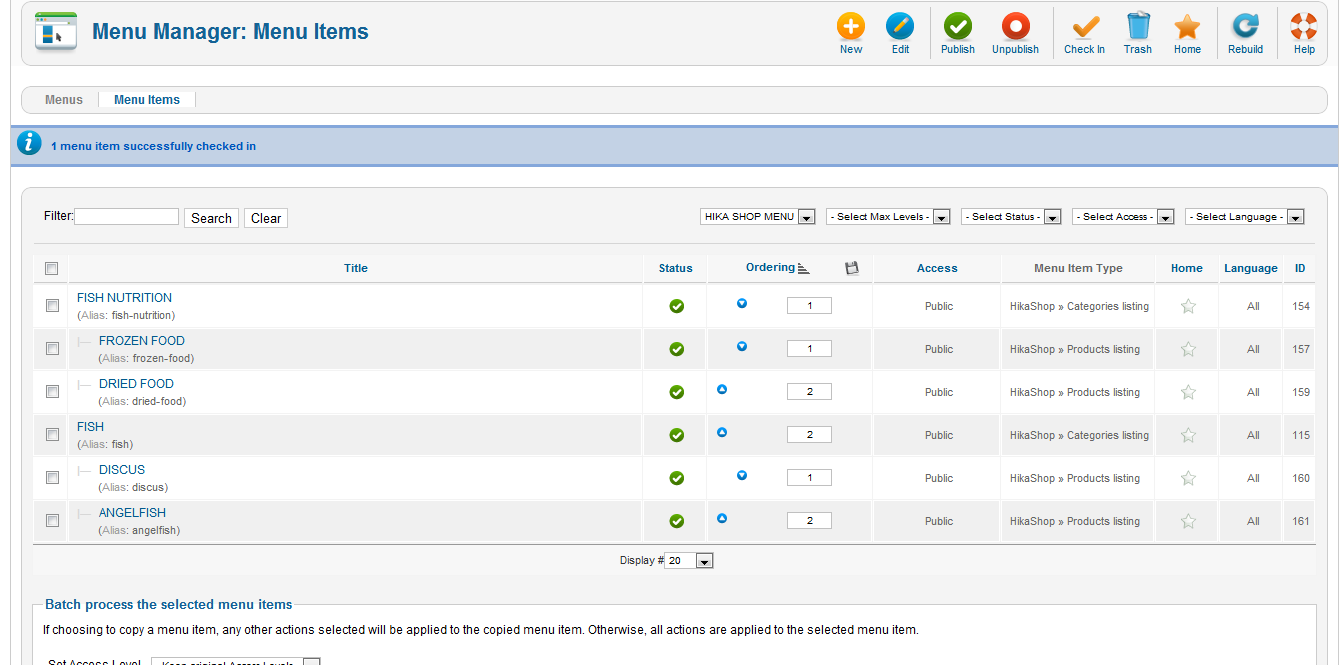

  • Posts: 3
13 years 11 months ago #60414
Hello Nicolas,
I am trying to do the same thing. I wanted to have main categories in the shop's left sidebar and when I click on it 2 or more sub categories would appear. I succeed in that part but, the subcategories even if they are linked to the hikashop content module they don't show anything (maybe because the address link is different)...
Also the product details don't appear if I click on them... :S
Do you have any suggestions???
my webpage is: discusking.w3webster.com/index.php/shop
Last edit: 13 years 11 months ago by parmas.
  • Posts: 85950
  • Thank you received: 14139
13 years 11 months ago #60474
How did you created these links?
Could you do some screenshots of the options ?
  • Posts: 3
13 years 11 months ago #60493
  • Posts: 85950
13 years 11 months ago #60586
You settings are fine.
It must be some kind of conflict with the SEF system. I suppose that if you turn off the SEF options in the configuration of Joomla, it will work.
