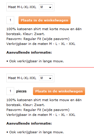

If someone select a product and changes the size (X - Xl - XXl) than I sea the + & - again. They are removed by css, butt when you select another size they appear? What am I doing wrong.
Also I can not find the file to change the layout. I want to completly remove the + and - and putt some text their (piece). So it says "1" "piece" - "place in basket".
I'll keep on trying!

O.k. Clear. Removed the CSS and changed settings. That worked. However what I want is tis, see image:
Si now there is (translated) 1 - putt in bastket.
Butt I want to add a word 'pieces" (stuks) so I get
1 - pieces - putt in basket
I can't find the file(s) to edit.

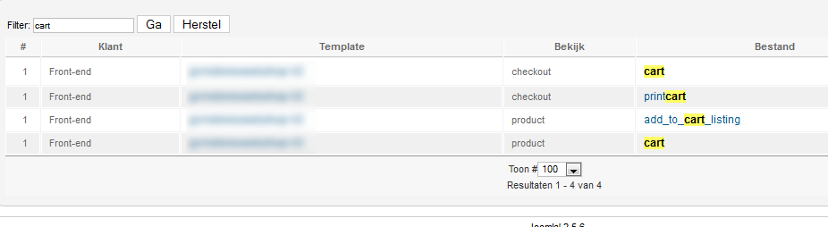

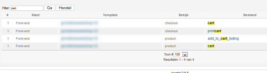

13 years 11 months ago #60568
I thought I had to change one of the files (see image) but it is more complex apparently. That's a shame because client insist on the change. I thought I could change the TR in the file and add the text PIECES.

13 years 11 months ago #60605
The file administrator/components/com_hikashop/helper/cart.php is a core file, not a view file. You need to edit it via FTP.
