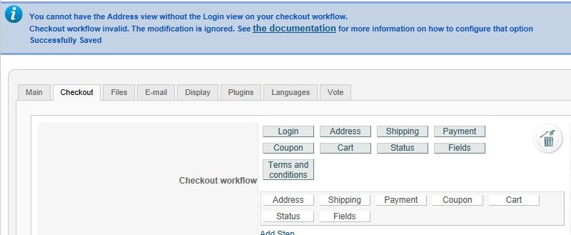

Very new to Hikashop - using Starter version 1.5.8 and Joomla 2.5.6. I am getting the error "You cannot have the Address view without the Login view on your checkout workflow" which I'm afraid I don't understand. I've tried reading the documentation and I still don't understand why the problem is occurring.
My workflow is as shown in the attachment - login address shipping payment coupon cart status fields terms&conditions - so I don't understand why the error is occurring?

On your screenshot, the Login view is not in the step. You need to drag n drop it from the area at the top to the area below and then save the configuration.

Thank you so much! I was so confused into thinking the TOP area was the actual workflow because you've changed the design a bit since the docs were written. Thank you once again!!
