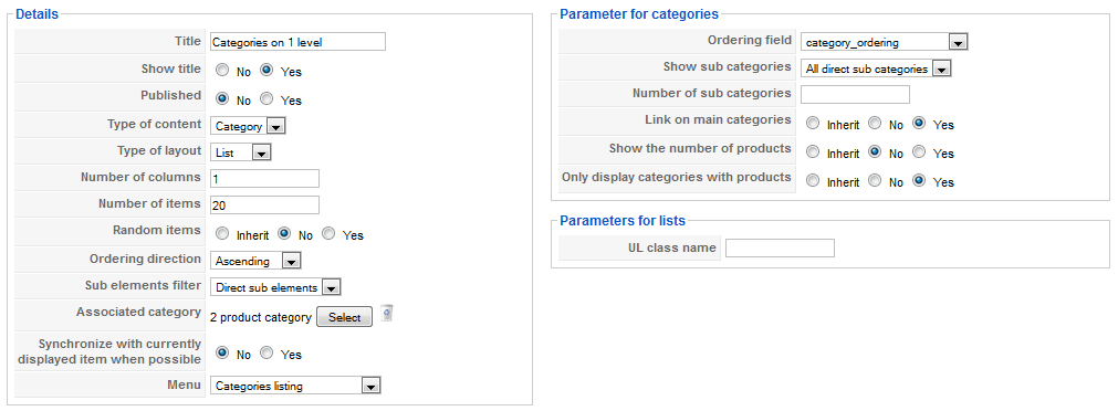

and after click (for example on cat. B2) will be displayed
---product B2.1
---product B2.2
When I tried it, associated category I'm setting on parent category of category who must be displayed (in this example - cat. B ) and published it.

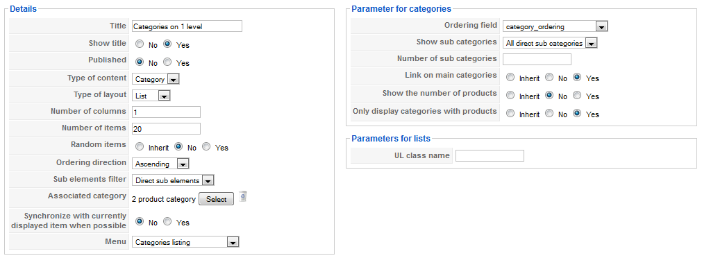

  • Posts: 85950
  • Thank you received: 14139
13 years 11 months ago #60800
In the "menu" option of the hikashop options of your modules, you need to select a hikashop category listing menu item.
Then it will work.

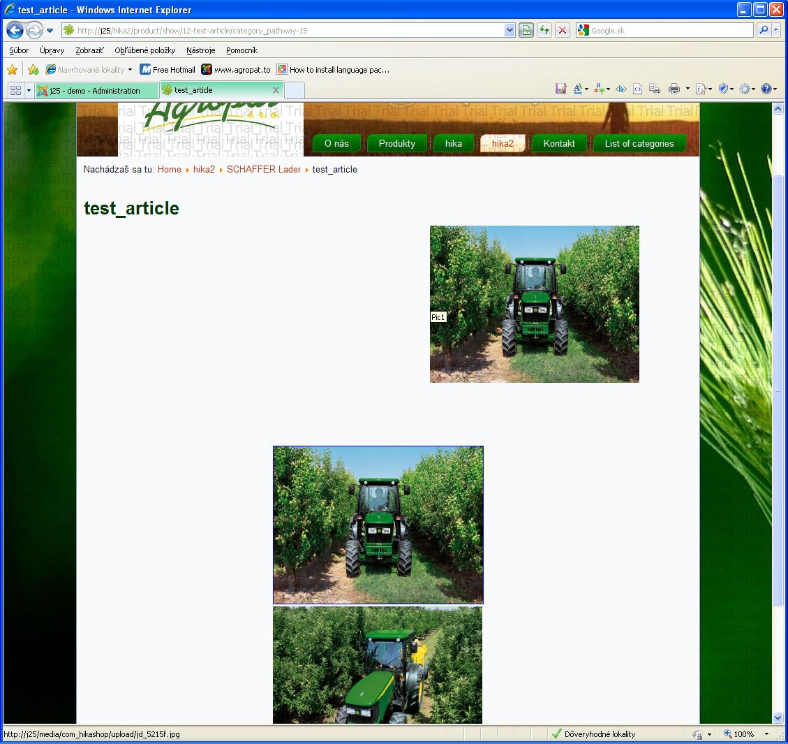

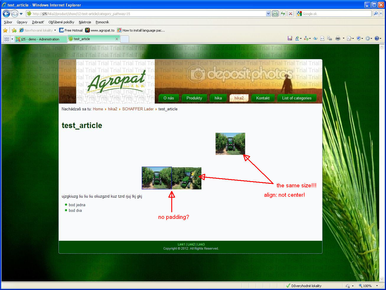

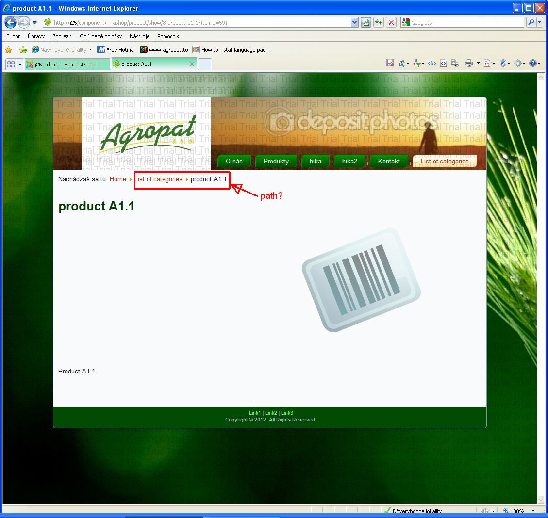

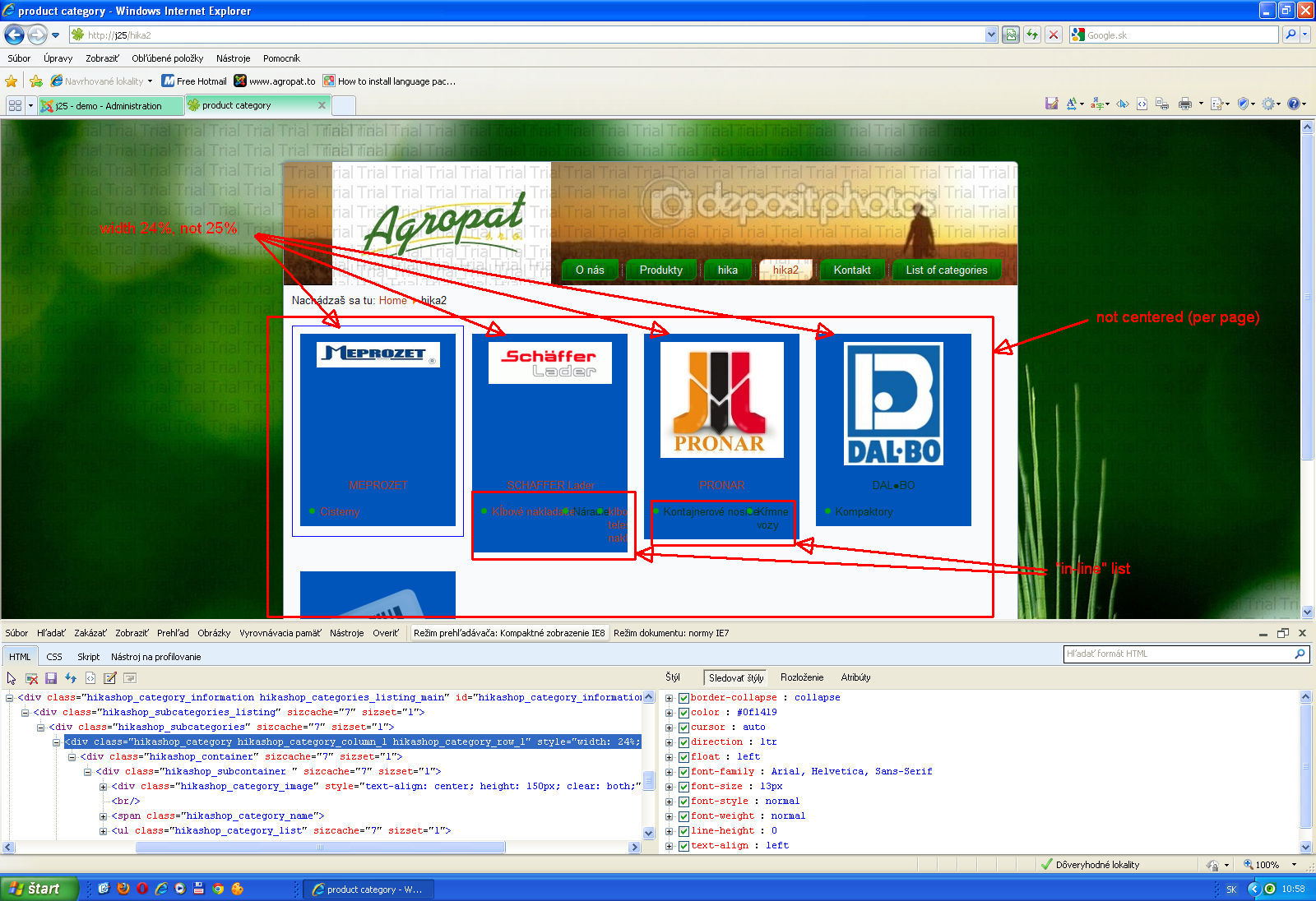

  • Posts: 17
13 years 11 months ago #60841

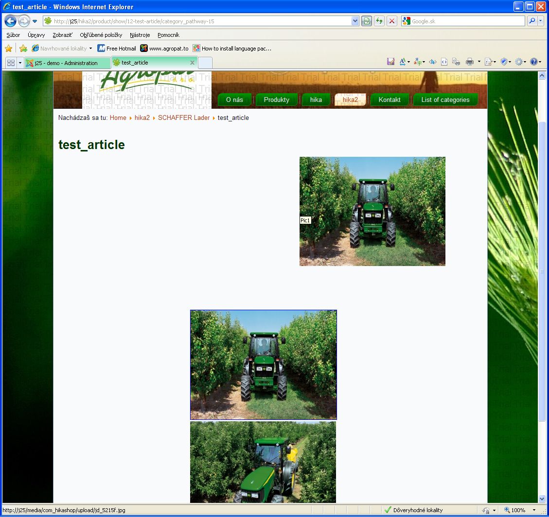

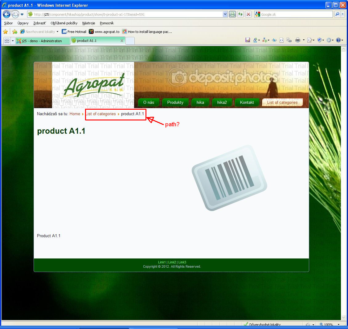

It's work, but problem is with Breadcrumbs on the product page: there is no menu_item > Category A > Category A1 > Product A1.1 but only menu_item > Product A1.1 (pic.0).
Another problems who I'm discovered:

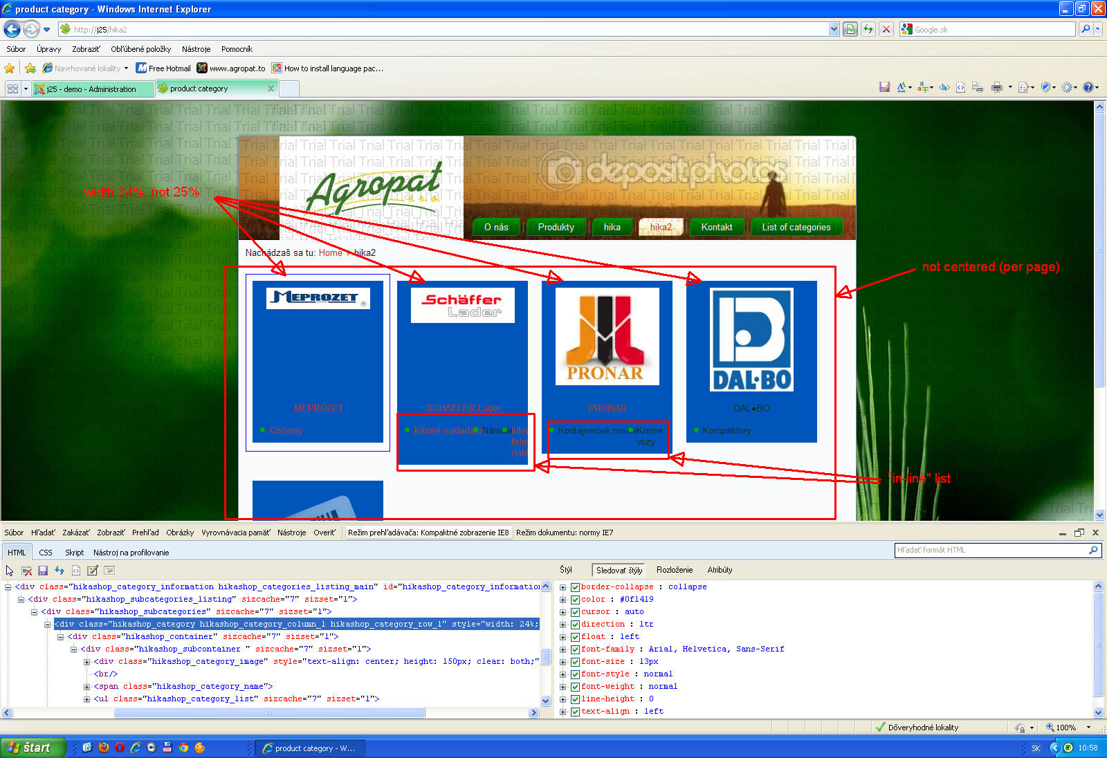

1. When I have on page eg. 4 category lists (div style) side-by-side, then width of them is not 25%, but only 24% and this "list" is not centered (pic.1) (I need to be centered). So, category list is "in-line" no 1 category per line.

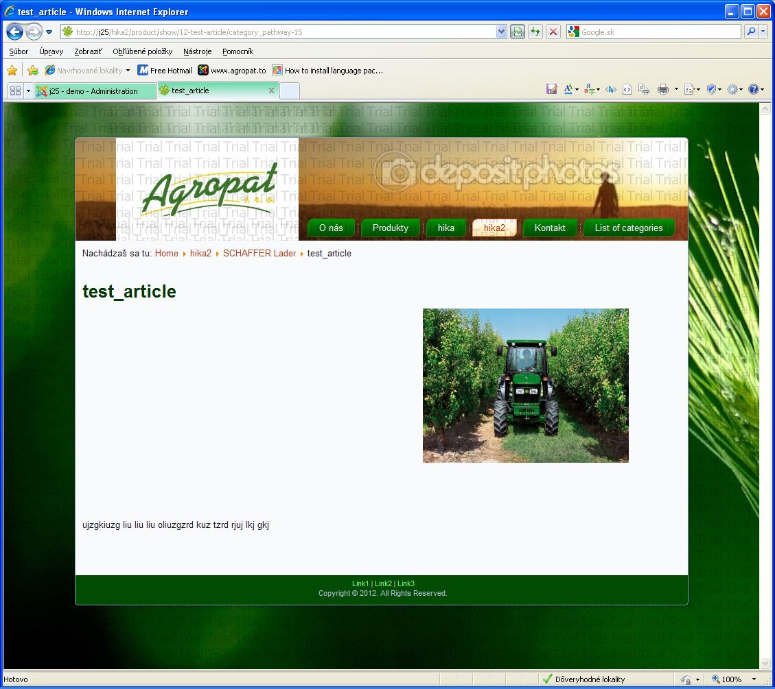

2. Images on product page - main picture is not centered (pic.2);

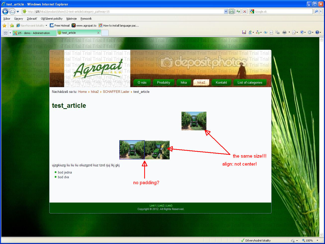

3. When is more pictures in product page, thumbnails are big (pic3).
I'm sorry, My English is not very well, but I hope that You will be understand to me.
13 years 11 months ago #60875
Hi Fox A,
You can edit the frontend css file in HikaShop > Configuration > Display tab.
To adapt HikaShop to you template, you can edit the css properties using Firebug for example to find which class has to be changed.
You can find some documentation in our FAQ:
http://www.hikashop.com/en/support/documentation/faq.html#css
How do you add the pictures in your product page ? Via the image field on the right side or in the description of the product ?
You need to do it in the image field.

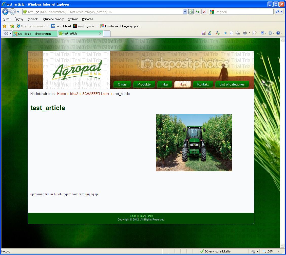

  • Posts: 17
13 years 11 months ago #60886
Preview of product picture has the same size as thumbnails? - pic.4. When change thumbnails size, size of preview of product picture is changed too.
Why it is not in center - how can I change it?
Thumbnails has no paddings?
I tried it with Breeze2 and Breeze5 templates too, but with the same result (I think, that is not problem with my template).
  • Posts: 85950
13 years 11 months ago #61005
1. The breadcrumb path is simplified. Please change the "simplified breacrumb" option of the configuration of HikaShop and you will get it like you want.
2. The percentage is 100% divided by the number of columns minus 1%. That is necessary so that it works properly on some versions of IE. If you want it to be centered, you will have to add some left padding in CSS as xavier explained.
3. The product image is not centered. By default, it's displayed on the left. You apparently changed the product page layout option from "default" to "reverse" and thus you get the image on the right.
If you want it on the center, you will also have to add some CSS for that.
4. The size of the main image is dictacted by the options product page image width/height on the Files tab of the configuration.
For the mini thumbnails below, it is based on CSS:
www.hikashop.com/en/support/documentatio...ling.html#thumbnails
Your screenshot indicates that there is a CSS issue on your page.
For points 2 , 3 and 4, we won't be able to give you the precise CSS to use unless you give a link to the pages as the CSS to use will depend on the CSS of your template and other CSS loaded on your website.
  • Posts: 17
13 years 11 months ago #61020
1. I have "simplified breacrumb" option as No. It's make only when the product page is viewing from module from Joomla article page, where is list of category. (Joomla article with category list from Hikashop (correct breadcrumb) -> category (correct breadcrumb) -> product list (correct breadcrumb) -> product page (simplified breadcrumb).)
