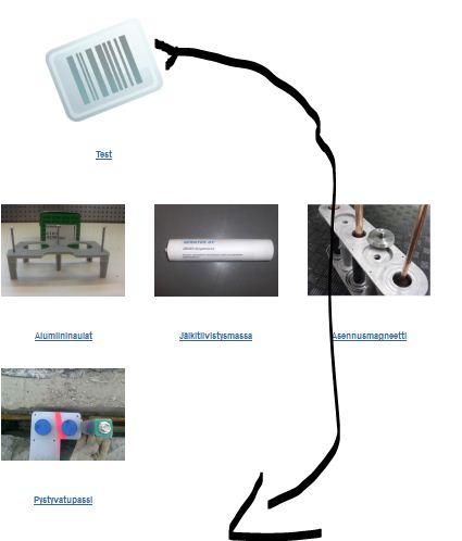

I'm trying to find how to display child category(s) after products listing of curent-category.
Default seems to be "before".
I include screen clip about this.
There:
Test is child category, others are produts in category selected by menu entry.
Test category shold be dispalyed here
Hannu
Last edit: 13 years 10 months ago by hannuvirta.
13 years 10 months ago #60999
I think that you'll have to Go to "Hikashop->Display->Views" and Edit the code of the "listing" file of the "category" view of your front-end template.
Last edit: 13 years 10 months ago by Mohamed Thelji.
  • Posts: 14
13 years 10 months ago #61000
I was thinking that too.
But I have zero experience of php coding. It is totally out of my skills.
Can you or somebody give any hint how I should change it...?
Hannu
13 years 10 months ago #61002
Ok, I Think that moving the code
$html = $this->loadTemplate($layout_type);
if(!empty($html)) echo '<div class="hikashop_subcategories_listing">'.$html.'</div>';
At the end of your file will help.
  • Posts: 85883
  • Thank you received: 14120
13 years 10 months ago #61003
Note that you will need to add that just before the ?> tag at the end.
  • Posts: 14
13 years 10 months ago #61018
Mohamed Thelji wrote: Ok, I Think that moving the code
Yes. That did it.
  • Posts: 29
11 years 4 months ago #191155
It seems your advice is not valid for actual HikaShop version...
Would you be so kind to provide advice for current HikaShop version, please ?
11 years 4 months ago #191175
That code must still be working, are you sure that you are doing the modifications in the correct file of the correct template ?
  • Posts: 29
11 years 4 months ago #191247
Your navigation "Hikashop->Display->Views" and Edit the code of the "listing" file of the "category" is precise.
So I was looking in the correct file.
But sorry - you're right - Yesterday I didn't see it, today I see it ....probably too much work :S
Sorry agian - everything is OK - Thank you.
