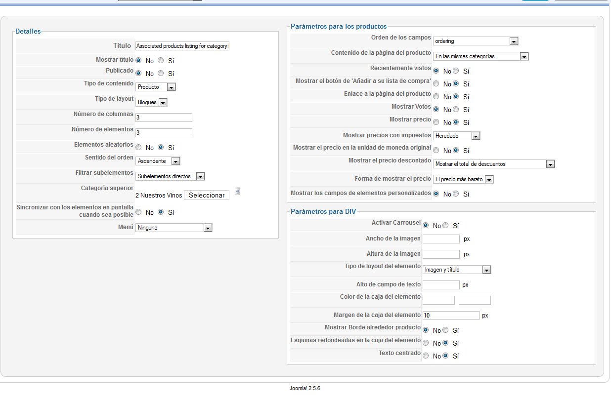

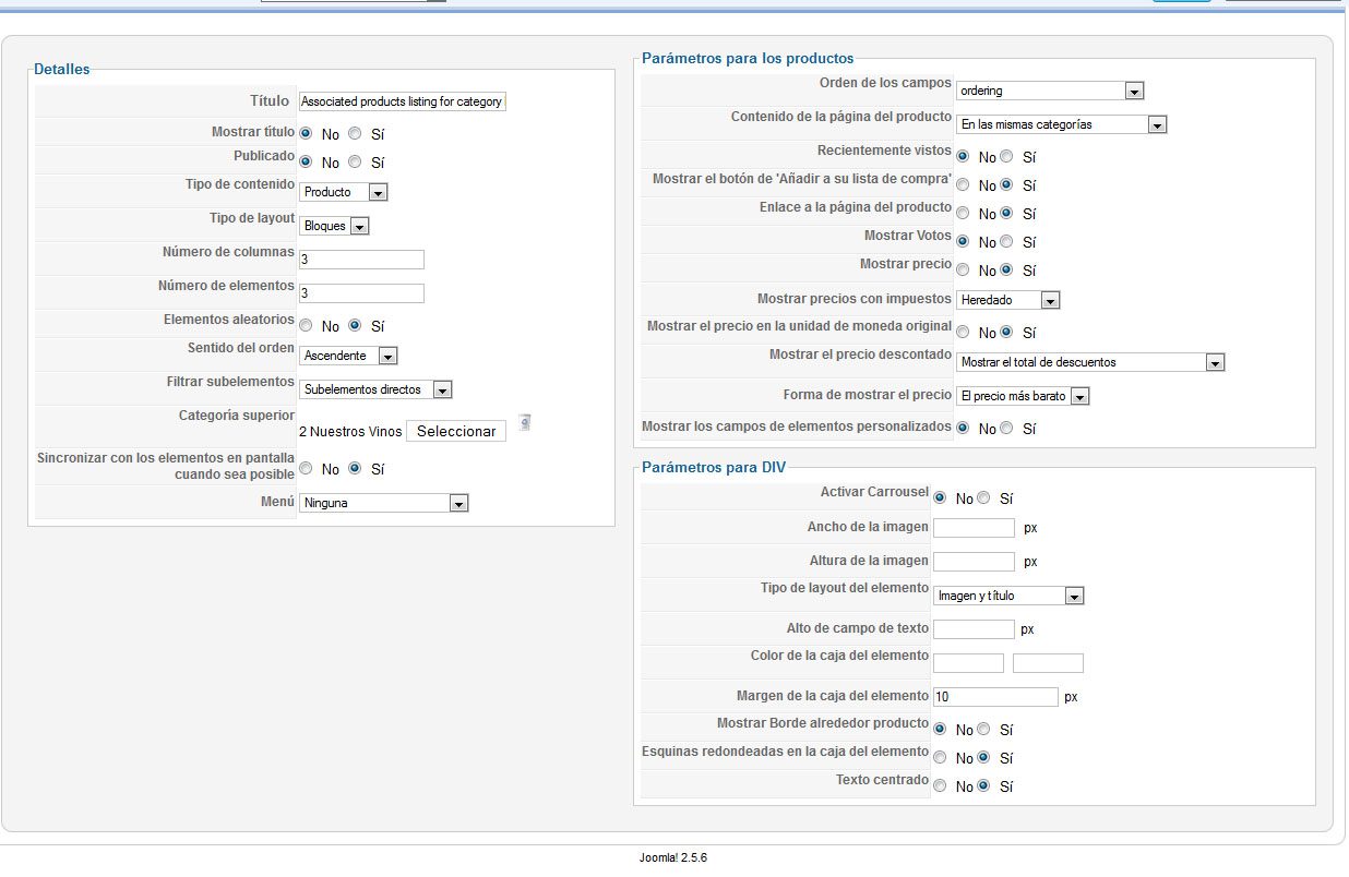

13 years 10 months ago #63162
that was already set, screen follows
  • Posts: 85949
  • Thank you received: 14137
13 years 10 months ago #63381
That module is set to display only the products directly attached to the current category. So either you're not looking at the correct module or you have products directly under the main product category.
