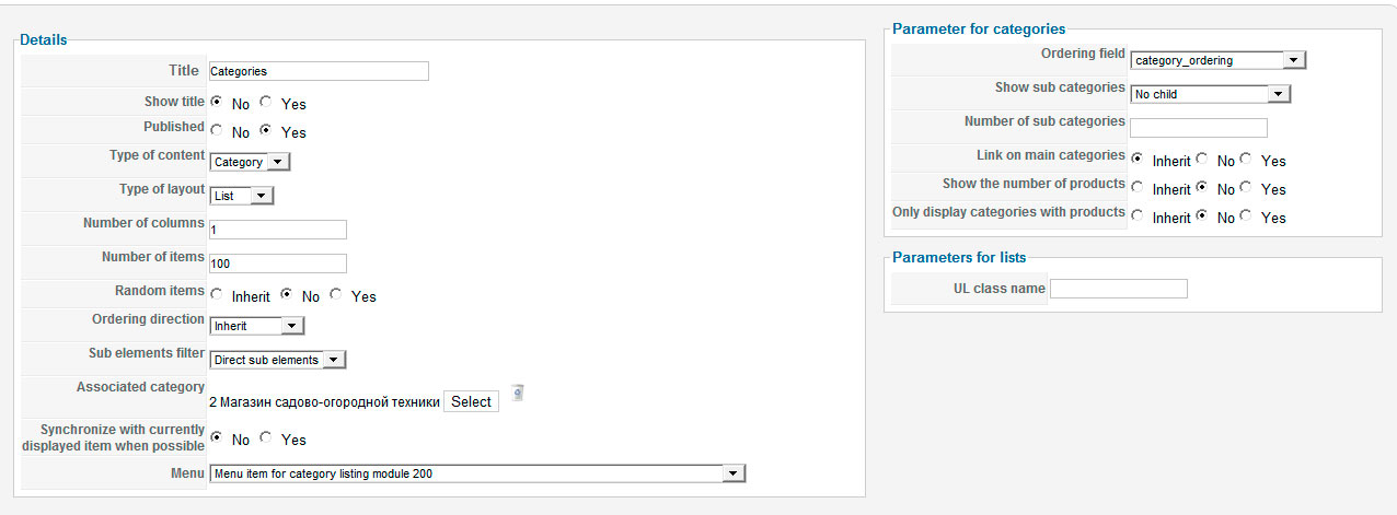

I have setup my HikaShop under one of Joomla's menues called shop and located in the folder shop:
www.mywebsite.com/shop/
I have set up a category list module and published it on several pages.
The module successfully listed all the categories. However, the links to thos categories are wrong!
For example, one of links points to path "/category/12-motobloki-i-motokultivatory". The correct path however is: "/shop/category/12-motobloki-i-motokultivatory".
Would you kindly suggest how can I add the root folder in front of the path to make it correct?
The settings of my module are:

  • Posts: 85949
  • Thank you received: 14139
13 years 10 months ago #62234
You simply need to select your "shop" menu item in the "menu" option of the hikashop options screen of your module in order to do that.
  • Posts: 120
13 years 10 months ago #62275
That really works! Thanks a lot for the support. I was not attentive enough, though I spent lot of time searching for solution of this issue.
